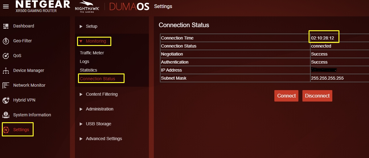

xlr8r Posted December 13, 2019 Posted December 13, 2019 stay on top of watching your logs every few hours though, as they only stay visible on the router for around a day ... if you miss it in the logs you can always look at ; Connection Time, from that , you can deduce when it last disconnected from Internet the Time shown is in DD:HH:MM:SS
