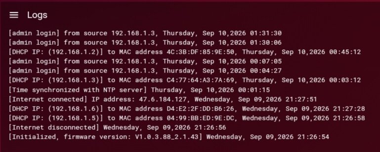

  1. Update; I have noticed system logs that I haven't seen before. In these new logs, it's showing internet connected/disconnected and multiple instances of firmware initialized and strange dates while lacking the typical logs that I would normally see when making setting changes.
  2. Thank you for the quick reply. I have screenshotted the system logs I believe you were asking for. This is all that it contains despite numerous QoS changes. The modem the XR1000 is connected to is a Spectrum-issued Ubee EU2251. It doesn't have it's own router functions. The speeds seen in Connection Benchmark and third party speed tests show completely erratic low speeds. At 80% CC with 940mbps download and 40mbps upload, it should be 752mbps download and 32mbps upload respectively. It is all over the place in the low multi-hundreds for download and low teens for upload. Previously, if CC acted erratically, I could fix it by reboot or power cycle. Currently, I am able to replicate an all device connection drop just by unchecking "Disable QoS" and again by enabling "Always" in CC. After these changes, the connection will eventually return, but the frequency of further random drops increases. This has never happened before on any previous firmware. All devices hold an active connection to the router. Device Manager has no ghost devices or offline devices. Even when a device was offline in the Device Manager page, QoS has never behaved like this on the previous firmware. Forgive me for any misinterpretation. I have never had an issue of this scale in the 2-3 years I have owned this router.
