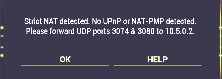

Administrators Netduma Fraser Posted May 24 Administrators Posted May 24 What is the model of the modem/router the R2 is connected to and how have you set that to ensure all traffic flows to the R2? E.g R2 in its DMZ, modem/bridge mode Have you done any port forwarding on the R2 or used the DMZ? What platform are you playing on? Are you using the Geo-Filter? Do you get an Open NAT with it disabled?
Joey1973 Posted May 24 Author Posted May 24 6 minutes ago, Netduma Fraser said: What is the model of the modem/router the R2 is connected to and how have you set that to ensure all traffic flows to the R2? E.g R2 in its DMZ, modem/bridge mode Have you done any port forwarding on the R2 or used the DMZ? What platform are you playing on? Are you using the Geo-Filter? Do you get an Open NAT with it disabled? Hi thanks for replying, When ever i try to do anything in the settings. It will say " Pardon out mess " And it all ways makes me press retry. And i do not have any geo filter on. And i am on computer.
Administrators Netduma Fraser Posted May 24 Administrators Posted May 24 If your Internet Service Provider (ISP) router gives you WiFi then you need to put the R2 WAN IP - found in the WAN Settings page on the R2 into the DMZ function on your ISP router. If you didn't do a factory reset after upgrading to the DumaOS 4 Early Access firmware then please do so and it will behave better after that. Do this first then the DMZ.
Joey1973 Posted May 24 Author Posted May 24 1 hour ago, Netduma Fraser said: If your Internet Service Provider (ISP) router gives you WiFi then you need to put the R2 WAN IP - found in the WAN Settings page on the R2 into the DMZ function on your ISP router. If you didn't do a factory reset after upgrading to the DumaOS 4 Early Access firmware then please do so and it will behave better after that. Do this first then the DMZ. Hey thank you! That solved the issue nat type is now fixed! Netduma Fraser 1
