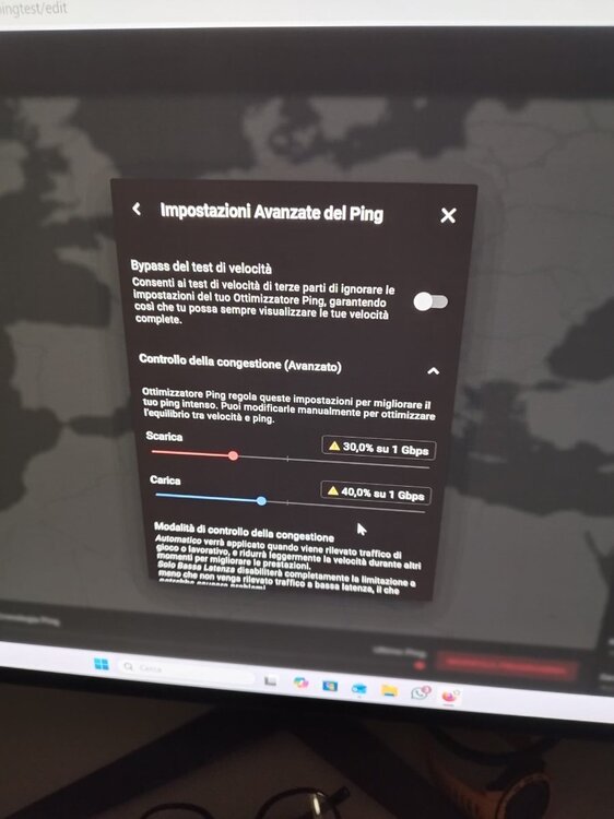

Good morning,
I have a Netduma R3 with beta firmware 4.0.1147.
Everything is working as it should.
I just have a question/concern.
I have a 2.5/1 Gbps base connection, and I know the Netduma is 1/1 Gbps.

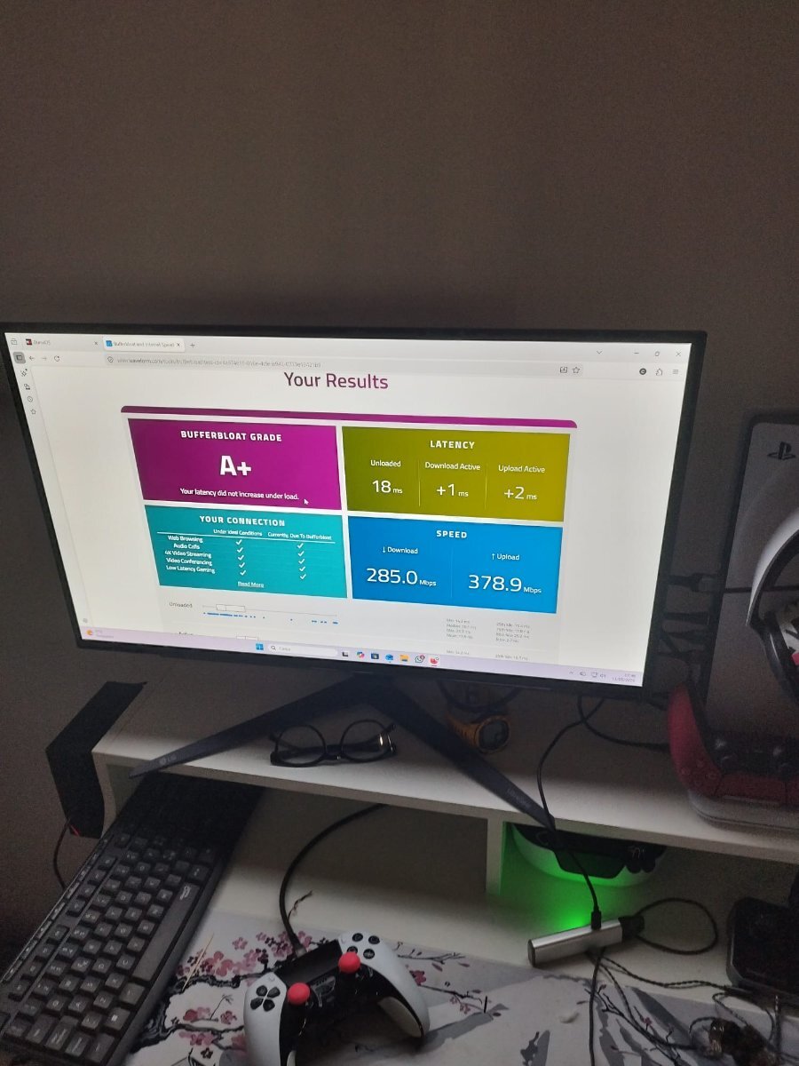

But to get A+ bufferbloat, I have to throttle the network to 30% download and 40% upload.
Obviously, this affects the entire home network.
Is there a solution for this??

I wouldn't put so much value on the bufferbloat test and getting those values - bufferbloat only occurs when the network is saturated which can't happen when Congestion Control has been lowered. That being said, I assume you were trying in multiples of 10 from 100? Go in multiples of 10 from 95% instead and you may get better results with higher values.
