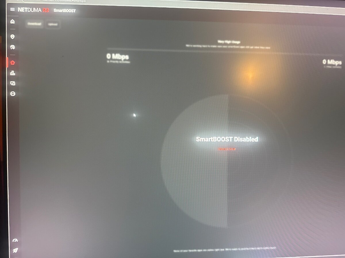

Ceez Posted 11 hours ago Posted 11 hours ago My netduma r3 was working fine up until a month ago I started getting packet loss. I ran a ping plotter test to 8.8.8.8 and all hops are from 12%-20% packet loss. My modem from isp is on bridge mode. If I connect from my isp modem straight to pc I get 0 packet loss on all hops. I factory reset my netduma r3 turned on and off smart boost I tried everything I get packet loss if I use it. What is causing this issue???

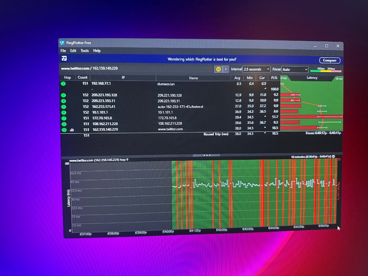

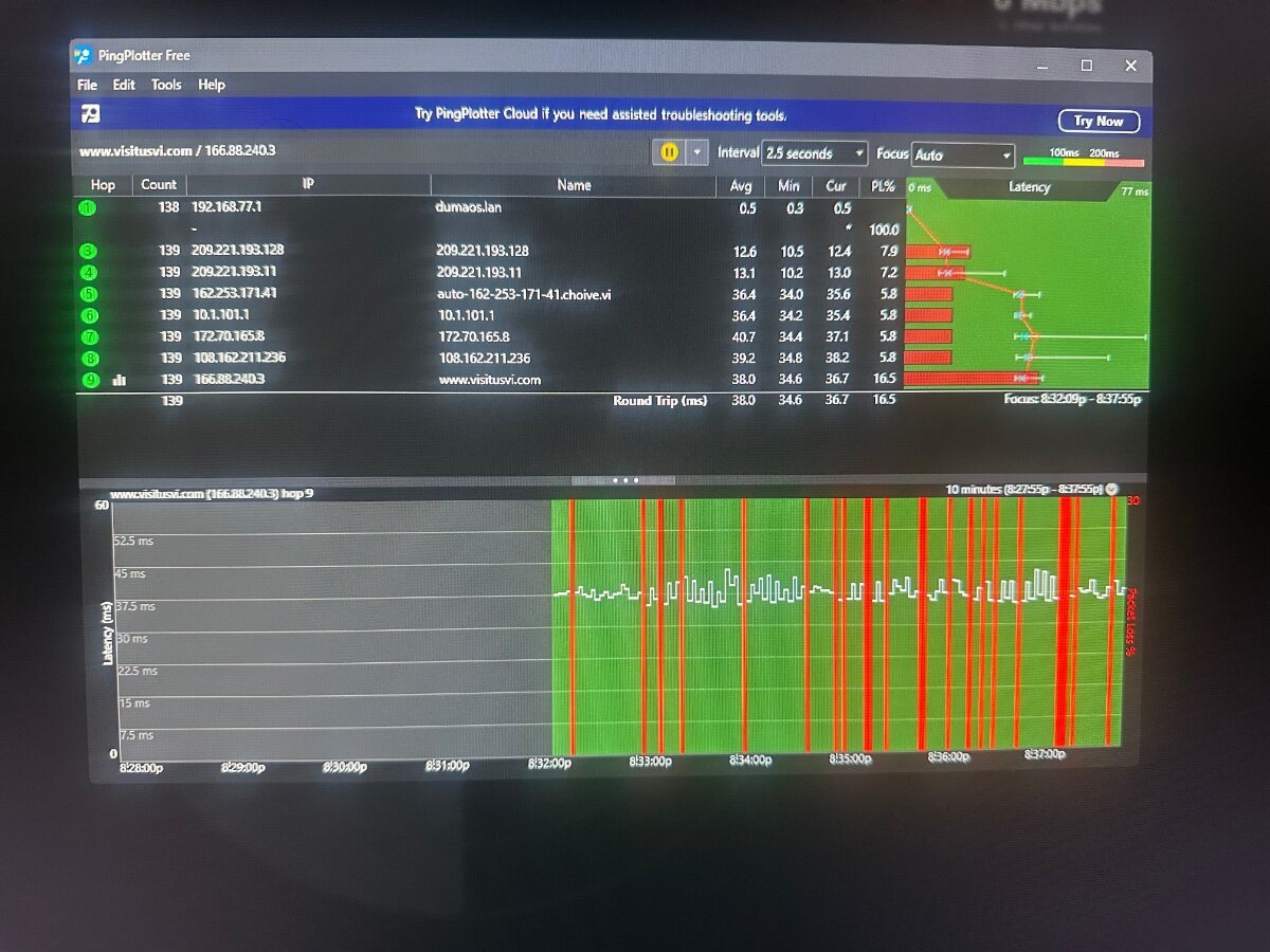

Administrators Netduma Fraser Posted 1 hour ago Administrators Posted 1 hour ago Use a local website rather than google e.g. a news site and with the 2.5 interval what do you get? Can you post a 10 minute plot of that please?

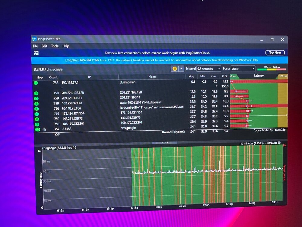

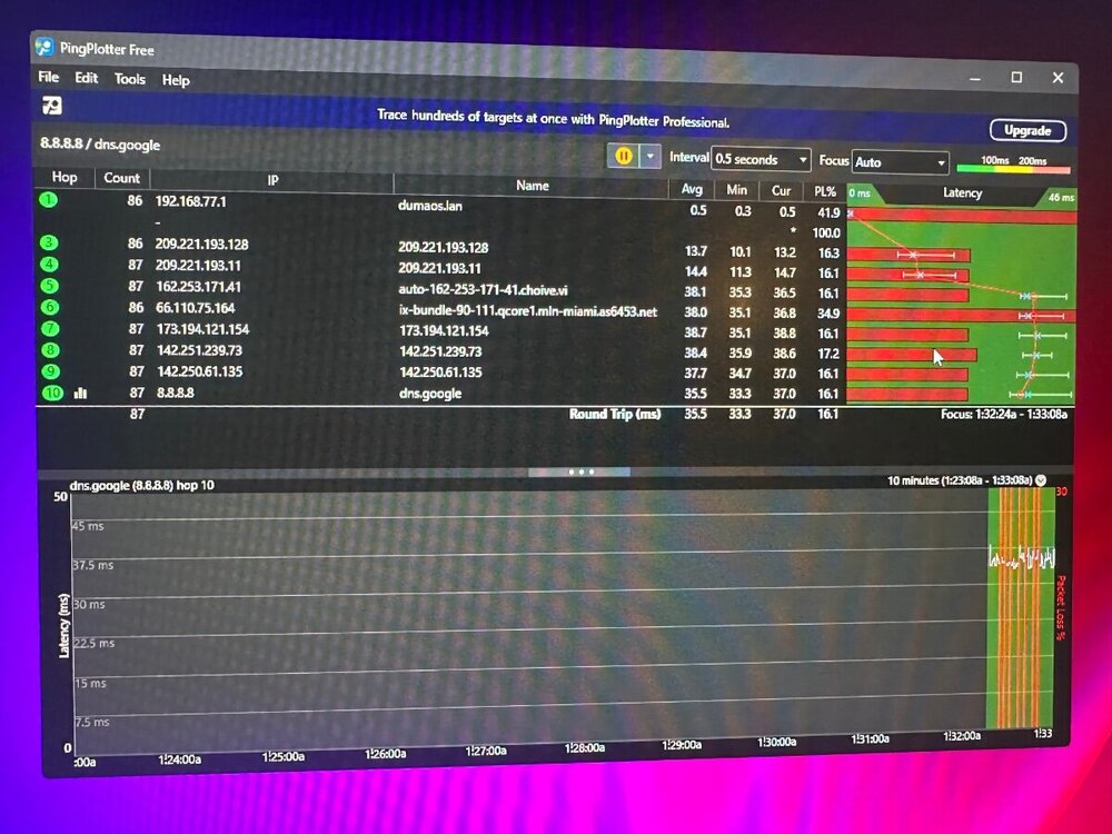

Ceez Posted 2 minutes ago Author Posted 2 minutes ago I tried 1.1.1.1 still has packet loss I tried ping plotter dns still the same. I’ll post them all in about an hour. The issue is coming from netduma r3 because any other router I use no packet loss
