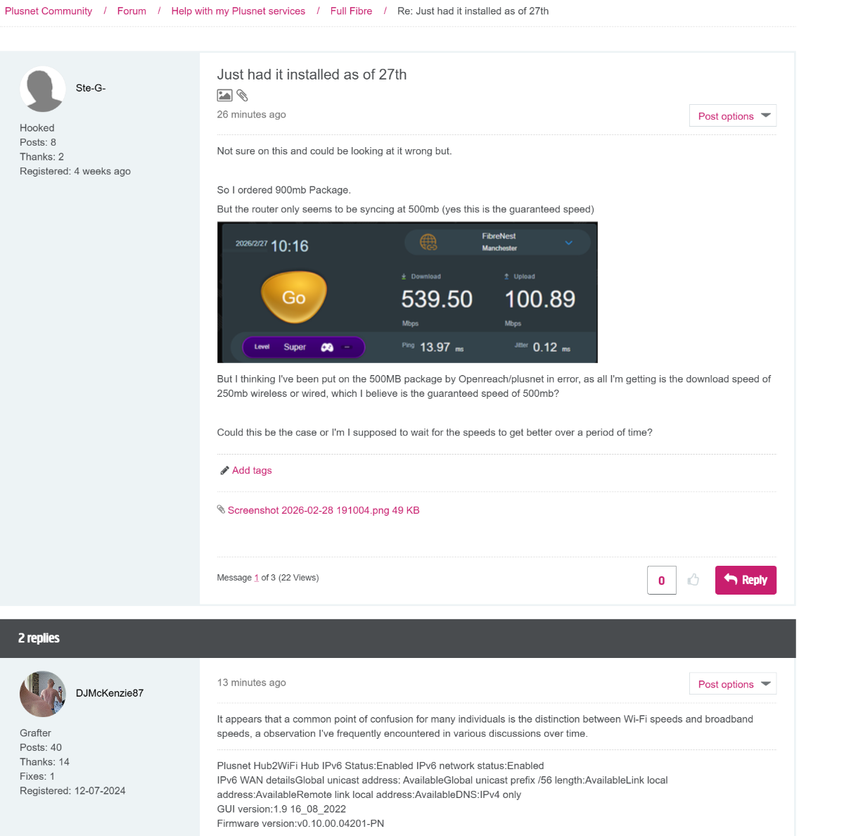

COD WARFARE Posted February 28 Author Posted February 28 So that test was done with in my Asus routers software, so I'm "guessing" the connection is syncing at 500MB, when it should be 900mb, the guaranteed being 500mb. But if I do a speed test via wifi on the ASUS I'm only getting 250mb. I've not got a long cable or any thing like a laptop to get by the router enough to test yet. Kinda thinking I've been put on the wrong profile for what I ordered. So asked the question on plusnet forums and get this as an answer, helpful...
Administrators Netduma Fraser Posted February 28 Administrators Posted February 28 4 minutes ago, COD WARFARE said: So that test was done with in my Asus routers software, so I'm "guessing" the connection is syncing at 500MB, when it should be 900mb, the guaranteed being 500mb. But if I do a speed test via wifi on the ASUS I'm only getting 250mb. I've not got a long cable or any thing like a laptop to get by the router enough to test yet. Kinda thinking I've been put on the wrong profile for what I ordered. So asked the question on plusnet forums and get this as an answer, helpful... Yeah that's a less than useful answer, clearly didn't read it properly. It's possible they didn't update it correctly but also if this is a new upgrade then it can take some time to settle, in which case you may just see the guaranteed speeds for a few days/weeks and then it'll start to improve. Probably best to give them a call to determine exactly what is happening.
