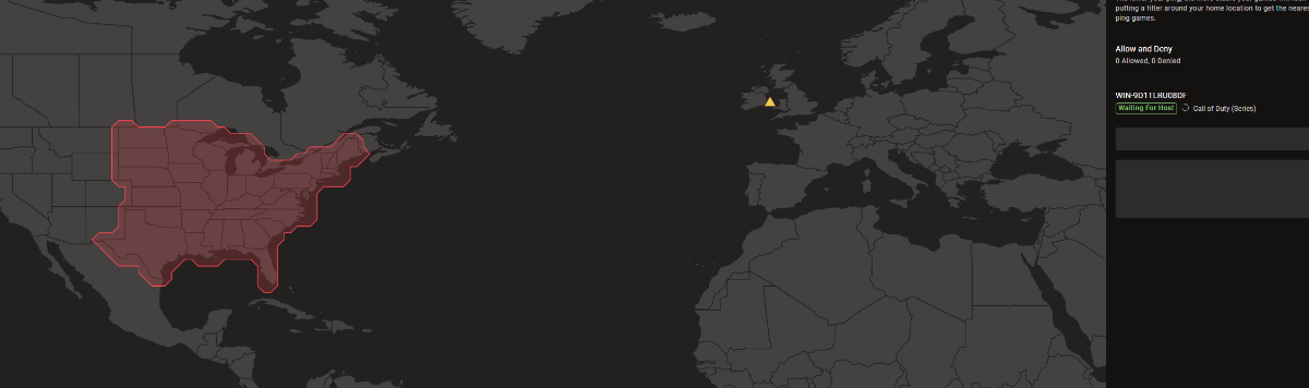

Magyar0124 Posted 6 hours ago Posted 6 hours ago Hey there ! i would like to use my r2 duma geo filter ability i recently updated the firmware to the v4.0.258 so i can use the duma os 4 i live in Hungary and try to connect to USA servers but for some reason when i launch the game try to connect Dublin servers first and can't get pass through the loading screen until i disable the geo but then its gona connect to eu.. i did try to restart router/ unplug it rest my firewalll / reset network None of them worked Can we maybe look into this issue or if its possible i can share my screen etc in a call Thanks for the help
Krush Posted 5 hours ago Posted 5 hours ago Le serveur de Dublin est le serveur d’authentification ! Cliques dessus et autorises le. Tout devrais bien se passer après.😉
Administrators Netduma Fraser Posted 4 hours ago Administrators Posted 4 hours ago As above you'll need to allow that server as it's an authentication server, you can't play without it. There may be a few servers there you'll need to allow. If you could get the IDs we can add them to our whitelist.

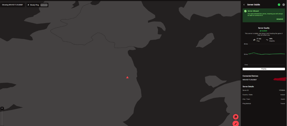

Magyar0124 Posted 3 hours ago Author Posted 3 hours ago A you can see made it allow to join that server still doesn't let me authorize

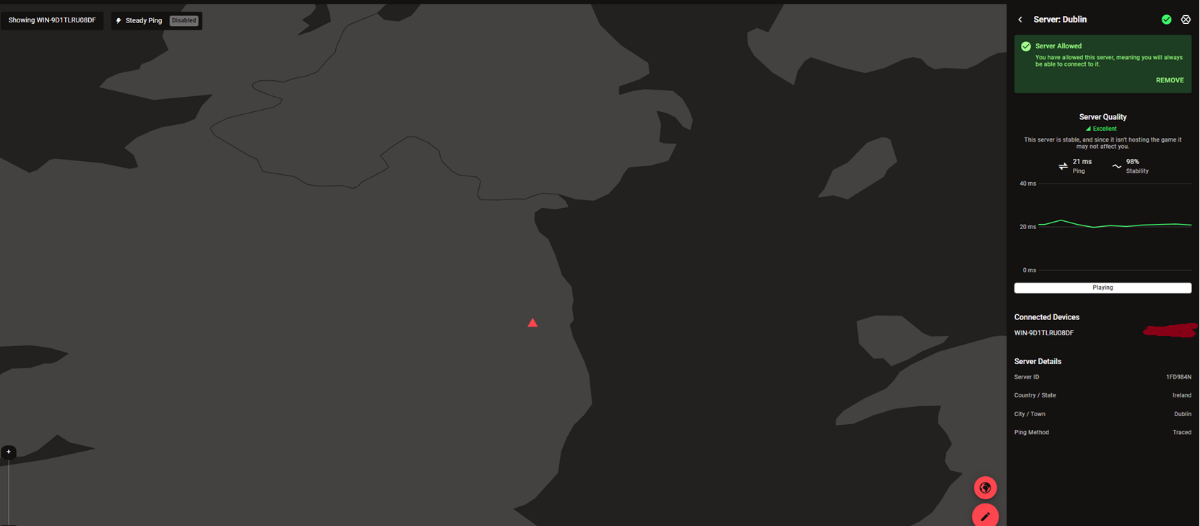

Magyar0124 Posted 3 hours ago Author Posted 3 hours ago A you can see made it allow to join that server still doesn't let 2 minutes ago, Magyar0124 said: A you can see made it allow to join that server still doesn't let me authorize 1FD984N sorry here is the ID of the server
Administrators Netduma Fraser Posted 3 hours ago Administrators Posted 3 hours ago Zoom in fully on that location, there is likely a few that may be overlapping each other. Also restart the game fully to catch any others
Magyar0124 Posted 2 hours ago Author Posted 2 hours ago So i restarted pc and fully zoomed in there was no other servers with yellow triangle and i click this one allowed
Administrators Netduma Fraser Posted 2 hours ago Administrators Posted 2 hours ago Do this: Quit the application/game/client completely - including the game client from the System Tray - important! Remove device from the Geo-Filter If you're on PC then give it the PlayStation Device Type in the Device Manager Resync from the Geo-Filter Map menu Re-add the device to the Geo-Filter Set up the Geo-Filter how you like Wait 2 minutes Boot up application/game/client
Magyar0124 Posted 2 hours ago Author Posted 2 hours ago 11 minutes ago, Netduma Fraser said: Do this: Quit the application/game/client completely - including the game client from the System Tray - important! Remove device from the Geo-Filter If you're on PC then give it the PlayStation Device Type in the Device Manager Resync from the Geo-Filter Map menu Re-add the device to the Geo-Filter Set up the Geo-Filter how you like Wait 2 minutes Boot up application/game/client W worked i think the isue was it was picked up as a pc not as a playstation i thought its been fixed before

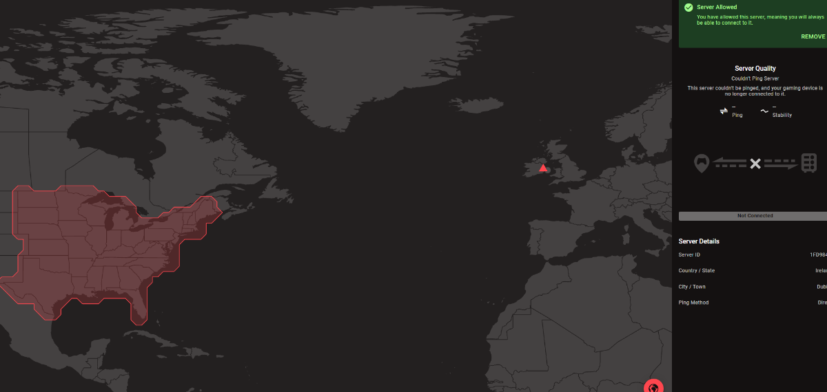

Magyar0124 Posted 2 hours ago Author Posted 2 hours ago 24 minutes ago, Magyar0124 said: W worked i think the isue was it was picked up as a pc not as a playstation i thought its been fixed before nvm soon as i changed location trying to join on the authentication server search for 35 ping ... i did dm you Fraser thanks
Administrators Netduma Fraser Posted 2 hours ago Administrators Posted 2 hours ago So there will still be some more authentication servers you need to allow then, keep allowing them, doing that process and you'll get them all. We don't do that kind of support btw
