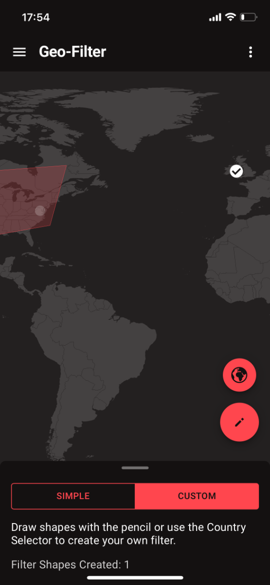

Darrenf111 Posted 4 hours ago Author Posted 4 hours ago No it’s trying to connect me to servers outside my polygon even tho there not in my radius so therefore it’s not finding a lobby in my area I think this is the issue
Darrenf111 Posted 4 hours ago Author Posted 4 hours ago See it’s trying to connect to Dublin even tho the polygon is on NA
Administrators Netduma Fraser Posted 4 hours ago Administrators Posted 4 hours ago Disable Geo-Latency in Geo-Filter settings but also that is an authentication server required for online play - you can't play without it
Darrenf111 Posted 3 hours ago Author Posted 3 hours ago It still don’t work it’s bugging I dunno how to fix it my friend has the exact same settings and his works
Administrators Netduma Fraser Posted 3 hours ago Administrators Posted 3 hours ago Your screenshot looks like it is working, there is an allowed icon within your radius so it's not actively blocking you, the game just doesn't want to place you in a game there for some reason. If you can't get servers in your own area either then there may be servers that need to be allowed - like the one in Ireland. Do you get a game easily in your area with the Geo-Filter disabled?
