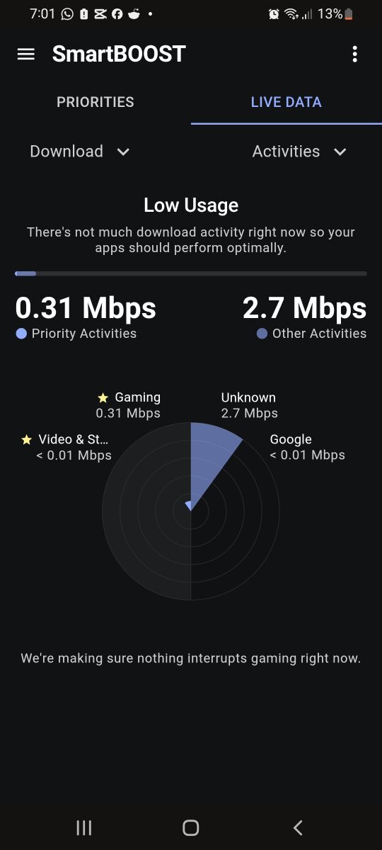

ExcellentZERO Posted February 6 Author Posted February 6 On 2/5/2026 at 5:30 PM, Netduma Fraser said: Did you put the R3 in its DMZ and set that IP as static on the modem? Also ensuring ALL devices are connected to the R3? No I can't use the ISP router as it does not want to connect to the internet anymore. yes all devices are connected also how long does these "unknown" tests run?
Administrators Netduma Fraser Posted February 6 Administrators Posted February 6 18 minutes ago, ExcellentZERO said: No I can't use the ISP router as it does not want to connect to the internet anymore. yes all devices are connected also how long does these "unknown" tests run? I would say that could well be linked to the issue you're experiencing currently, if their own router is unable to connect to the internet then there may be some weird instability that needs to be resolved first. It could also be they're expecting to see the ISP router on the network but aren't, in some cases setting the router to use the ISP router MAC address may help. What do you mean unknown tests? That'll be some traffic we either haven't classified or traffic where the classification has become out of date.
ExcellentZERO Posted February 6 Author Posted February 6 20 minutes ago, Netduma Fraser said: I would say that could well be linked to the issue you're experiencing currently, if their own router is unable to connect to the internet then there may be some weird instability that needs to be resolved first. It could also be they're expecting to see the ISP router on the network but aren't, in some cases setting the router to use the ISP router MAC address may help. What do you mean unknown tests? That'll be some traffic we either haven't classified or traffic where the classification has become out of date. I have reached out these couple of days with my ISP because they say there is nothing wrong on their end, that everything is running fine on their end and that my connection to theirs servers are completely fine and my connection should not be experiencing these issues. okay thank you for clearing that up. At this point I feel like doing a roll back on this update and go back to an older version and see if that clears up everything.
