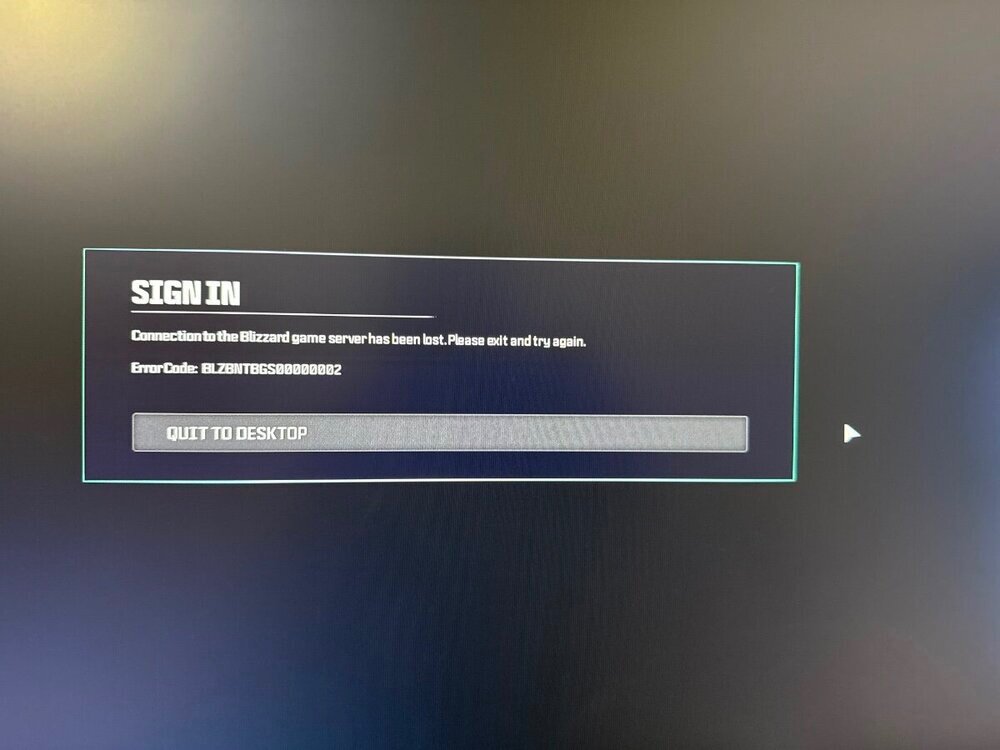

18RayF Posted January 27 Posted January 27 Hi I’m still getting the issue of being disconnected from Battlenet when trying to launch Call of duty despite turning off BI still doesn’t work . I have done the following for troubleshooting and used AI to just summarise what happened . I’m escalating an intermittent connectivity issue that appears to be related to NAT/session handling on the Netduma R3. I’ve done extensive isolation and packet-level troubleshooting and would appreciate engineering review rather than standard support steps. Topology FTTP connection (ONT → Netduma R3 → PC) The R3 is the only NAT device in the path (no modem, no double NAT) Issue Call of Duty / Warzone intermittently fails at “Fetching Online Profile” Error states include “not signed in” or “disconnected” Battle.net launcher login is stable and always succeeds When the failure occurs, restarting the game or Battle.net does not reliably resolve it On rare occasions the profile fetch succeeds, but success is non-deterministic Key observations The issue works 100% of the time when using a mobile hotspot on the same PC (same account, same install) This definitively rules out account, PC, OS, or game installation issues The problem has existed intermittently for ~1 year and has gradually worsened over time Historically, restarting Battle.net helped; now it often does not Troubleshooting already performed Removed endpoint DSCP marking (previously CS6); confirmed via Wireshark Disabled Geo-Filter entirely Set QoS from “Always On” to “Auto” Disabled IPv6 on both router and PC Verified clean TCP/TLS behaviour post-QoS changes via packet capture Issue persists intermittently despite all of the above Behavioural pattern Hotspot: profile fetch succeeds every time Home network (R3): profile fetch intermittently fails Cold power-off of the R3 sometimes improves success temporarily Conclusion Based on the above, this strongly points to a stateful NAT / session reuse / backend affinity incompatibility between the R3 firmware and Activision’s backend services. The intermittent nature, gradual degradation over time, and complete success on hotspot are consistent with NAT state reuse or UDP session handling rather than packet loss, DNS, or application-level faults. I’m happy to provide: Wireshark PCAPs (before/after QoS changes) Reproduction steps Additional logs if required Please let me know if this can be escalated to an engineer for review, as this does not appear to be resolvable via standard configuration changes.
Administrators Netduma Fraser Posted January 27 Administrators Posted January 27 It's better to get a summary from you of what happened for example - you did this how? "Removed endpoint DSCP marking" Disable SmartBOOST fully from the menu, does it work then?
18RayF Posted January 27 Author Posted January 27 No so initially I tried to login to battlenet this never worked made me go offline whenever I tried restarting it would make me sign back in . I flushed dns etc. restarted pc and still nothing worked . Then I started a wireshark capture while trying to launch and saw many retransmissions and out of order packets . PC showed it had a DSCP marking of 42 this is for routing protocol etc so I disabled this as I set a QOS policy on my pc . Then battlenet allowed me to logon but when launching the game it still fails to launch the profile . I also have scan and repaired game files reinstalled the game , Sfc /scannow , etc.
Administrators Netduma Fraser Posted January 27 Administrators Posted January 27 I think setting QoS policies on the PC is more likely to confuse matters, I would revert that so we can know it's not affecting it whatsoever. Then what error specifically are you getting when going onto Battle.net/the game with Geo-Filter & SmartBOOST fully disabled?
18RayF Posted January 27 Author Posted January 27 when the game launches in the top left of it successfully fetches my profile it will work but majority of time it shows not signed into profile and then I get this error above
