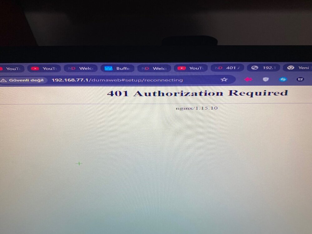

nec Posted Friday at 03:24 PM Posted Friday at 03:24 PM idk what happened but my bridge mode modem is dead and this gives this error when I try to setup wifi please help
Administrators Netduma Fraser Posted Friday at 03:52 PM Administrators Posted Friday at 03:52 PM The authorization required indicates the wrong user/password has been entered or that was cancelled. Try just accessing http://192.168.77.1 and see if it prompts you to login and go from there
nec Posted Friday at 03:54 PM Author Posted Friday at 03:54 PM its same there I am using ethernet and I formatted it this happens after I change password
Administrators Netduma Fraser Posted Friday at 04:20 PM Administrators Posted Friday at 04:20 PM Refresh and then it should prompt you to enter the username/password again, then enter the new details you set
nec Posted Friday at 04:20 PM Author Posted Friday at 04:20 PM I did still the same problem do you think if I update version somehow without doing that setting like if I can skip wifi password settings I have full access
Administrators Netduma Fraser Posted Friday at 04:48 PM Administrators Posted Friday at 04:48 PM You can't update it without access to the interface. Factory reset the router so you start the setup wizard from the beginning again, then set the username/password as admin / password as that's the default, see if you can get past then
nec Posted Friday at 04:51 PM Author Posted Friday at 04:51 PM I did default and didnt work I didnt try default and using wifi now will fo just realised
nec Posted Friday at 05:05 PM Author Posted Friday at 05:05 PM I found a way around it but I cant access to admin panel with ethernet I have to use WIFI and dont change wifi password and name then I can access but I cant make the ethernet access it

Administrators Netduma Fraser Posted Friday at 05:44 PM Administrators Posted Friday at 05:44 PM From your video, the way you're resetting is just restarting it. Hold it in for 30 seconds, release, wait 4 minutes before you try accessing the interface - it needs time to boot up properly - close the tab before you do the reset. It would also help if you have the R3 connected to your ISP modem/router so it can get internet for the Setup Wizard. Then keep WiFi detail, enter password for WiFi password and continue. If it shows that waiting to connect page just wait at least 1 minutes and it should show it has connected so you can continue.
