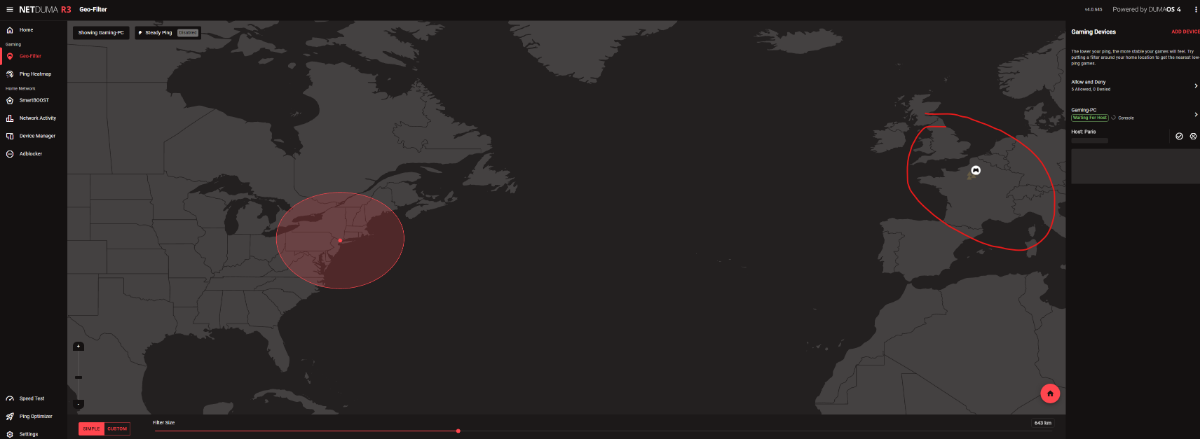

Administrators Netduma Fraser Posted February 7 Administrators Posted February 7 24 minutes ago, qwerty0776 said: Hi, sorry to highjack this, but i have the same issue. I did the above and still doesnt work. Im on duma 4.0.540. Appreciate it! Can you provide a screenshot of your Geo-Filter page when it happens please?
qwerty0776 Posted February 7 Posted February 7 (edited) Im playing with my us friends. Well im trying. Worked fine up until a couple weeks ago Edited February 7 by qwerty0776
Administrators Netduma Fraser Posted February 8 Administrators Posted February 8 That all looks fine/blocking outside and allowing inside as you'd expect. Are you the party leader or are they? If they are then you'll need to disable the Geo-Filter or be the party leader to use it enabled

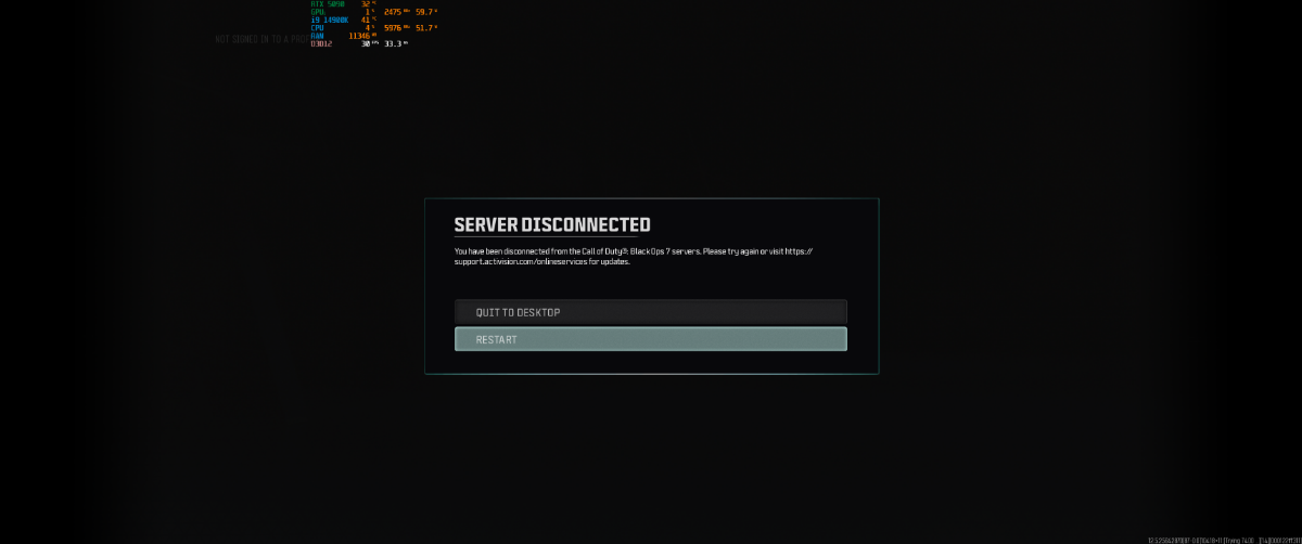

qwerty0776 Posted February 8 Posted February 8 So flushed the new firmware. Now i get this. Geo latency is turned off.
qwerty0776 Posted February 8 Posted February 8 After this selecting east coast US i get exit desktop or reconnect. Basically the 1st screenshot i posted after the fw upgrade.

qwerty0776 Posted February 8 Posted February 8 Hi, everything is as you mentioned. If i put my geofilter on now on the east coast, i get the waiting for networking and then quits when starting the game. Nothing has been changed. If i geofilter in eu is fine. Version 4.0.645. I also set the pc as a console but had no issues until around 2 weeks ago. no servers are blocked. Now i cant even see servers in the us. Only dublin one keeps popping up yellow triangle. I also went back 2 firmware and same happened also jus tried anything outside uk and same error happens
Administrators Netduma Fraser Posted February 8 Administrators Posted February 8 That dublin one is the one you need to allow, it's an authentication server, it's why you're getting the issue. You may need to redo the process a few times but once you've got them it will be fine. If you could provide the IDs also that'd be really helpful
qwerty0776 Posted February 8 Posted February 8 i have allowed the dublin one, now i can see the us one. still cant connect
Administrators Netduma Fraser Posted February 8 Administrators Posted February 8 There is likely still 1 or more Ireland servers you need to allow, allow one, restart the game, if needed allow again and repeat until you've got them all then try again.
qwerty0776 Posted February 9 Posted February 9 There are 2 servers for dublin that poped up. Been adding them and removing them but they are allowed. Now im stuck here for over 15 mins and not joining a game. Is like is trying to but drops. Not sure as it was working flawlessly before without me adding any servers to any allowed list.
