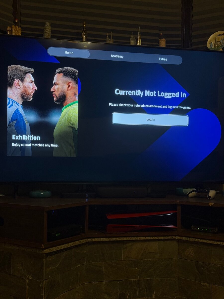

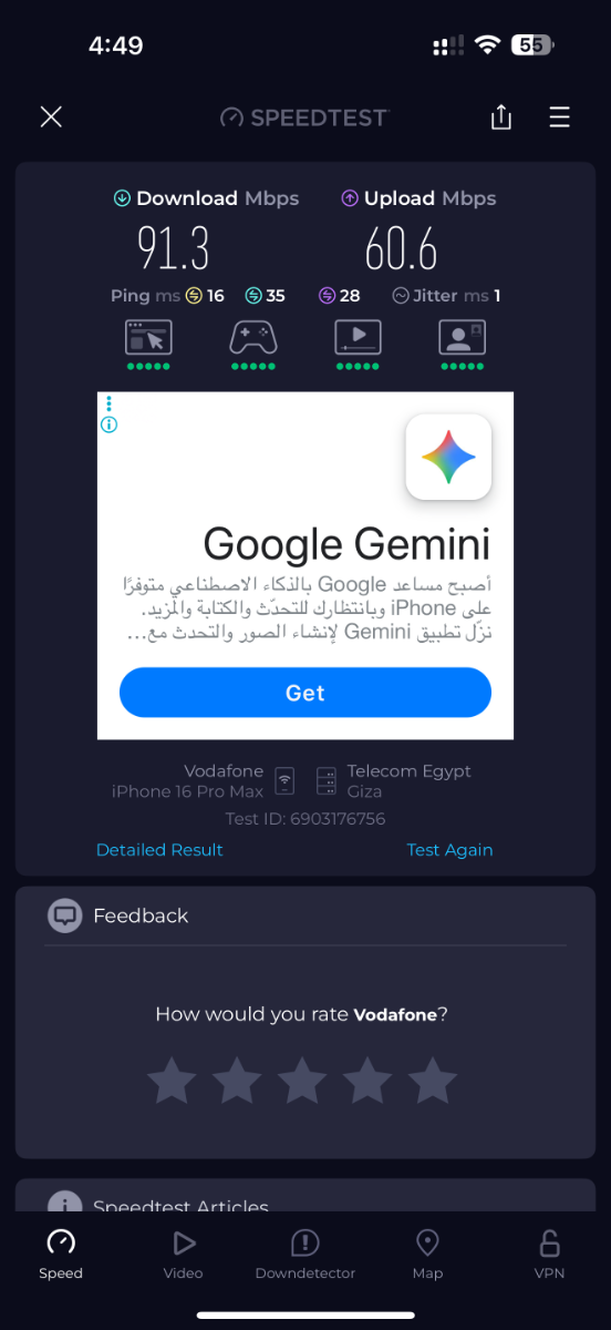

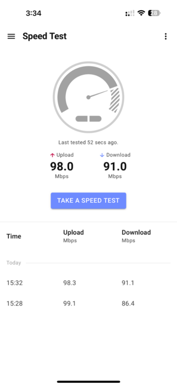

Mohamed87 Posted Sunday at 10:23 AM Posted Sunday at 10:23 AM i had two problems first one when iam playing efootball suddenly get me lost and i kicked out from the match second one i payed for 90 download and 90 upload and i test from from netduma app i get it but when i tested from speedtest app i get 90 download and 60 upload my connection HG8245W5-6T huawei-dmz-netduma R3- ps5

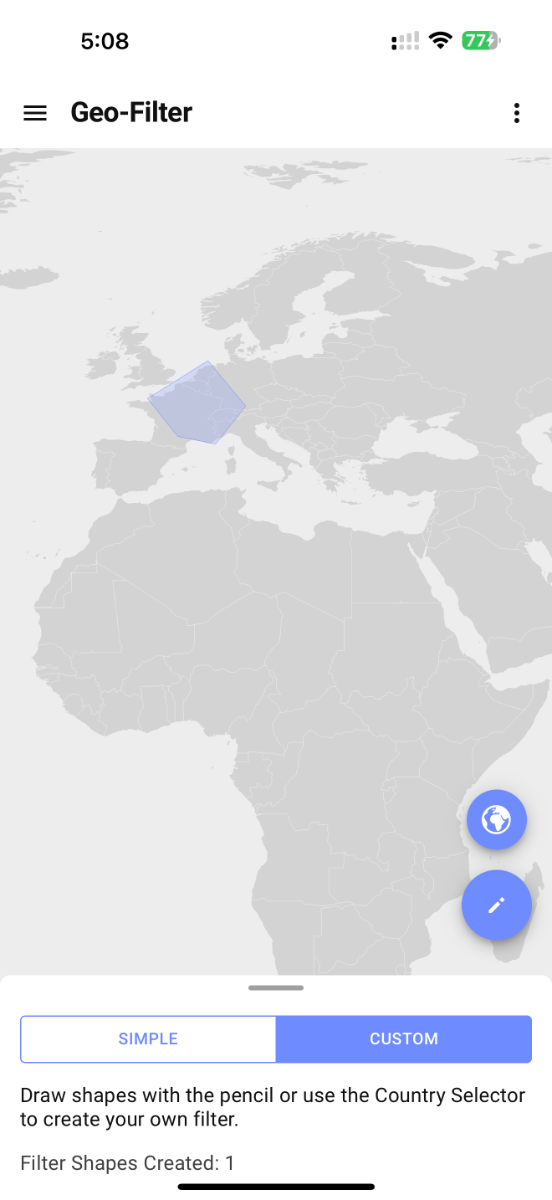

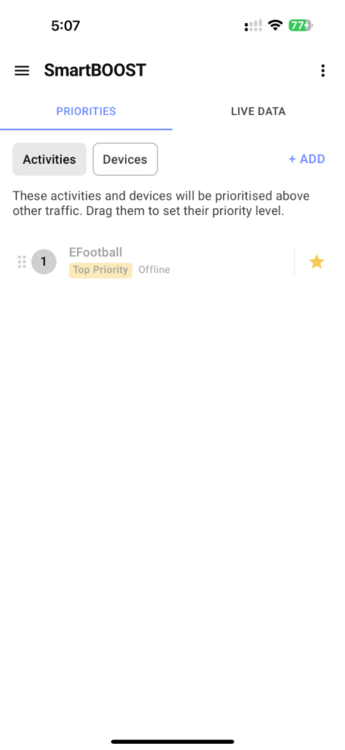

Administrators Netduma Fraser Posted Sunday at 06:18 PM Administrators Posted Sunday at 06:18 PM Are ALL devices connected to the R3? Have you entered those speeds into the router? How have you setup Congestion Control? How have you setup SmartBOOST? How is the PS5 connected, via ethernet or WiFi? How have you setup the Geo-Filter?
Mohamed87 Posted 9 hours ago Author Posted 9 hours ago there is no disconnecting after i changed to static ip but the upload speed still not accurate from wifi 5G only but via cable it be accurate

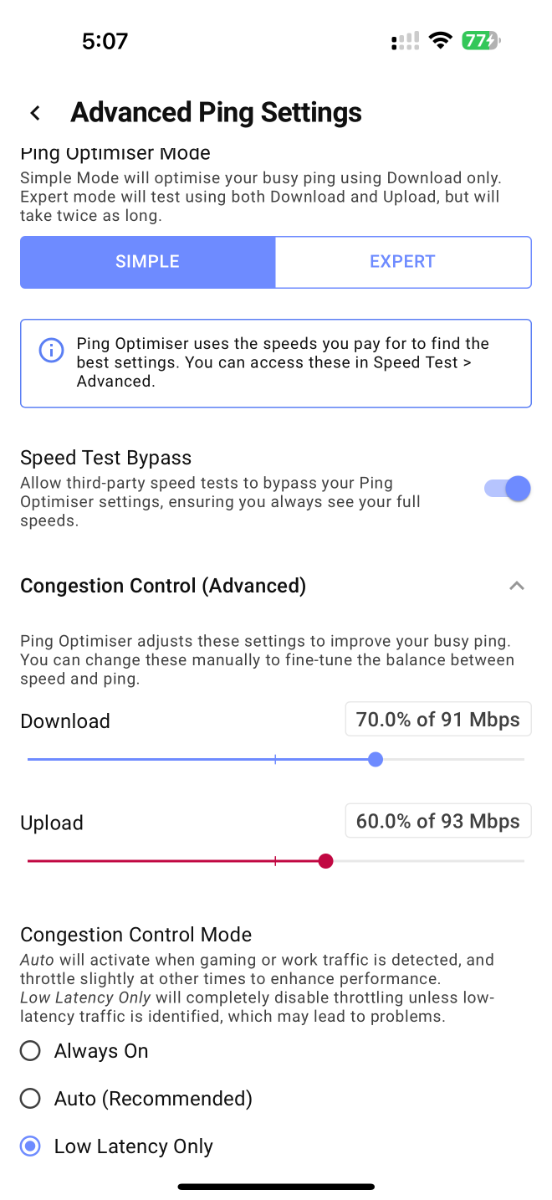

Administrators Netduma Fraser Posted 6 hours ago Administrators Posted 6 hours ago You have Congestion Control set to 60% so it is going to report around 55-60Mbps for the upload. Also WiFi is subject to interference that you don't get via ethernet cable
Administrators Netduma Fraser Posted 3 hours ago Administrators Posted 3 hours ago It may not apply to the actual app, I can't be certain but regardless that's the speed you're getting - speed test bypass just means you're seeing your full speeds reported there, with your Congestion Control settings that's not what you're actually getting if that makes sense. Do a test, put it back up to 100%, do the speeds show correct again?
