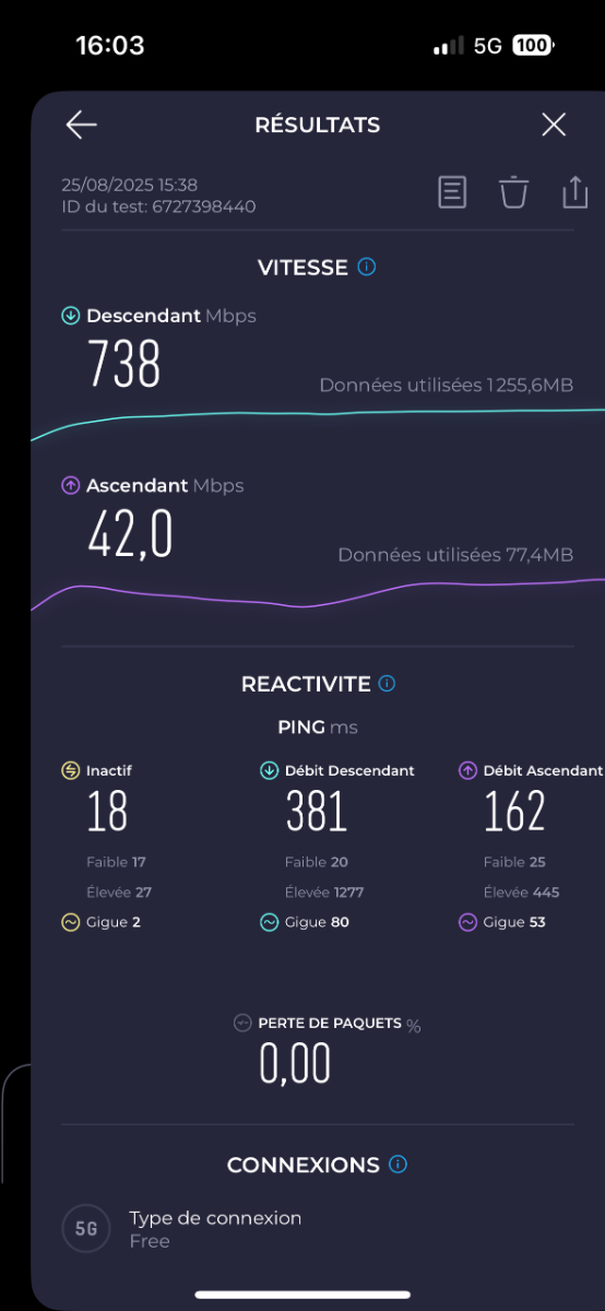

Connection speeds:
  • Typical peak speeds: ~1 Gbps download / 100 Mbps upload
  • For stability, I manually entered 100 Mbps down / 50 Mbps up into the R3
Congestion Control:
  • After extensive testing and waveform bufferbloat checks, I settled on:
    • 30.5% download
    • 19.5% upload
  • This consistently gives me A+ bufferbloat
  • However, jitter does not go below ~5 ms
  • I’m trying to understand whether this level of jitter is considered normal/expected on 5G, or if there is anything further the R3 can do to reduce it

Posted
You should enter the speeds you're actually paying for/receiving and then adjust Congestion Control from there. Entering lower speeds won't give you more stability. Once you've done this and found the best Congestion Control settings you'll see what you're left with. Make sure you have speed test bypass disabled on the Congestion Control page while conducting the tests. 5 ms is really good for 5G to be honest, I'd be shocked if you could get it any lower, I thought it would be much higher.

I’m using a Huawei CPE Pro 5 as my 5G modem.
I’ve tested multiple bands and currently have the modem band-locked to the combination that gives me the best SINR and RSRQ, rather than chasing peak throughput. My goal was stability and lower jitter.
My jitter has dropped to around 3–4 ms, compared to ~5 ms previously, without any changes on the R3 side. I’m assuming this improvement is related to tower load, scheduling, or band conditions rather than router configuration.
