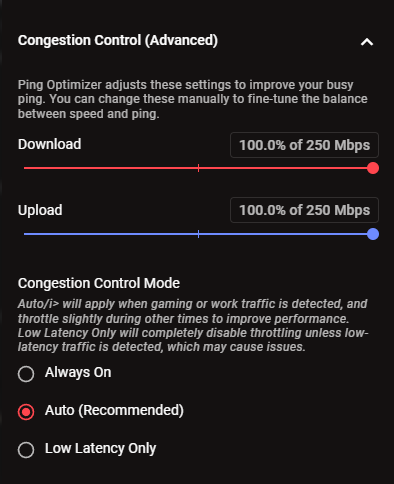

HighCat Posted December 22, 2025 Author Posted December 22, 2025 Somewhere along the process of testing WiFi and getting the picture for the congestion control it just decided it was going to work. Which is even weirder because WiFi was getting the same speeds. I'll still send the picture of my congestion control but yeah, problem seems to be solved again, hopefully this time not momentarily.
Administrators Netduma Fraser Posted December 22, 2025 Administrators Posted December 22, 2025 That's correct for full speeds so fingers crossed it stays that way this time, if not let us know!
