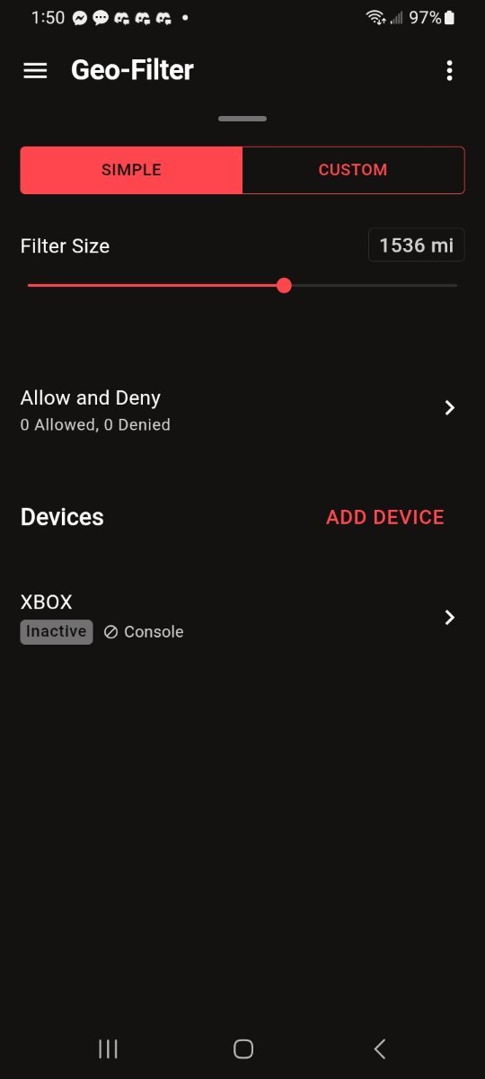

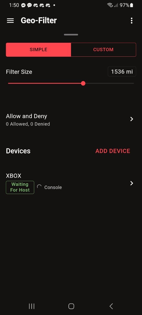

blue water Posted October 7 Posted October 7 I recently had to factory reset my router after the reset was done I tried to add my device was successful with that but then when I went to choose the game there was no option for dead by daylight don't understand what has happened but I could choose dead by daylight as a option before the factory reset also want to say that my netduma is no longer telling me when I'm connected to a server don't understand what's going on plz help

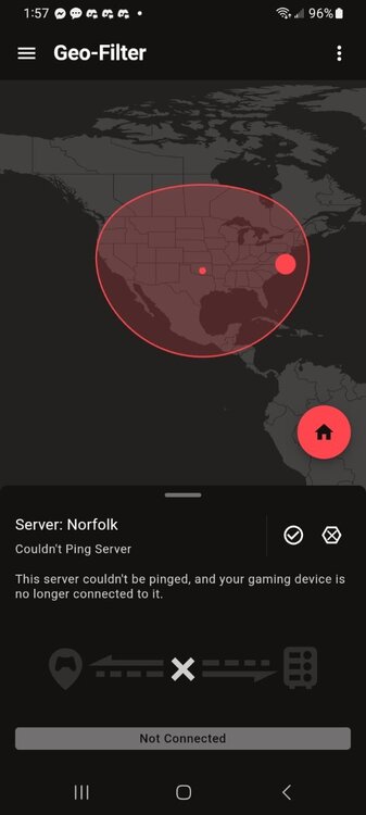

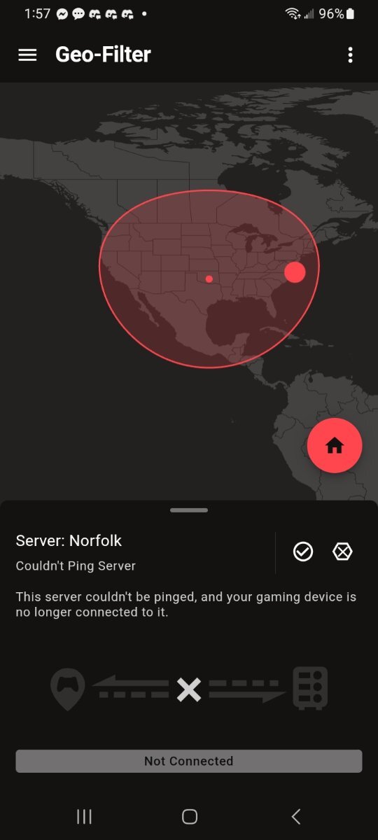

blue water Posted October 7 Author Posted October 7 I have tried everything u suggested still hasn't fixed the problem I also want to say that what actually caused this problem is that I tried to delete servers from allowed list after that it now is stuck saying looking for host it won't show me what server I'm connected to but the white servers will pop up but when I click on the server it says I'm not connected even know I am connected doesn't make any sense I'm on xbox not pc
Administrators Netduma Fraser Posted October 7 Administrators Posted October 7 44 minutes ago, blue water said: I have tried everything u suggested still hasn't fixed the problem I also want to say that what actually caused this problem is that I tried to delete servers from allowed list after that it now is stuck saying looking for host it won't show me what server I'm connected to but the white servers will pop up but when I click on the server it says I'm not connected even know I am connected doesn't make any sense I'm on xbox not pc Can you provide a screenshot of what you're seeing please?

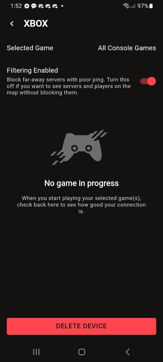

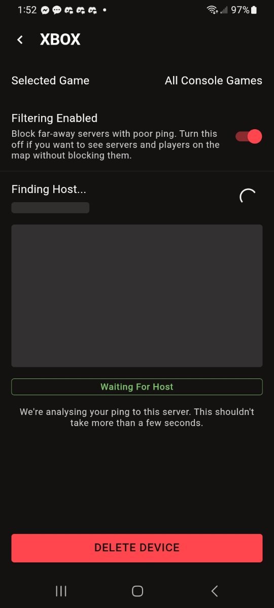

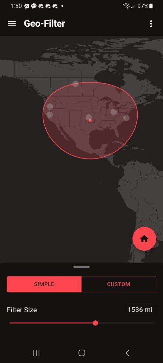

blue water Posted October 7 Author Posted October 7 It goes back and forth from waiting on host to saying I'm not connected to any server doesn't make any sense it wasn't doing any of this until I deleted some servers from the allow list now its freaking out electronics are frustrating also wanna say that dead by daylight use to be there for a option when choosing a game When your setting up the device for the correct servers I have been having to use call of duty servers to play dead by daylight not having a good time plz fix this if u have to remote fix it that's fine
Administrators Netduma Fraser Posted October 7 Administrators Posted October 7 The way it is added now will be better for playing and you won't need to switch games to filter. It won't always be able to ping that is normal. I've added you to Early Access, upgrade to the firmware there, it will bring the mobile app and router software more in line so it should be better https://forum.netduma.com/forum/144-netduma-r2-early-access/

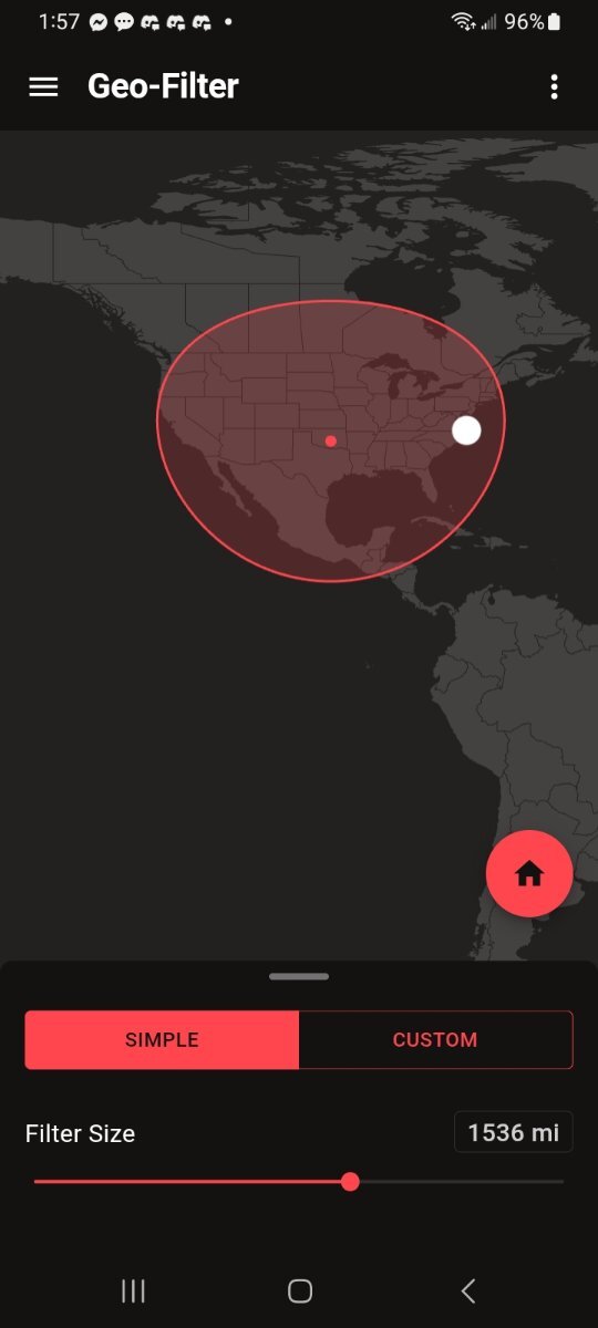

blue water Posted October 7 Author Posted October 7 You are a legend it worked thank u so much no brick this time haha I'm gonna send u some screen shots now that I have it working properly
blue water Posted October 7 Author Posted October 7 This popped up as well but I hit retry and it loaded everything up perfectly there is some bugs but overall it's awesome 👌 good job u need a raise that's why I have always went with netduma best company ever
blue water Posted October 7 Author Posted October 7 So should I delete the device so that I can get off of call of duty servers or what should I do
blue water Posted October 7 Author Posted October 7 Just got out of a game of dead by daylight my ping was awesome better then before
