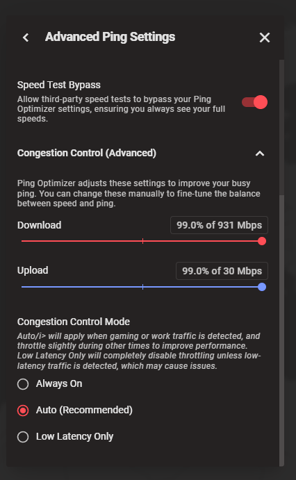

Administrators Netduma Fraser Posted October 5, 2025 Administrators Posted October 5, 2025 What is the model of the modem/router the R3 is connected to and how have you set that to ensure all traffic flows to the R3? E.g R3 in its DMZ, modem/bridge mode How have you/Ping Optimizer setup Congestion Control? Don't necessarily trust the suggestion from PO and do your own fine tuning to determine the best percentages that give you the best ping
Ryan19 Posted October 5, 2025 Author Posted October 5, 2025 2 hours ago, Netduma Fraser said: What is the model of the modem/router the R3 is connected to and how have you set that to ensure all traffic flows to the R3? E.g R3 in its DMZ, modem/bridge mode How have you/Ping Optimizer setup Congestion Control? Don't necessarily trust the suggestion from PO and do your own fine tuning to determine the best percentages that give you the best ping Thanks for the response. It's a Sagemcom F@ST3896 I didn't have R3 on DMZ or have the modem on bridge mode. One thing I forgot to say in first post is when I'm on my main modem my NAT on BO7 is Open. With R3 it's moderate. I've tried a few things since seeing your response: First, I added the R3 WAN IP from DumaOS to my modems DMZ. I went back to BO7 and my NAT was still moderate. Then, I called up my ISP and had them put my modem into bridge mode. Just went back to BO7 and NAT is still moderate. I also tried disabling UPnP on my ISP modem and enabling on DumaOS and it's still moderate. Congestion Control mode is set to Auto. I haven't personally done anything to set up congestion control, not really sure what it is. I just left all that on whatever the default was and let ping optimizer do its thing. Any other recommendations to try and get the NAT from moderate to open?

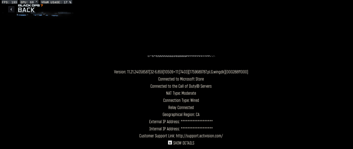

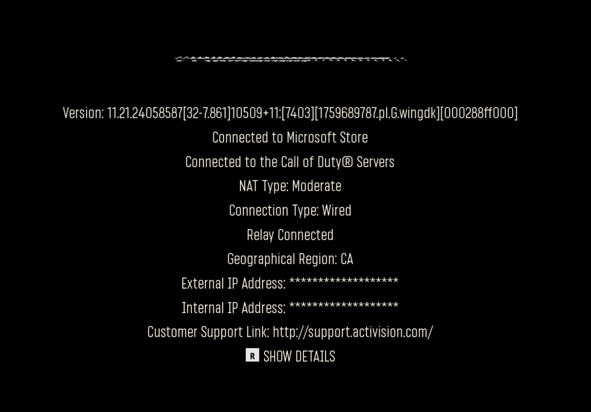

Ryan19 Posted October 6, 2025 Author Posted October 6, 2025 Hi there, I’ve tried a few more things while awaiting your response and just wanted to note them here in case it helps. I’m still on moderate nat on BO7 but just wanted to try and rule some stuff out for you. I’m not really good with tech stuff like this, and have no idea what I’m doing, so my apologies in advance if I’m explaining in a stupid way. Verified I have a public WAN IP: My WAN IP on DumaOS starts with “24.” UPnP enabled on DumaOS Rebooted ISP modem and Duma multiple times Signed out of microsoft store and xbox app, restarted pc, logged back in to both Made sure xbox and COD had public and private checked on windows firewall app protections Tried disabling windows firewall for a moment then launching cod, was still on moderate Went into DHCP on DumaOS, added rule for my pc and LAN ip to add to reserved IPs Manually opened COD ports on DumaOS: I went onto port forwarding in DumaOS and added 6 rules for my computer. I added UDP 3074, TCP 3074, UDP 3478–3479, UDP 4379–4380, UDP 27000–27050, and TCP 27014–27050. In case it matters, these all say inactive even if I’m playing COD. I then disabled UPnP on DumaOS and checked NAT on COD and it was still moderate. I saw something about ISP putting you behind CGNAT but I went to whatismyip.com and the IP it shows is the same as the WAN ip on dumaos so that has to mean I’m not under CGNAT right? Other info that might help: Under WAN on DumaOS it says my connection type is DHCP I did not have any port forwarding rules set up at all before I tried adding some this time so that didn’t skewer results from last message when I had just activated bridge mode and all that Under UPnP on DumaOS I see a “Microsoft Multiplayer UDP 3074-3074”. I didn’t manually add this at all, it was just there automatically. And something that may be of note, it always says inactive. Even if I play COD or just sit on the menu it says inactive. There was another one too that was also Microsoft Multiplayer UDP but 6382-6382. This one randomly went away by itself once I manually set up port forwarding rules.
Administrators Netduma Fraser Posted October 6, 2025 Administrators Posted October 6, 2025 I really appreciate all the additional information, a lot of people give less than needed and you've provided more so that's a nice change! Based on what you've said the NAT is likely reporting incorrectly, i.e. showing moderate but actually open so please do the following: Pick whether you want to use the bridge mode or DMZ mode, bridge will make it so you can't use the Sagem for anything really including WiFi so if you're happy with that it would be the ideal scenario though DMZ isn't a bad option you'd just have to ensure ALL devices connect to the R3 if you want total control over the network. If you go for the DMZ option then give the R3 itself a static/reserved IP on the Sagem - this will ensure that the DMZ is still valid after rebooting either device (the IP of the R3 may change otherwise and the DMZ would then be invalid). If you're using bridge mode you can ignore this. You can remove all the port forwarding rules now. Just to cover all bases reboot the Sagem, wait 2 minutes, then reboot the R3, wait 4 minutes. Ensure you don't have the game or game client e.g. steam open or active in the system tray Remove your device from the Geo-Filter Launch the game/client, does it show Open now? If so it is a misreading, you can now enable the Geo-Filter and ignore when it says moderate from now on as it will actually be open. If you're interested and that was the cause, the Geo-Filter is blocking the server it uses to test your NAT status, as it can't reach the test server it just defaults to showing moderate as all other connection indicators will appear fine. So it's not that your NAT IS moderate, just that it can't confirm that it isn't if that makes sense. Regarding your Congestion Control settings, if you haven't setup SmartBOOST then it won't be doing anything at all - auto means it will only trigger if SmartBOOST is triggering/active. So it's entirely up to you, ensure you have SmartBOOST setup how you want i.e. prioritize gaming and then when you are gaming it will be prioritized and Congestion Control will trigger or switch it to Always so it will always apply. Regardless though at 99% it's essentially doing nothing anyway. I'd suggest starting with 70% for download & upload and going from there, adjusting if needed.
Ryan19 Posted October 6, 2025 Author Posted October 6, 2025 3 hours ago, Netduma Fraser said: I really appreciate all the additional information, a lot of people give less than needed and you've provided more so that's a nice change! Based on what you've said the NAT is likely reporting incorrectly, i.e. showing moderate but actually open so please do the following: Pick whether you want to use the bridge mode or DMZ mode, bridge will make it so you can't use the Sagem for anything really including WiFi so if you're happy with that it would be the ideal scenario though DMZ isn't a bad option you'd just have to ensure ALL devices connect to the R3 if you want total control over the network. If you go for the DMZ option then give the R3 itself a static/reserved IP on the Sagem - this will ensure that the DMZ is still valid after rebooting either device (the IP of the R3 may change otherwise and the DMZ would then be invalid). If you're using bridge mode you can ignore this. You can remove all the port forwarding rules now. Just to cover all bases reboot the Sagem, wait 2 minutes, then reboot the R3, wait 4 minutes. Ensure you don't have the game or game client e.g. steam open or active in the system tray Remove your device from the Geo-Filter Launch the game/client, does it show Open now? If so it is a misreading, you can now enable the Geo-Filter and ignore when it says moderate from now on as it will actually be open. If you're interested and that was the cause, the Geo-Filter is blocking the server it uses to test your NAT status, as it can't reach the test server it just defaults to showing moderate as all other connection indicators will appear fine. So it's not that your NAT IS moderate, just that it can't confirm that it isn't if that makes sense. Regarding your Congestion Control settings, if you haven't setup SmartBOOST then it won't be doing anything at all - auto means it will only trigger if SmartBOOST is triggering/active. So it's entirely up to you, ensure you have SmartBOOST setup how you want i.e. prioritize gaming and then when you are gaming it will be prioritized and Congestion Control will trigger or switch it to Always so it will always apply. Regardless though at 99% it's essentially doing nothing anyway. I'd suggest starting with 70% for download & upload and going from there, adjusting if needed. Hey Fraser, Thanks for the response. Yeah I was pretty dumbfounded going through some of the posts on the forum related to my issue, people really give you nothing to work with and expect you to know what to do haha. So I decided to just stick with bridge mode. My ISP only allows me to enable/disable bridge mode by calling them which is a pain, so I'll just stick with bridge instead of DMZ. I then deleted all my port forwarding rules from DumaOS. I went into DumaOS, and removed my computer from devices on Geo-Filter. Then I unplugged power from Sagem, waited 2 minutes, plugged it back in, waited 2 minutes, unplugged power from R3, waited 4 minutes, plugged it back in, and waited 4 minutes. For extra measure I then restarted my PC. I launched Call of Duty, then went into task manager to end task on the Xbox PC App Game Client. I waited 4 minutes on the game menu just to make sure everything connected, then went into network info, and NAT type was still on moderate: (pictured below) I believe I did set up SmartBoost when I got the R3 a year or so ago. I just haven't touched any of the settings since. When I go to SmartBoost on DumaOS, I can see I have my PC added to devices and active, marked as top priority, and I have my activities listed out with gaming as #1 top priority. I have priority mode on simple. Should I change congestion control mode from "Auto" to "Always On"? Or is Auto already triggering SmartBoost since I have it active? I don't really understand what the percentages mean for Download and Upload in Congestion Control. I'll have to look into the feature more cause I don't fully understand it, but I can try your recommendation of starting at 70% for both and seeing what it does. At the end of the day though, does this SmartBoost feature have any impact or correlation to my NAT still being moderate? Is there anything else I can try to get it open? Truly lost on what to try next, open to any recommendations! Thanks again for help Fraser, I really appreciate it!

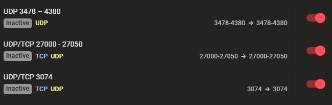

Administrators Netduma Fraser Posted October 6, 2025 Administrators Posted October 6, 2025 Auto should be triggering already - to check if it is disable speed test bypass and do a speed test, it should be limited to the speeds shown with the percentages you've set. No correlation to NAT no. Add back your port forwards but make it more simple by consolodating it to 3 rules: UDP/TCP 3074 UDP/TCP 27000 - 27050 UDP 3478 – 4380 Then restart the PC and check the NAT again - still with the Geo-Filter disabled.
Ryan19 Posted October 6, 2025 Author Posted October 6, 2025 33 minutes ago, Netduma Fraser said: Auto should be triggering already - to check if it is disable speed test bypass and do a speed test, it should be limited to the speeds shown with the percentages you've set. No correlation to NAT no. Add back your port forwards but make it more simple by consolodating it to 3 rules: UDP/TCP 3074 UDP/TCP 27000 - 27050 UDP 3478 – 4380 Then restart the PC and check the NAT again - still with the Geo-Filter disabled. Am I adding these port forwards properly? For UDP/TCP 3074 I selected port, not port range, and did both source and destination as 3074, and checked the box for UDP and TCP. For UDP/TCP 27000 - 27050, I selected port range, set source start and destination start as 27000, and source end and destination end as 27050, and checked the box for UDP and TCP. For UDP 3478 - 4380, I selected port range, set source start and destination start as 3478, and source end and destination end as 4380, and just checked the box for UDP. Let me know if this is correct format. I reset PC and checked NAT again with Geo-Filter disabled and it's still moderate but I'm stupid so maybe I'm formatting these ports wrong? Also they still say inactive even when I'm on the game.
Administrators Netduma Fraser Posted October 6, 2025 Administrators Posted October 6, 2025 I would say change the source to 1 - 65535 for each as you don't actually know the source port so it's more correct/likely to work that way. Other than that spot on.
Ryan19 Posted October 6, 2025 Author Posted October 6, 2025 3 minutes ago, Netduma Fraser said: I would say change the source to 1 - 65535 for each as you don't actually know the source port so it's more correct/likely to work that way. Other than that spot on. Ok am I selecting port or port range? If I'm selecting port, what's my source port and destination port? If I'm selecting port range, what's my source start and source end, and my destination start and destination end? Sorry to be so specific, I just really don't know what I'm doing here haha. If you could be as specific as possible for me that'd help a ton.
Administrators Netduma Fraser Posted October 6, 2025 Administrators Posted October 6, 2025 1 hour ago, Ryan19 said: Ok am I selecting port or port range? If I'm selecting port, what's my source port and destination port? If I'm selecting port range, what's my source start and source end, and my destination start and destination end? Sorry to be so specific, I just really don't know what I'm doing here haha. If you could be as specific as possible for me that'd help a ton. No worries! All port range and for each set the source as: Source Start 1 Source End 65535 Then for the 3 individual rules set: Destination Start 3074 Destination End 3074 Protocol TCP & UDP ---- Destination Start 27000 Destination End 27050 Protocol TCP & UDP ---- Destination Start 3478 Destination End 4380 Protocol UDP Let me know if that's not clear enough!
Ryan19 Posted October 6, 2025 Author Posted October 6, 2025 36 minutes ago, Netduma Fraser said: No worries! All port range and for each set the source as: Source Start 1 Source End 65535 Then for the 3 individual rules set: Destination Start 3074 Destination End 3074 Protocol TCP & UDP ---- Destination Start 27000 Destination End 27050 Protocol TCP & UDP ---- Destination Start 3478 Destination End 4380 Protocol UDP Let me know if that's not clear enough! Hey that's great I get it now. Ok so I deleted the other 3 rules then added the port range with source 1-65535 and destination 3074-2074 TCP & UDP. Then, I went to make another rule for the 27000-27050 and 3478-4380 destinations with 1-65535 source, but for both I got this error pictured below: "Ports overlap with a different rule." How do I get past that?

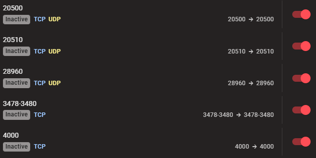

Administrators Netduma Fraser Posted October 6, 2025 Administrators Posted October 6, 2025 Also as you're using PC but not Steam you may need to add the extra ports mentioned here for BO6 which almost certainly apply to the beta as well: https://support.activision.com/articles/ports-used-for-call-of-duty-games Reason I mentioned to check with another game is it's not uncommon for the beta NAT reading to not be correct as we've sometimes seen with previous betas
Ryan19 Posted October 6, 2025 Author Posted October 6, 2025 26 minutes ago, Netduma Fraser said: Also as you're using PC but not Steam you may need to add the extra ports mentioned here for BO6 which almost certainly apply to the beta as well: https://support.activision.com/articles/ports-used-for-call-of-duty-games Reason I mentioned to check with another game is it's not uncommon for the beta NAT reading to not be correct as we've sometimes seen with previous betas Hey Fraser, I just added all the ports seen above. Hopefully they all look formatted right? I went through that Activision link you sent and added every steam, pc, and xbox TCP and UDP ports. It's still moderate on the BO7 beta. The only other cod I have downloaded is black ops 3 and I checked there and the nat is open so I guess it's maybe the like you said with the reading not being correct cause it's a beta. Is there anything else I could possibly try to get the BO7 beta or is it just chalked cause it's reading wrong? Before I switched to bridge mode and did all my original tests from the start of this thread on my ISP provided router, the NAT type was saying open. Then switching to R3 has made it be moderate. Strange. Open to anymore recommendations, and again, thanks a ton for the help!

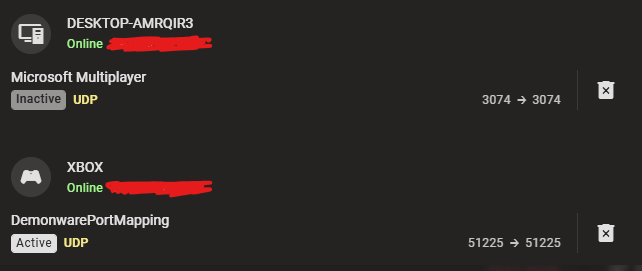

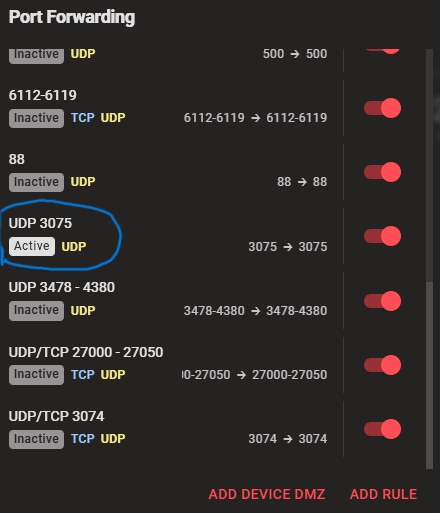

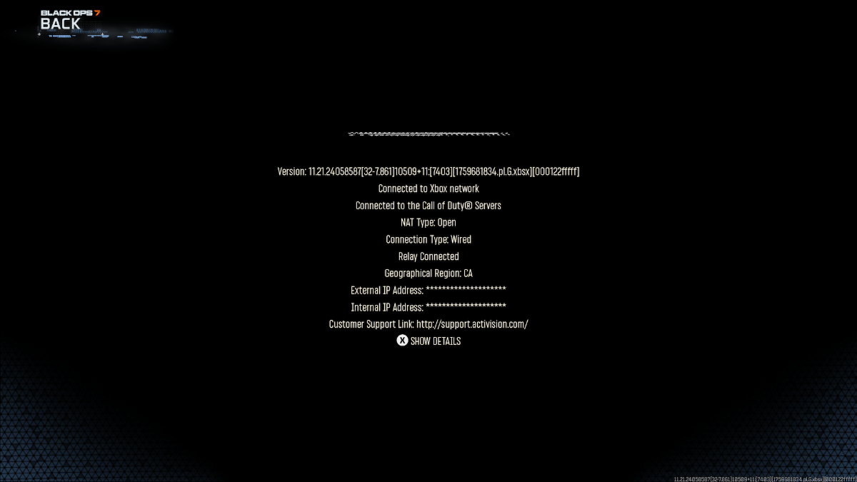

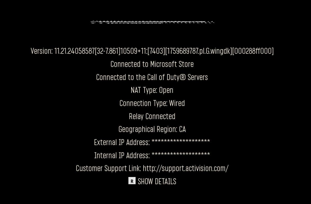

Ryan19 Posted October 7, 2025 Author Posted October 7, 2025 Wanted to add this here. I decided to download the BO7 beta to my Series S to see what the NAT would show. I connected the xbox to the duma with a ethernet. NAT type Open. I added pic of my network info on PC vs Xbox. Why could it be open on xbox but not PC? I also just wanted to add, in case it matters: On xbox and pc for the external ip they're the same but at the end xbox shows :51255 and PC shows :3075 Also the internal Ip address for pc and xbox don't match, is that normal? The internal ip also ends in :51225 for xbox and :3075 for PC, but IP addresses end in different numbers. Also, I noticed a difference in the UPnP settings in DumaOS pictured below: For my pc it has the "Microsoft Multiplayer" UDP 3074 and for Xbox it has the "DemonwarePortMapping" UDP 51225. The weird thing though is for xbox it shows "Active" and for my PC it shows "Inactive" is that normal? Even if I have the game open on pc or am playing a game, it's still inactive. Sorry if that's nothing and just normal, wanted to bring it up just in case.
Ryan19 Posted October 7, 2025 Author Posted October 7, 2025 5 hours ago, Netduma Fraser said: Also as you're using PC but not Steam you may need to add the extra ports mentioned here for BO6 which almost certainly apply to the beta as well: https://support.activision.com/articles/ports-used-for-call-of-duty-games Reason I mentioned to check with another game is it's not uncommon for the beta NAT reading to not be correct as we've sometimes seen with previous betas I fixed it! It's finally open! This was the fix: All I had to do was add a port forwarding rule for UDP 3075 Source and Destination. I got the idea cause I noticed the external and internal ip in network info on cod had :3075 but the one in UPnP that was automatically added there was :3074 for some reason so it was inactive. As soon as I added the 3075 in port forwarding and launched BO7 it went active and NAT switched to open. I'm just curious, why did this happen? Why did the UPnP in DumaOS have 3074 and not 3075?
Administrators Netduma Fraser Posted October 7, 2025 Administrators Posted October 7, 2025 Good find, well done! 3074 is the primary port it would use and then if you had another device for example that you were using also it'd use 3075 for that, then 3076 and so on. Given it was open on BO3 it's likely BO7 was just looking to use 3075 outright for some reason rather than the default 3074, perhaps a bug or another reason for it, hard to say!

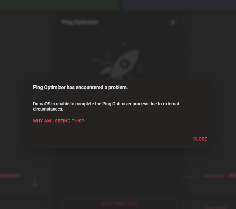

Administrators Netduma Fraser Posted October 7, 2025 Administrators Posted October 7, 2025 11 minutes ago, Ryan19 said: Ahhh ok that makes sense. I keep getting this error below when I try to use Ping Optimizer. Do you know a fix for it? Also, I reactivated Geofilter but when I connect to a match in BO7 geofilter just spins nonstop saying "Finding Host..." and "Waiting for Host" Even after I connect to a match and play through a whole match it stays spinning the whole time. Any fix for this? We're aware it's not 100% reliable at the moment so working to improve that, it should work if you come back later to it, otherwise just adjust Congestion Control manually. While we try to get support during a beta period we can't be sure of anything until it launches so we'll have to test it properly then and make any necessary changes
