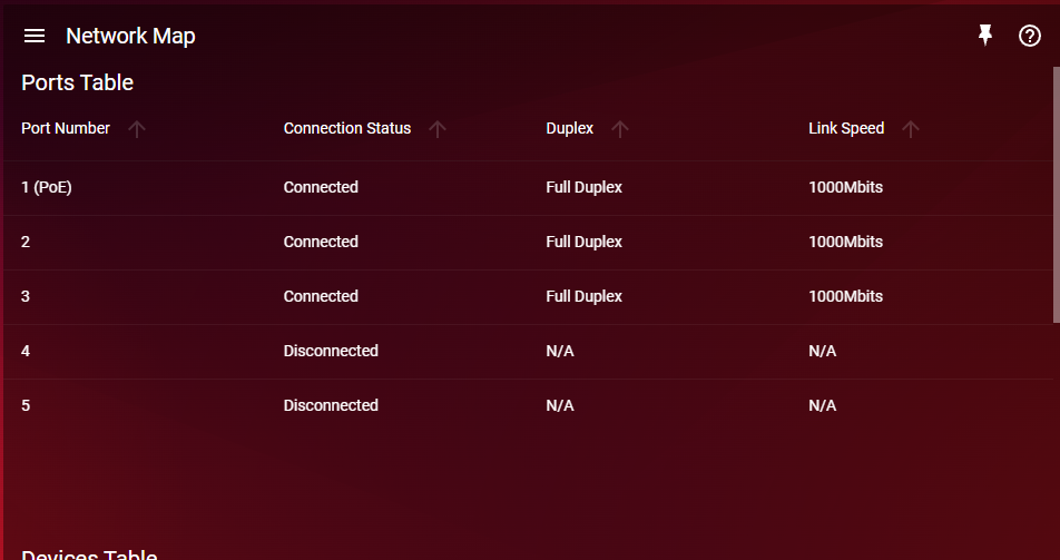

Administrators Netduma Fraser Posted September 21, 2025 Administrators Posted September 21, 2025 Go to the Device Manager and switch to the table view (click top left of the Device Manager panel), then provide a screenshot of that page please
weyzz Posted September 22, 2025 Author Posted September 22, 2025 On 9/21/2025 at 7:20 PM, Netduma Fraser said: Go to the Device Manager and switch to the table view (click top left of the Device Manager panel), then provide a screenshot of that page please yes , i have 600mbits download and 100 upload in device manager

Administrators Netduma Fraser Posted September 23, 2025 Administrators Posted September 23, 2025 Okay do a factory reset first from the interface, wait 4 minutes then check your speed please, if its still low then do what I mentioned before please: Go to the Device Manager and switch to the table view (click top left of the Device Manager panel), then provide a screenshot of that page please
weyzz Posted September 23, 2025 Author Posted September 23, 2025 46 minutes ago, Netduma Fraser said: Okay do a factory reset first from the interface, wait 4 minutes then check your speed please, if its still low then do what I mentioned before please: Go to the Device Manager and switch to the table view (click top left of the Device Manager panel), then provide a screenshot of that page please

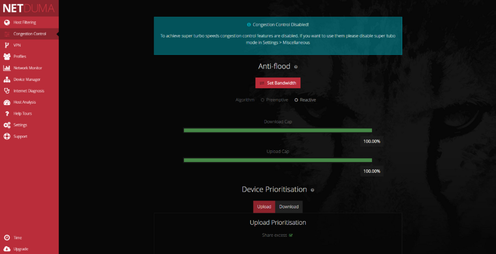

weyzz Posted September 24, 2025 Author Posted September 24, 2025 10 hours ago, Netduma Fraser said: Do you still have devices connected to your 5G box? Where are you testing the speeds exactly? i use currently SPPEEDTEST.NET for measure my internet speed , only netduma connected on my 5g box , i use different devices on my netduma my internet speed without netduma is 450 mbps in download and 10 mbps in upload , when i download on xbox serie x with netduma connected my download speed is 100 mbps constantly , yesterday when i dowload recent version netduma , i tested my internet speed in 1 hour later with speedtest.net is very low i had 22 mbps on speedtest ...

weyzz Posted September 24, 2025 Author Posted September 24, 2025 10 hours ago, Krush said: Ok, ce sont tes vitesses de téléchargement sur ta Xbox, c’est forcément lié au paramètres du QoS. Comme la Xbox est considéré comme un flux jeu, le QoS réduit la vitesse automatiquement pour ne pas congestionner l’ensemble du réseau local… Faudrait désactiver le QoS sur le R1 lorsque tu lances le téléchargement d’un jeu ! j'avais déjà testé de désactiver le QOS mais lorsque je le désactive mon débit chute après quelques heures a seulement 22 MBPS je ne sais pas pourquoi ... et faut que je rédemarre pour qu'il retrouve le débit initial

Administrators Netduma Fraser Posted September 25, 2025 Administrators Posted September 25, 2025 How have you set the box to ensure all traffic flows to the R1? E.g R1 in its DMZ, modem/bridge mode Have you entered those speeds into the router? How have you setup Congestion Control? Do you require PPPoE/VLAN or DHCP identifiers for a connection?
weyzz Posted September 25, 2025 Author Posted September 25, 2025 4 hours ago, Netduma Fraser said: How have you set the box to ensure all traffic flows to the R1? E.g R1 in its DMZ, modem/bridge mode Have you entered those speeds into the router? How have you setup Congestion Control? Do you require PPPoE/VLAN or DHCP identifiers for a connection? - i setup my internet speed on congestion control and i try disabled QOS ( not resolved ) - i add in IP DMZ my netduma on my 5g router , i can't configure yet my router 5g in bridge he is in " router mode '' for the time being - i don't think i need it PPoE and DHCP
