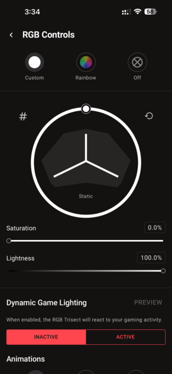

Zac Posted September 16 Posted September 16 I have had the RGB on the unit set to off for a long time infact since I got the unit. I am not one for RGB however, I was hoping we would be able to set it to plain white? But when I do it's like bluey green. I can get a photo later but I just thought i'd ask as i'm sure Fraser or somebody can confirm if the unit can do pure white or if my rgb is faulty. Just looking to add a bit of white luminance to my room when it's darker was my thought behind it was all. Cheers
Administrators Netduma Fraser Posted September 16 Administrators Posted September 16 I'm slightly colour blind so you'll have to tell me, if you click the # button on the RGB controls and enter 6 f's ffffff does it appear more white to you then? It looks white to me
Zac Posted September 17 Author Posted September 17 On 9/16/2025 at 10:37 PM, Netduma Fraser said: I'm slightly colour blind so you'll have to tell me, if you click the # button on the RGB controls and enter 6 f's ffffff does it appear more white to you then? It looks white to me Hey Fraser, been awhile hope you’re well mate. yeah I tried that mine is green. I just factory reset my router as my 5ghz keeps on dropping out too annoyingly. It’s been stable for .. well years. ill take a photo when i get home a bit later and upload it. I think my r3 is dying :(

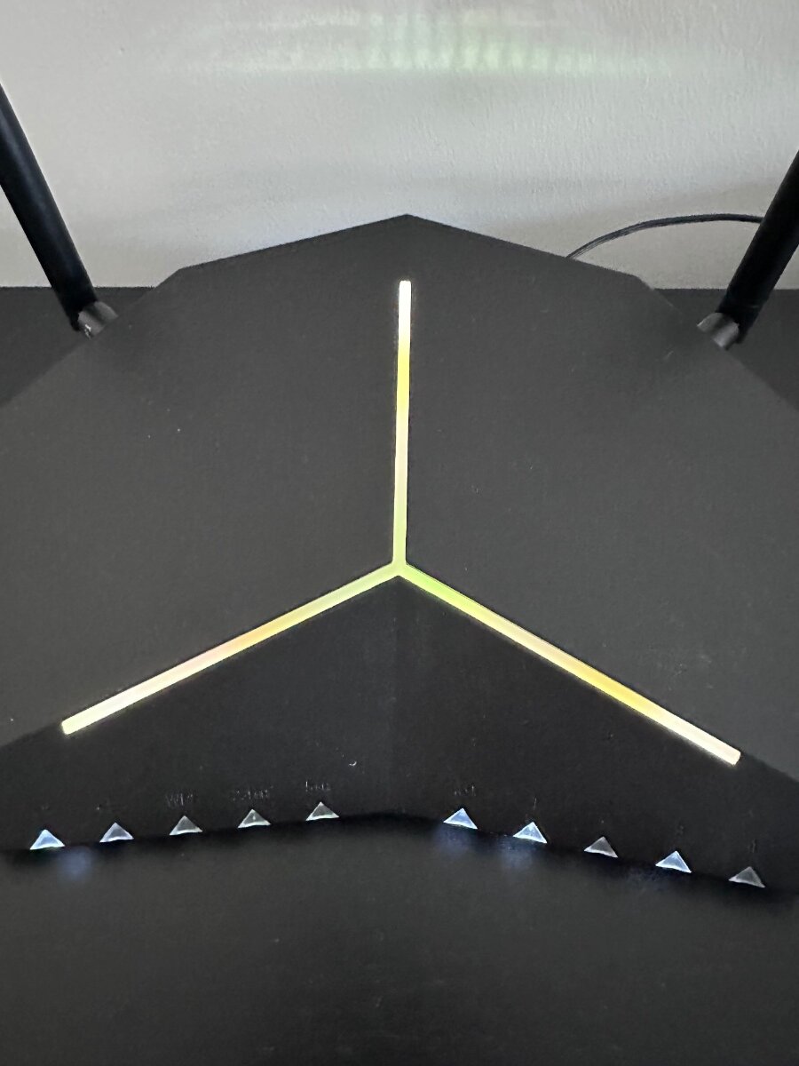

Zac Posted September 18 Author Posted September 18 Yeah it’s like yellow and green. shame as I have had the lighting turned off since I got it. but yeah also my 5ghz band keeps randomly dropping out. I checked to make sure it hadn’t been weirdly set to a dfs channel but it hadn’t. my 2.4 is fine though. curious what was the warranty on these ? I imagine I’m probably just outside now since I got it on pre order

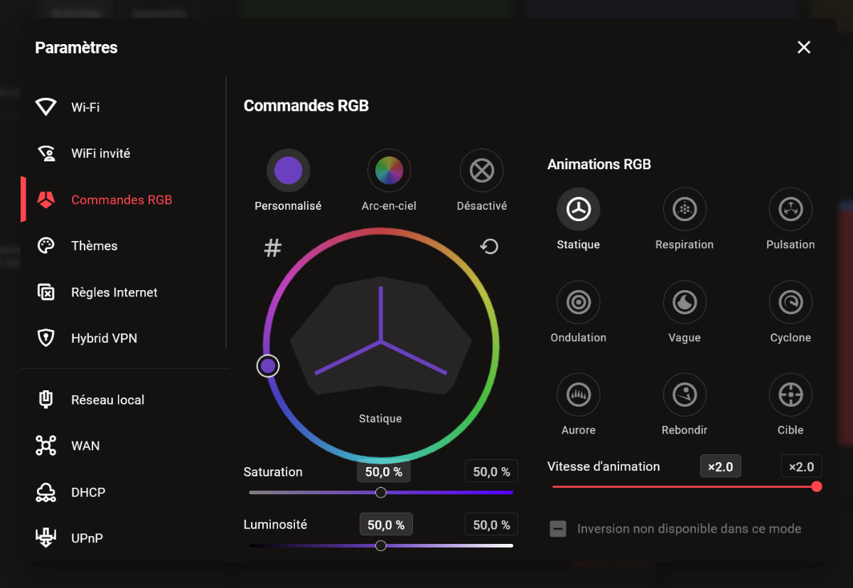

Krush Posted September 24 Posted September 24 Le miens apparaît blanc en le configurant de cette manière !
Zac Posted September 24 Author Posted September 24 3 hours ago, Krush said: Le miens apparaît blanc en le configurant de cette manière ! That’s odd if yours is displaying white on purple that points to an entirely different issue but I’ll try that tonight and see if I get the same result problem is that mine has different lights throughout when it shouldn’t
Administrators Netduma Fraser Posted September 25 Administrators Posted September 25 A bit more white but not pure white for me, regardless I've passed it onto the team so they'll take a look when they can Krush 1
Zac Posted September 25 Author Posted September 25 Copying your settings my rgb doesn’t change still green/ yellow/ brown but it’s white at the edges. Krush and Netduma Fraser 2
