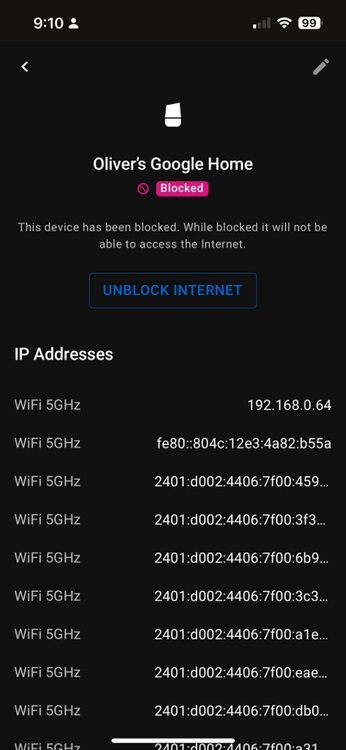

TinyBubu Posted August 22 Posted August 22 Hi all, I'm wanting to block internet access overnight for all my kid's devices. Works fine and as expected for all devices except my son's Google Home. Even if blocked, I've just discovered that he can still use it to watch YouTube videos etc! Any idea why this particular device is still able to access the internet even when blocked and also how to fix this apparent glitch?
Administrators Netduma Fraser Posted August 22 Administrators Posted August 22 Could you provide a screenshot of how you have setup your rules currently to block devices? Then we can advise from there
TinyBubu Posted August 22 Author Posted August 22 Hi Fraser. Thanks for your reply. Nothing that elaborate... I'm simply selecting the "BLOCK INTERNET" button in the app. As previously explained, it works fine for every other device, just not my son's Google Home.
Administrators Netduma Fraser Posted August 23 Administrators Posted August 23 6 hours ago, TinyBubu said: Hi Fraser. Thanks for your reply. Nothing that elaborate... I'm simply selecting the "BLOCK INTERNET" button in the app. As previously explained, it works fine for every other device, just not my son's Google Home. By the looks of it, the Google Home has a network feature called Random/Private MAC addresses enabled, I haven't got/used a Google Home so I can't say for certain but this may be something you can disable in the app for it. Essentially what it does is as you can see there, sets a new MAC address for the device everytime it connects to the router. A MAC address is a unique device identifier, essentially showing as a new device when connecting to the router so in theory he could just be unplugging it and replugging it in and then it will allow him to bypass the block. A couple of potential solutions: Disable Random/Private MAC addresses on the Google Home app - if he has access to the app and knows about this he could just re-enable it Set a static/reserved IP address for the Google Home device - verify the internet works outside your block - then disable DHCP on the modem - this would require you to set a static/reserved IP for every device connected to the modem otherwise they would not be able to connect with DHCP disabled. If any of those devices have the MAC address enabled then they may not be able to connect when this changes. Any new devices you want to connect to the network would have to be given a static/reserved IP on the device itself to connect, you can then mirror that on the modem. Your rule there is showing it as purely connecting to 5GHz, similar to what I've mentioned when connected to 2.4GHz the device will have a different MAC address so he could be connecting it to 2.4GHz when the rule shuts it off for 5GHz. Identify the device that appears/uses traffic at the time using 2.4GHz and block that as well. Combining the WiFi into one may also be a good idea. If all else fails then probably the simplest and guaranteed way to prevent him using any tech savvyness to counteract what you do - remove the device from his room every night
TinyBubu Posted August 28 Author Posted August 28 Hi Fraser. I understand your logic but unfortunately don't think it is correct hypothesis. Yes, multiple IPv6 addresses are being assigned (as is the case with most devices on the network) but only one MAC address. I've checked and the MAC address listed in the DUMAOS app matches the MAC address of the device. The Google Home is an old device and has quite simple network functionality / configuration. It certainly doesn't support Random/Private MAC addresses. If it did, then it should show up as multiple devices in the app (one online and the rest offline), each time a new MAC address is generated, which is the case for the iPhones that connect to the router. In fact, as a side issue, that is one of my pet peeves, the Offline Devices get filled with multiple entries (for devices that have Random/Private MAC addresses enabled) and these redundant multiple entries have to be cleaned up manually, one by one! When will bulk select and delete functionality be available (is it on the roadmap or perhaps already included with the latest build)? Also, the Google Home is only connecting via 5GHZ. When it is blocked, it doesn't alternatively try to connect via 2.4GHZ. I've tested and monitored this to confirm. The 5GHZ and 2.4GHZ bandwidths are already combined as a single SSID. The Google Home is actually his alarm clock, so I don't really want to have to physically remove it every night (especially when I should simply be able to block Interest access at the router)! Any other ideas (or can this be escalated to the dev team for comment), as it definitely seems to be a glitch.
Administrators Netduma Fraser Posted August 28 Administrators Posted August 28 You're absolutely right, that'll teach me to do a very early morning response! What you have said has got me thinking, when it comes to the time where it should be blocked, can you actually see traffic being used on it? For YouTube it should be showing quite consistently. If it doesn't, obviously I don't know the specifics BUT if he has a mobile with data he may be utilizing it as a hotspot to connect the home to unless I'm mistaken and it's not one of those Home ones with a screen but more akin to a simple Alexa and he's using it as a bridge to get the TV to play YouTube for example?

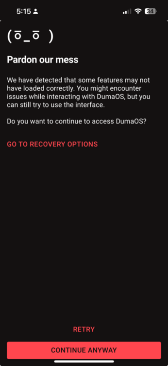

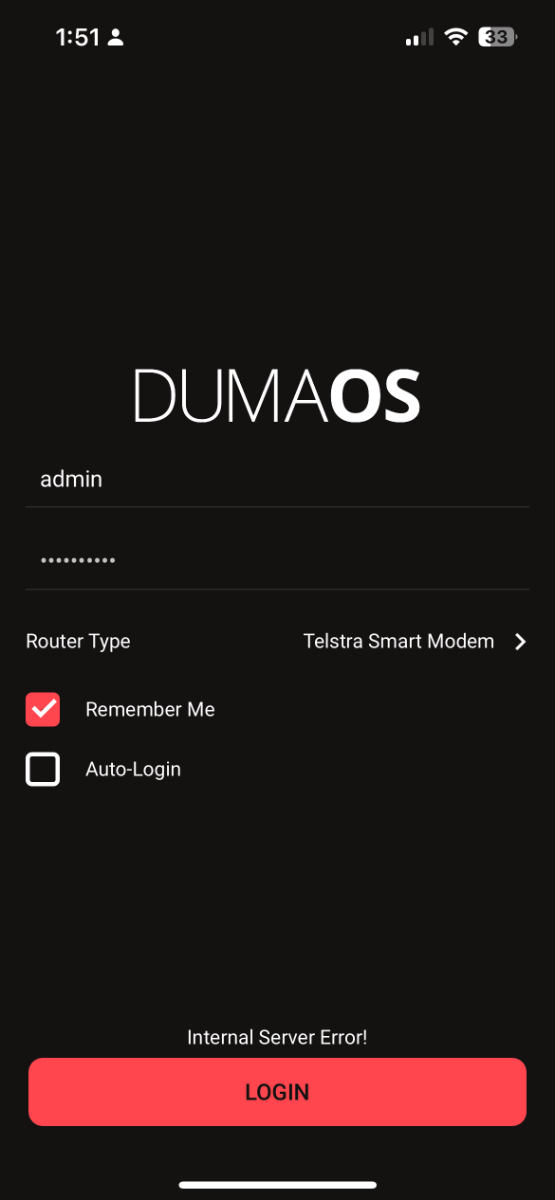

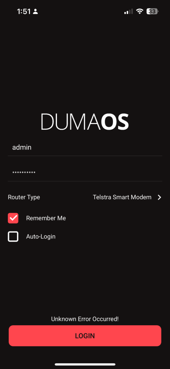

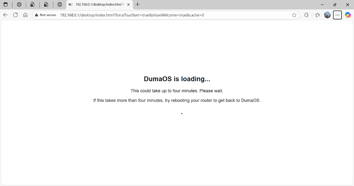

TinyBubu Posted October 18 Author Posted October 18 Picking up this conversation thread from a couple of months ago... as still battling this issue! Just to clarify, my son isn't hotspotting to phone, etc... the traffic is definitely flowing through the DumaOS controlled router, it's just that particular device's internet access, for whatever reason (bug?) isn't being blocked via MAC address, as per previously posted configured settings. I now can't even logon to the router to check / change the settings (seems a lot of users previously complaining about the very same issue, without a proper resolution being found). A router reboot (after a 10min delay) used to work, at least for initial logon straight after the router came back online and all services active (I'd then hit the same logon issue after half an hour or so). Now a router reboot doesn't even work, which is very frustrating to say the least! I've tried using the IOS DumaOS app, various web browsers on different devices, but get the same result! These are the error messages I would previously get: Since rebooting the router today, I'm now receiving these errors: IOS app Windows Edge Can you please advise how to resolve this logon issue, as without having access to the router config, I can't even start to troubleshoot why the device block isn't working properly!
Administrators Netduma Fraser Posted October 18 Administrators Posted October 18 Disable the Internet Optimiser, reboot and then enable it, reboot then check if you can get access please. If there is an update available that should also get you on the latest.
TinyBubu Posted October 19 Author Posted October 19 Hi Fraser, Thanks for the prompt reply. Is there no other workaround / fix (beside telling customers to reinstall)? What exactly is going on (seems I'm not the only Telstra customer having the same logon issue)? Can't I provide logs so the dev team can actually investigate and identify the root cause (then fix it once and for all)? I've checked previous threads and the advice has been "this is a known issue, which will be fixed in the next release", yet those posts were last year (or even earlier) yet the exact same issue seems to persist with the Telstra smart modem implementation of DumaOS. Really not a good look for Telstra (given their tech support don't appear to be upskilled in DumaOS, so can only offer limited (if any) support.
Administrators Netduma Fraser Posted October 19 Administrators Posted October 19 Those issues would have been resolved by now for the most part by updates, don't forget it is a support forum, you're only going to see issues here, not the people who aren't having issues. Did that resolve the issue for you? Without accessing to get the logs from DumaOS not really. If you are behind on an update that fixes it then that would sort it.
TinyBubu Posted October 19 Author Posted October 19 Yes, appreciate users come here to resolve issues, but the logon issue seems to be an ongoing concern for a lot of users (at least on the Telstra Smart modem). What is the latest build, to determine if that's potentially the issue? Modem shows latest firmware is 21.4.0500-MR3.1-RA (or does DumaOS have its own uncorrelated module built / revision number)?
Administrators Netduma Fraser Posted October 19 Administrators Posted October 19 What's the specific modem you have as the firmware will differ
TinyBubu Posted October 19 Author Posted October 19 Model Name: Telstra Smart Modem Gen 3 / Model Number: Cobra XH
Administrators Netduma Fraser Posted October 19 Administrators Posted October 19 Thanks, I'll double check with the team and come back to you
Administrators Netduma Fraser Posted October 20 Administrators Posted October 20 That is the latest firmware and it has been for a few months and no widespread issues of not being able to access that we're aware of at all - did the disable/re-enable give you back access?
TinyBubu Posted October 20 Author Posted October 20 Hi Fraser, As previously explained, I can't disable and reenable the service via the Telstra portal. FYI, I was a longterm Telstra customer and own the Telstra Smart modem outright, but I currently utilise a Govt grant for free NBN (internet) access through a different ISP (as Telstra is not participating in the scheme). Even when I was a Telstra customer, I had these ongoing logon issues (as did a multitude of other users based on various Internet forum threads). I appreciate you are just trying to offer assistance, but advising customers to reinstall as the first troubleshooting step is not really analyzing and identifying the root cause (so the issue will no doubt inevitably return, as it has in the past). Likewise for the initial core issue identified (the original reason for starting this thread in the first place), recommending that I remove the Internet-enabled device from my son overnight as a "work around" to the fact that the router software isn't effectively blocking that particular device's internet access, isn't a technical solution addressing the apparent system glitch. I would have thought requesting and analyzing traffic logs would be a good starting point to identifying the actual technical issue.
Administrators Netduma Fraser Posted October 21 Administrators Posted October 21 I reply to a lot of people, I don't always remember the intricacies of peoples specific setups/situations, especially if it's not written in the active support topic, as it's been two months since the last posts that's especially true now. Given you're not an active customer with Telstra I can't be certain that any firmware updates will come to your router, I also can't be certain if you still receive cloud updates like normal customers so it's all a bit of an unknown as I don't believe we've had anyone publicly at least describe the same situation you're in (I'm not familiar with how their pricing/systems intertwine). Due to this you can't factory reset (potentially) or disable/re-enable the add-on so if your modem got itself into a weird state fixed by either one of those two things then we may be chasing something indefinitely. Logs are good but they do not always show what the issue is, especially with your original issue. I will always start with troubleshooting steps, your initial issue is commonly caused by what we've gone through, the 1 suggestion of 4 about removing the device is an option you can take or leave depending on your patience for continuing with support. Let's continue, when did the issue of not being able to access start exactly? After a setting change etc? In the screenshot where you have the option for recovery settings go there and then grab the logs please. Without being able to access the interface the options are really limited as to what can be done, even more limited by the inability for you to factory reset/toggle enable due to potentially losing the add-on altogether.

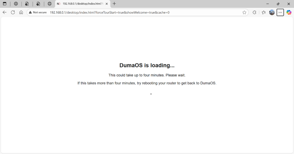

TinyBubu Posted November 15 Author Posted November 15 Hi Fraser, Still struggling with getting it working! Logging on to access the device portal has been an issue for years (since I first owed the device). I actually found this support forum as I did a Google search and found many other users experiencing the exact same problem. For a long while, rebooting the device allowed me to logon (at least long enough to make config changes before the issue reappeared and I was unable to logon yet again). Now rebooting makes absolutely no difference whatsoever! I had actually previously blocked some devices but now can't even logon to unblock them, so those devices are currently unable to access the internet! As requested, I tried to get the logs to assist with troubleshooting, but receive the following: Really not sure where to go from here! Just about given up on DumaOS, as can't continue with a device I can't access or configure. Does the device support SSH to potentially access and reconfigure it that way?
Administrators Netduma Fraser Posted November 15 Administrators Posted November 15 I mean at this point it is unusable for you and so maybe a factory reset is something you should consider, either you don't and it stays like this, in which case you can't use it anyway or you factory reset and there is a chance it's still enabled and if not then you still can't use it so no harm done really. No there isn't SSH access
TinyBubu Posted November 18 Author Posted November 18 Well the modem is usable, just not configurable without being able to consistently logon! I'm presuming it's still doing all the background optimisations, but hard to know without access to the web interface. After my last message, I was actually able to logon for a few minutes (after a hard reset), but then the web interface soon became inaccessible again. Out of frustration, I followed your advice and did do a factory reset. Unsurprisingly, the optimiser module is no longer active. Now I can't even block certain devices (the original reason for this support request!) as the vanilla interface doesn't even offer that rudimentary functionality! I assume the optimiser module is still part of the firmware, so is there any way of getting it activated again (without having the config pushed to the device from Telstra)?
