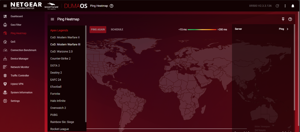

Comp0za Posted August 16 Posted August 16 as you can see, the list is still old, did the resync cloud and still shows old titles. Will there be a fix for it? I'm on the main official firmware version (V2.3.3.136)
Administrators Netduma Fraser Posted August 16 Administrators Posted August 16 I believe if you go back to the beta you should see it has updated, this is because it needs 3.3 for the updated cloud system. The beta update will actually be more up to date than that version even though it appears otherwise
Comp0za Posted August 16 Author Posted August 16 But is the geo filter up to date on my current firmware version? Or do I have to switch over to the beta?
Administrators Netduma Fraser Posted August 16 Administrators Posted August 16 It does appear to be out of date, you will need to go to the beta where it should then be updated, if not let us know
Comp0za Posted August 16 Author Posted August 16 I really do wanna stay on the official firmware from Netgear. So the geo filter is out of date as well?
Administrators Netduma Fraser Posted August 16 Administrators Posted August 16 The Geo-Filter would still work, just some aspects like adding new games would be out of date. I do understand your hesitation, however, I am 99% certain the beta already has the security updates mentioned as when they are fixed are not when they're announced, for example: XR500 2.3.2.134 Official Firmware Released April 13th 2022: https://community.netgear.com/discussions/en-home-nighthawk-pro-gaming-routers/new---xr450xr500-firmware-version-2-3-2-134-released/2213880 XR500 Beta Firmware Based on .134 Released July 24th 2023: https://forum.netduma.com/topic/51611-new-xr500-beta-firmware-33535 Security Advisory for PSV-2023-0039 Released February 1st 2025: https://kb.netgear.com/000066558/Security-Advisory-for-Unauthenticated-RCE-on-Some-WiFi-Routers-PSV-2023-0039 A NTGR administrator posted on the forum February 8th 2025, that they recently released a fix for PSV-2023-0039: https://community.netgear.com/discussions/en-home-nighthawk-pro-gaming-routers/security-advisory-for-unauthenticated-rce-on-some-wifi-routers-psv-2023-0039/2424716 .136 Official Firmware Released March 20th 2025: https://community.netgear.com/discussions/en-home-nighthawk-pro-gaming-routers/new---xr450xr500-firmware-version-2-3-3-136-released/2449110 It was ~3 years between when they fixed PSV-2023-0039 and when they announced it. Our beta version was released over a year later so by that the firmware is still up to date on security for just under another year.

Comp0za Posted October 24 Author Posted October 24 On 8/18/2025 at 6:12 PM, Netduma Fraser said: Yeah I know but what I mean is on the End of Service page that lists all the EoS models it's not there yet so I wouldn't say it's definitive until it appears there also. As above security updates are purely NTGR so it's not something we'd continue With the latest firmware update, the ping heatmap is showing the latest list now. What more did Netgear add to the latest firmware?
Administrators Netduma Fraser Posted October 24 Administrators Posted October 24 1 hour ago, Comp0za said: With the latest firmware update, the ping heatmap is showing the latest list now. What more did Netgear add to the latest firmware? Good to hear, means it has the latest cloud, I don't think they added anything.
