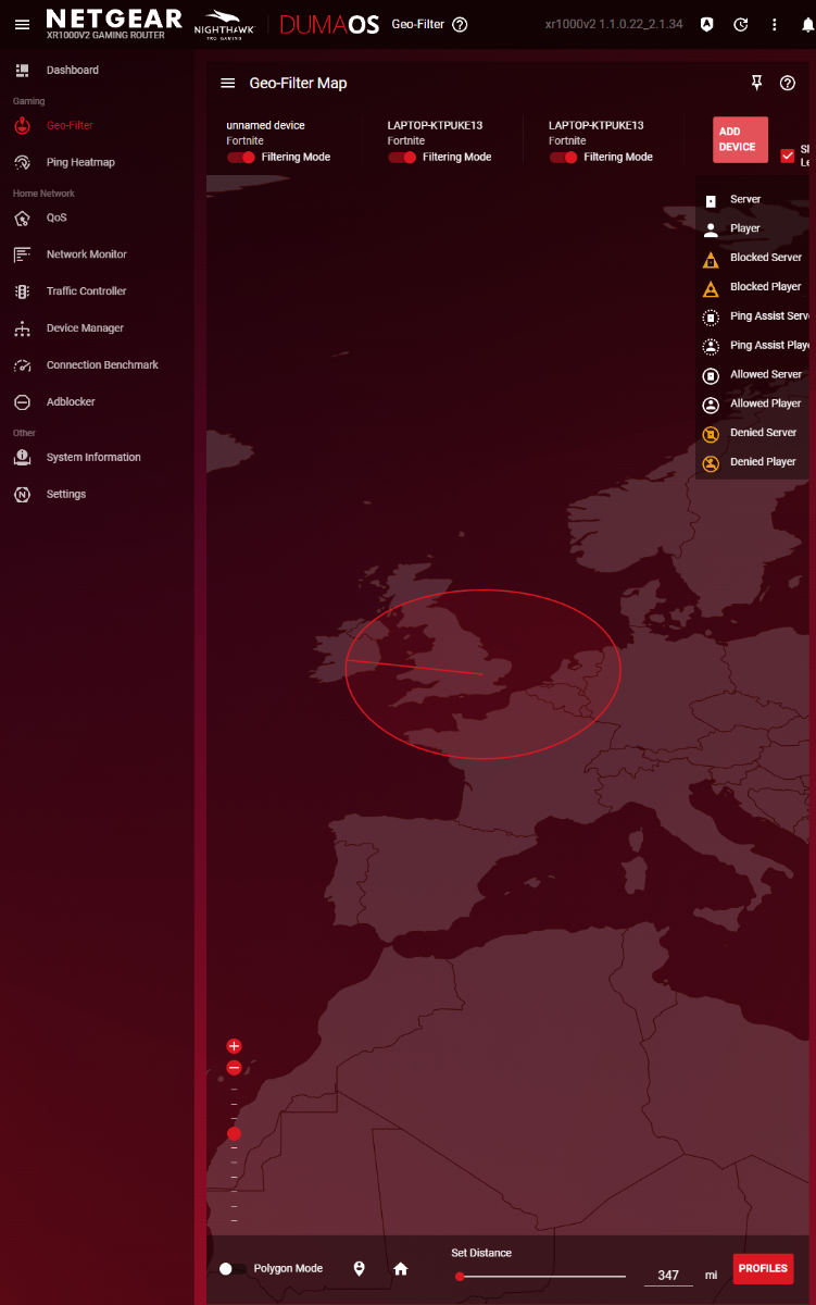

Administrators Netduma Fraser Posted yesterday at 08:09 PM Administrators Posted yesterday at 08:09 PM 10 minutes ago, Seomos17 said: Tested geo filter, geo filter does not wotk, i tried rebooting router, i added device correctly. What platform & game? Can you provide a screenshot of your Geo-Filter page please?
Administrators Netduma Fraser Posted yesterday at 08:22 PM Administrators Posted yesterday at 08:22 PM Do this: Quit the application/game/client completely Remove device from the Geo-Filter Give PC the PlayStation Device Type in the Device Manager Resync from the Geo-Filter Map menu Re-add the device to the Geo-Filter Set up the Geo-Filter how you like Wait 2 minutes Boot up application/game/client It should show more reliably then. However, Fortnite is a weird one, it only tries to connect you to a server when it's actually loading you in to the pre-game run around lobby area and so that's the only time the router can block it which may result in a longer wait to get returned to the game search lobby. It may be faster to toggle filtering mode off, search, wait to see where it shows on the map/what it pings and then quit if needed and re-search.

Seomos17 Posted 6 hours ago Author Posted 6 hours ago I tried a different game the finals, the geo filter doesnt put me in a server thats in my radius but rather a server thats outside my radius when i enter the loading screen it takes a min or 2 to kick me 1/5 times i get into a game.
Administrators Netduma Fraser Posted 6 hours ago Administrators Posted 6 hours ago 32 minutes ago, Seomos17 said: I tried a different game the finals, the geo filter doesnt put me in a server thats in my radius but rather a server thats outside my radius when i enter the loading screen it takes a min or 2 to kick me 1/5 times i get into a game. Make sure you're launching the game client/game after you've set the Geo-Filter up If you change Geo-Filter settings while on the game then restart the game before searching again Ensure strict mode is enabled Ensure Ping Assist is disabled If you do all that it should filter correctly
Administrators Netduma Fraser Posted 4 hours ago Administrators Posted 4 hours ago 57 minutes ago, Seomos17 said: works thank, you , i dont have ping assist tho Ah yes my mistake, glad its working now!
