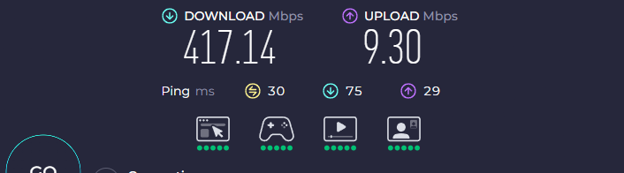

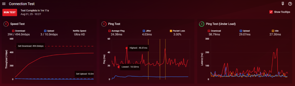

I have the NETGEAR XR500 Gaming Router and it's been a hit or miss at times, but recently I have been noticing some issues with my upload speeds. I would stream to Twitch with a decent 10mbps upload that supported the 2500 bitrate, and I tried streaming to YouTube only to find out some issues with bandwith being inconsistent. I checked OBS and saw my bitrate started fluctuating between 2000 to 1000 and mostly to 200 or 900. I check Ookla's speed test and saw that I have a slightly slower upload, but not too bad since it was at a decent 7-9 upload speed. Downloads are still around 400 which is good since I am paying for 400mbps. However, with netduma os I saw that I am not getting the expected speeds. Tried checking for a firmware update, but there aren't any available at the moment. Not sure if the Router is starting to fail or isn't compatible with current speeds. I have the QoS completely disabled, so I can get my full speeds. However, that hasn't improved my speeds.
Ookla Speed Test
Downloads: 417.14mbps
Uploads: 9.30mbps

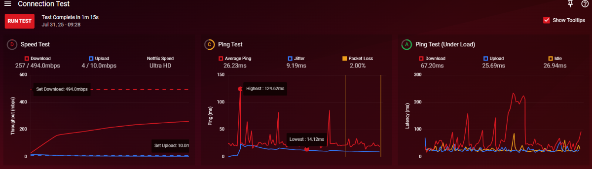

Netduma OS
Downloads: 394mbps (sometimes 257mbps)
Uploads: 3mbps

You can ignore the speed test on the router, if the router was limiting your speeds then you wouldn't be able to get higher upload on Ookla.
Having QoS completely disabled however is likely responsible for the fluctuating bitrate issue you're experiencing. I know you don't have much upload to play with so try it on 90% for example and see if you notice any improvements - do also lower download to 70%.
