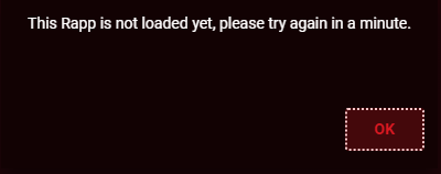

Mercy Posted July 22, 2025 Posted July 22, 2025 I have done a factory reset as ive read that may fix the issue. Tested both Rapps once it was reset w/ a basic setup and everything worked. When i uploaded my saved router settings they dont work again and i keep getting this message

Mercy Posted July 29, 2025 Author Posted July 29, 2025 I cant adjust the congestion control percentages because the QoS Rapp will never load.
Administrators Netduma Fraser Posted July 29, 2025 Administrators Posted July 29, 2025 On the System Information page click the icon on the Rapps panel, change retries to 5, reboot the router from the interface, close the tab, wait 4 minutes then access and see if it loads
Mercy Posted July 29, 2025 Author Posted July 29, 2025 Both Rapps still wont load. Connection Benchmark isnt a big deal, but i use the Congestion Control in QoS for online gaming so its unfortunate it doesnt work still
Administrators Netduma Fraser Posted July 29, 2025 Administrators Posted July 29, 2025 Downgrade the firmware to: V1 - https://kb.netgear.com/000066233 V2 - https://kb.netgear.com/000065516 Factory reset, wait 4 minutes then see if it loads. If so disable auto upgrade on the firmware update page.
Mercy Posted August 4, 2025 Author Posted August 4, 2025 I did a factory reset and just manually changed my settings vs uploading them and both Rapps are working normal again. Seems there is an issue when uploading my saved settings that causes the Rapps to not work correctly
Administrators Netduma Fraser Posted August 4, 2025 Administrators Posted August 4, 2025 Good to hear, thanks for the update. Ah so you're restoring from a backup, that can cause issues if the backup is corrupted or if you made the backup on a previous version and upload it on a newer version.
