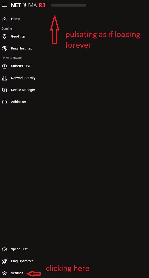

FingerTester Posted July 15, 2025 Author Posted July 15, 2025 7 hours ago, Netduma Fraser said: The side menu should still be clickable and the pages that aren't having the issues should still load. Logs are in Settings > Troubleshooting. First upgrade to the Early Access version here: https://forum.netduma.com/forum/151-netduma-r3-early-access/ If it still happens after that then grab the logs please This is what happens when I try to get logs or update the router.
Administrators Netduma Fraser Posted July 15, 2025 Administrators Posted July 15, 2025 What web browser/device are you using to access? Can you access the pages using the DumaOS app?
FingerTester Posted July 15, 2025 Author Posted July 15, 2025 33 minutes ago, Netduma Fraser said: What web browser/device are you using to access? Can you access the pages using the DumaOS app? Tried edge, chrome, and a chromium fork. All three have the same issue. App just says "Unknown error" when I try to log in.
Administrators Netduma Fraser Posted July 15, 2025 Administrators Posted July 15, 2025 Go here: http://192.168.77.1/dumaweb#!/support and you should be able to upload the firmware there to upgrade
FingerTester Posted July 15, 2025 Author Posted July 15, 2025 5 minutes ago, Netduma Fraser said: Go here: http://192.168.77.1/dumaweb#!/support and you should be able to upload the firmware there to upgrade I get the same error then I hit continue anyway and it just loads forever the same as my previous image.
