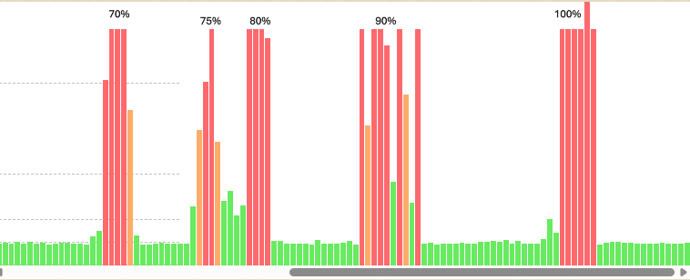

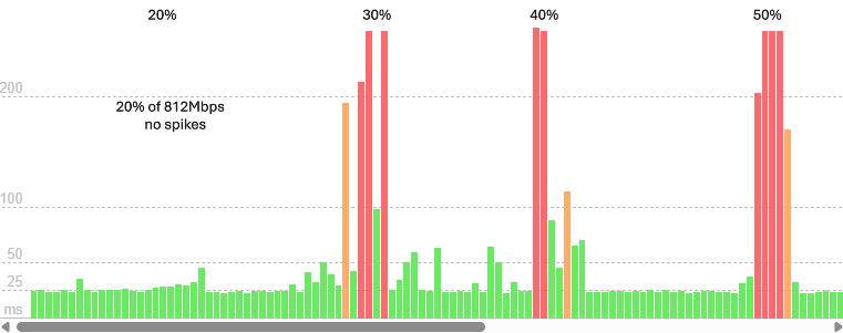

talbyfish Posted July 4 Author Posted July 4 I use a site called pingcanbeusefull.com i have tested the ping at on 100% 80% 60% 40% and 20% of download speed. I have to take it down to 20% before i get the desired results, see below:
talbyfish Posted July 4 Author Posted July 4 These tests are done doing a speed test on another devce which only reaches 250Mbps Tests are fine when streaming on another device its just downloads.
