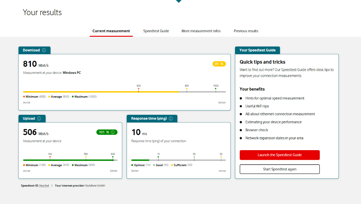

When I connect using the Fritz!Box 7490, I get the full contracted speed of 1 Gbit/s down and 500 Mbit/s up. However, when using the Netduma R3 with the exact same PPPoE credentials and VLAN configuration, I only reach about 770 Mbit/s download, although the upload remains close to expected.
This suggests the issue lies with the Netduma R3 itself, possibly in how it handles PPPoE or VLAN tagging under high throughput conditions.

These are very good speeds behind PPPoE/Vlan with the R3! Welcome back!
VLAN and PPPoE are recurring topics, but the team ND is working on a solution.
For now, the best thing to do is let the modem/router manage the PPPoE/VLAN internet access and set the R3 to DHCP.
I work like this and I don't have double NAT!;)

We are aware speeds are slightly slower using PPPoE and we'll improve that if we can. Otherwise you can put the R3 in the exposed host on the Fritz instead and have the fritz handle PPPoE as mentioned above and then you should get better speeds through the R3.
