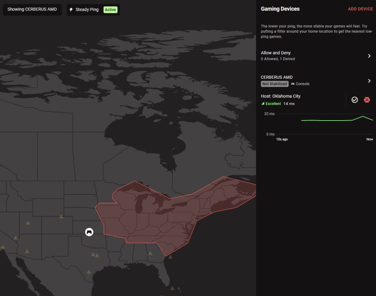

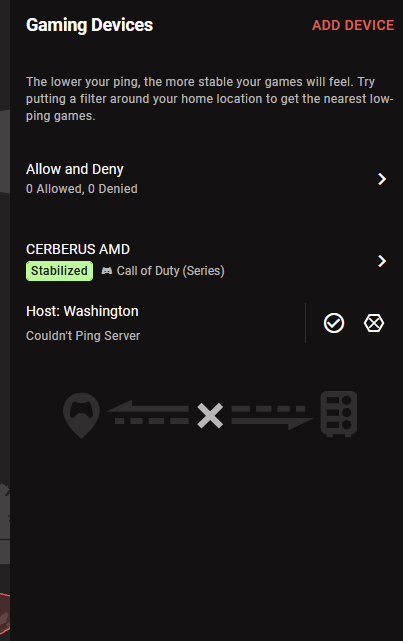

steelcity403 Posted July 1 Posted July 1 This is all it does the entire time. Any idea how to fix this?

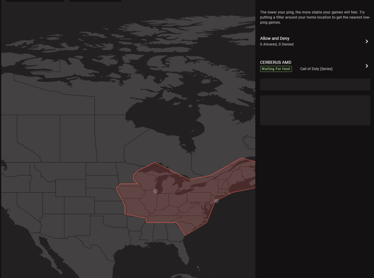

Administrators Netduma Fraser Posted July 1 Administrators Posted July 1 Do this: Quit the application/game/client completely Remove device from the Geo-Filter Give PC PlayStation Device Type in the Device Manager Resync from the Geo-Filter Map menu Re-add the device to the Geo-Filter Set up the Geo-Filter how you like Wait 2 minutes Boot up application/game/client It should work better then

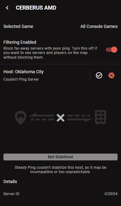

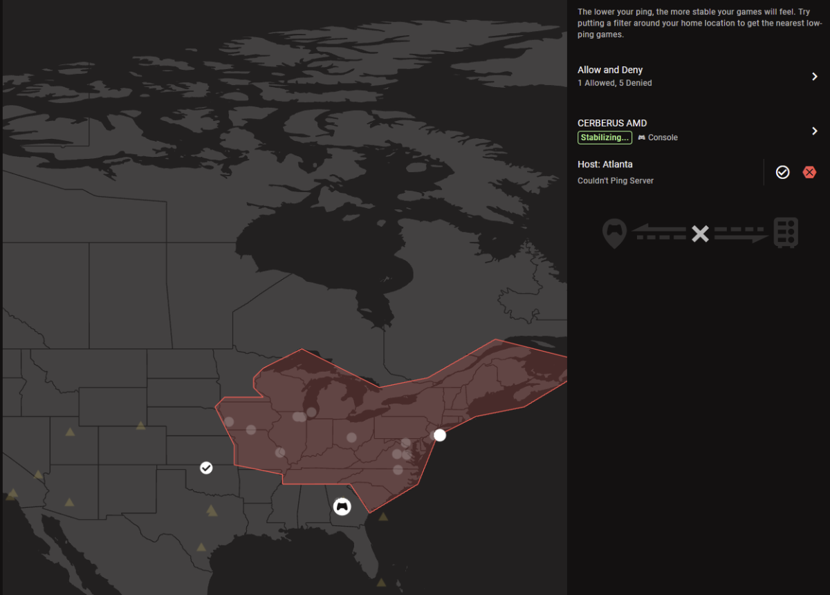

steelcity403 Posted Tuesday at 04:53 AM Author Posted Tuesday at 04:53 AM Followed the instructions YOu gave and steady ping is still not working. This is what I get...

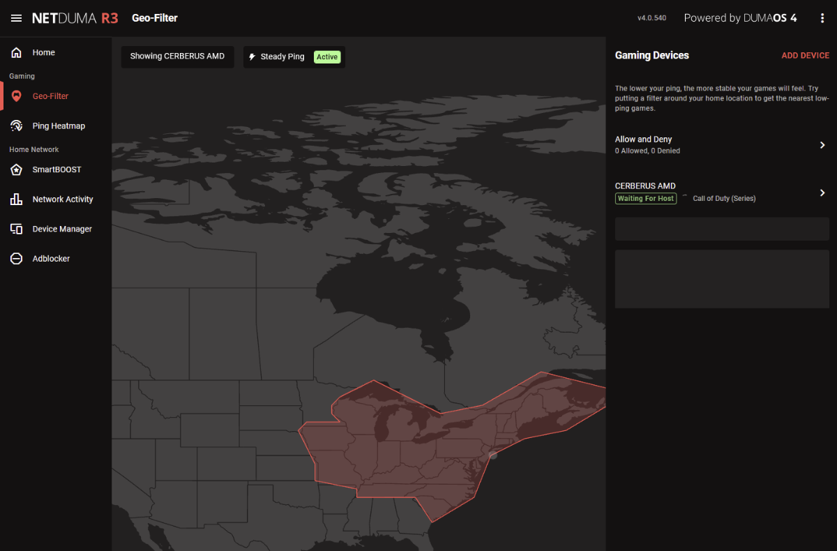

Administrators Netduma Fraser Posted Tuesday at 02:14 PM Administrators Posted Tuesday at 02:14 PM If it can't ping the server then it won't be able to apply Steady Ping. Game servers don't respond to ping requests so this can happen. I also see you didn't follow the instructions fully as the PC has still been added to the Geo-Filter by selecting CoD but it should auto add as a console after changing the PC device type in the Device Manager. If you didn't understand that part just let us know.

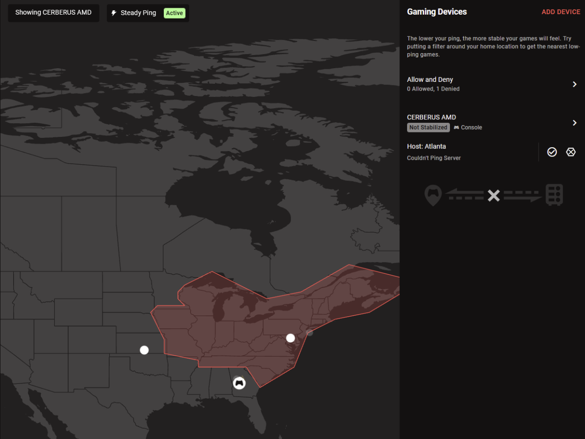

steelcity403 Posted Wednesday at 04:23 AM Author Posted Wednesday at 04:23 AM OK so I fixed that but it is now finding servers outside my boundaries. Strict mode is on and it still seems like there are a lot of servers that it can't ping
iOrcus Posted Wednesday at 08:04 PM Posted Wednesday at 08:04 PM How did you fixed? I feel like steady ping is VERY inconsistent for me. @steelcity403
steelcity403 Posted 17 hours ago Author Posted 17 hours ago Still can't get Steady ping to work consistently and I am still being connected to servers outside of my geofence...

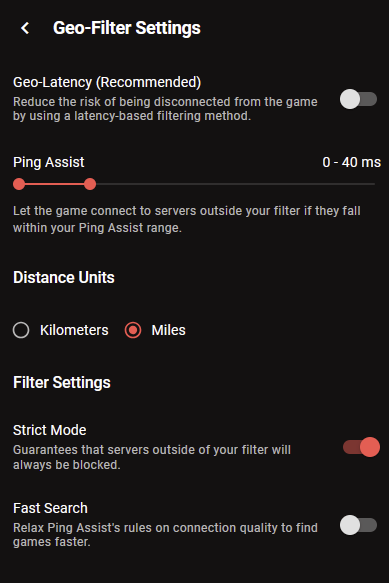

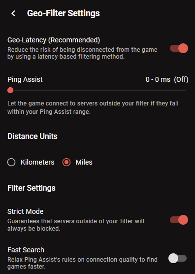

Nj12 Posted 11 hours ago Posted 11 hours ago 6 hours ago, steelcity403 said: Still can't get Steady ping to work consistently and I am still being connected to servers outside of my geofence... Turn off geo latency.
Administrators Netduma Fraser Posted 9 hours ago Administrators Posted 9 hours ago As above turn off Geo-Latency, reboot then try it again. If it can't ping or if the server ping method shows as traced then it's unlikely to be able to apply Steady Ping.
