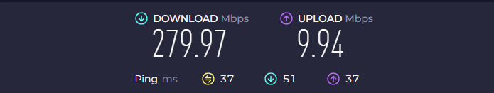

Simon Thomas Posted July 1, 2025 Author Posted July 1, 2025 Yes the same issue with speedtest.net. See below, don in quick succession, my speeds are all over the place. Dont know why this has happened out of the blue. I pay for 900 down and 50 up and congestion control is set to 100% for each. Yes it drops on all devices.

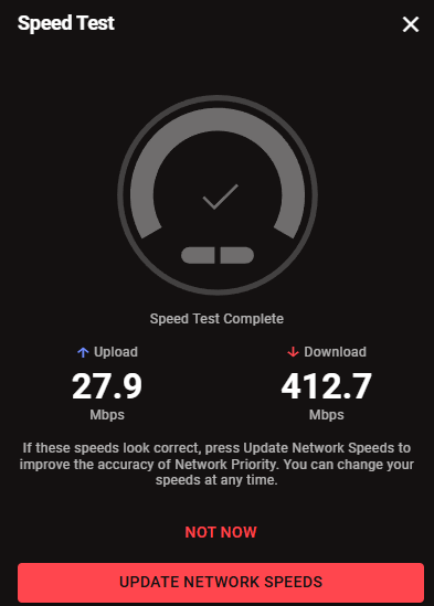

Simon Thomas Posted July 6, 2025 Author Posted July 6, 2025 Thanks! The speedtest.net test I ran just now is at odds with my 950mbps down and 50mbps upload speeds from my ISP. You'll notice in the third recording in the 3rd attempt to run the speed stest the mbps went from approx 930 down to 1.5 and back up again which is bizarre. Like i said earlier this happened out of the blue, and theres no issue when bypassing the R3 from the NBN box modem directly to the PC. Recording 2025-07-06 202603.mp4 Recording 2025-07-06 203013.mp4 Recording 2025-07-06 203258.mp4

Krush Posted July 6, 2025 Posted July 6, 2025 The R3 speed test is performed directly from the WAN... It doesn't take into account the R3's QoS settings, which are linked to the LAN/WLAN! Is the Ookla speed test LAN or WLAN behind the R3?
