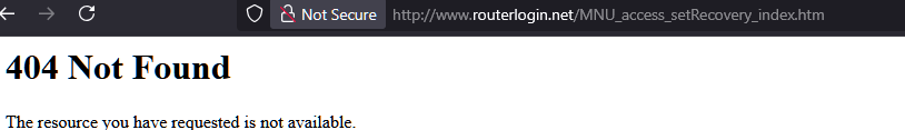

Heroxoot Posted June 28, 2025 Posted June 28, 2025 I just rebooted my router and it REFUSES the password I've used for a year now. So now I have to factory reset my router to get in because the PW reset pages DONT LOAD. I don't know who makes the firmware for the XR1000 but you should be fired. About to just switch to an ASUS router.
Administrators Netduma Fraser Posted June 28, 2025 Administrators Posted June 28, 2025 How did you reboot the router exactly? If you unplugged the power suddenly that can make it lose saved settings. If that was it then make your changes then reboot from the interface and that will act as a hard save should it be unplugged in future.
Heroxoot Posted June 28, 2025 Author Posted June 28, 2025 9 minutes ago, Netduma Fraser said: How did you reboot the router exactly? If you unplugged the power suddenly that can make it lose saved settings. If that was it then make your changes then reboot from the interface and that will act as a hard save should it be unplugged in future. I rebooted the router using the nighthawk app. Then this crap started so I pulled the plug just for it to say my password is wrong. I finally get through the start up settings after a factory reset AND IT WONT EVEN START UP NOW. Says 192.168.1.1 isn't reachable. I've about had it with Duma and their junk OS. My XR450 never had this much issues.

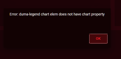

Heroxoot Posted June 28, 2025 Author Posted June 28, 2025 Now im constantly getting this message and "Script failed". I think this thing needs new firmware or a reflash because there's no way it should be like this. I've had issues on and off for the year I've had this router.
Administrators Netduma Fraser Posted June 28, 2025 Administrators Posted June 28, 2025 The password setup is an NG feature, nothing to do with us. It's possible the IP to access is 10.0.0.1 if your ISP router uses 192.168.1.1 for its login. That looks like the browser is forcing a connection using HTTPS, in which case disable that in browser settings or a browser based Adblocker is blocking parts of the interface, in which case disable/whitelist the interface
Heroxoot Posted June 28, 2025 Author Posted June 28, 2025 9 minutes ago, Netduma Fraser said: The password setup is an NG feature, nothing to do with us. It's possible the IP to access is 10.0.0.1 if your ISP router uses 192.168.1.1 for its login. That looks like the browser is forcing a connection using HTTPS, in which case disable that in browser settings or a browser based Adblocker is blocking parts of the interface, in which case disable/whitelist the interface I refreshed the page and it stopped giving me errors. I have no router/modem from the ISP because I have Fiber. Adblock/Noscript were disabled at this time.
