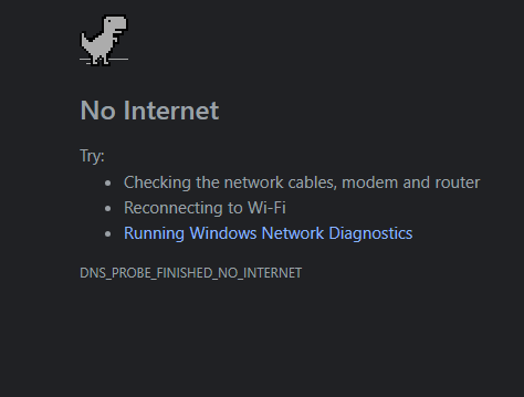

azleb Posted June 25 Posted June 25 Hi all, I'm running into a frustrating issue with my router since updating to firmware version 4.0.540. Whenever I download at max speed (~900Mbps), the internet drops and I get a DNS error. The only way to restore the connection is by rebooting the router. This happens consistently during high-speed downloads. Has anyone experienced this or know of a fix? Could this be a firmware bug, DNS issue, or something else? Any suggestions or other troubleshooting steps would be greatly appreciated! Cheers, Azleb

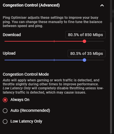

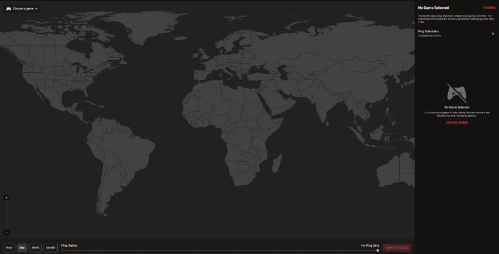

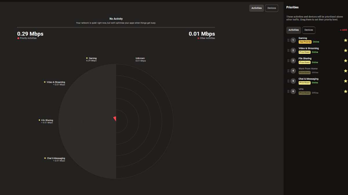

Administrators Netduma Fraser Posted June 26 Administrators Posted June 26 All good thanks, hope you are too! How did/do you have Congestion Control/SmartBOOST set though? Did you reboot the router? If so did you get the log after the reboot? Looks like that's what happened but If not, what time did it happen approximately?
azleb Posted June 26 Author Posted June 26 I have attached the images of my setup It happened just before the reboot; the internet won't go back online unless I do the reboot. I thought it would be good to capture that in the logs
Administrators Netduma Fraser Posted June 27 Administrators Posted June 27 Remove the File Sharing priority and monitor it. Congestion Control can be found in Ping Optimizer > Advanced. If you could grab the logs before the reboot that would be great, otherwise the risk is that the logs pertaining to the issue are lost which is what happened there

Administrators Netduma Fraser Posted June 30 Administrators Posted June 30 No it won't be that, the error on the web browser is a standard no internet message. DNS maps domain names e.g. Google.com to IP addresses e.g. 8.8.8.8 so that when you go to Google.com you get connected to the 8.8.8.8 IP address and the content is displayed. With no internet that DNS process can't happen which is all it's really saying, I've tried to determine the IP address of this website you want to connect to but I'm unable to. azleb 1
