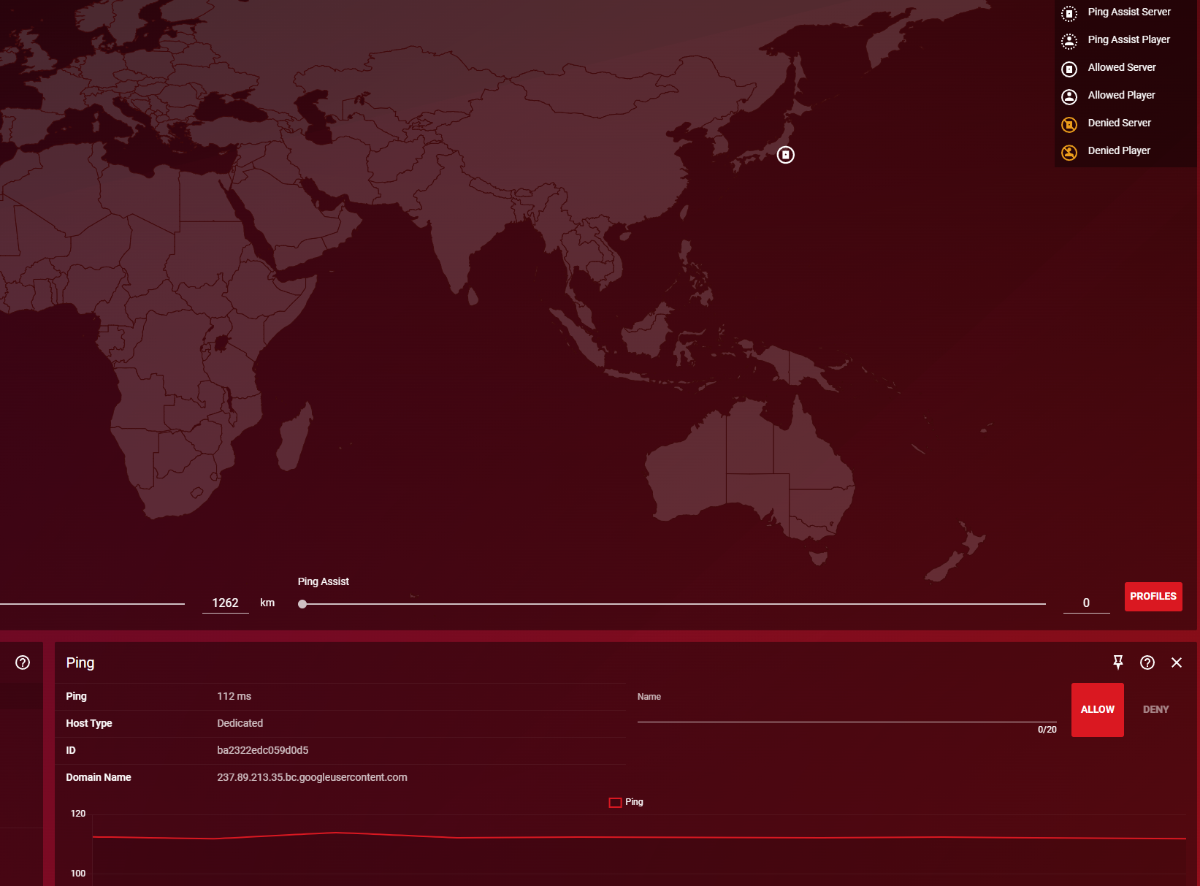

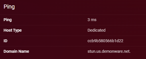

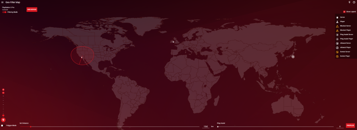

J29 Posted June 22 Author Posted June 22 First image is me loading up the game and second is when im searching. It keeps trying to connect me to Japan servers and will refuse to connect me to west coast even though I've blocked every Japan server possible after a long wait it forces me to play in it anyways
Administrators Netduma Fraser Posted June 22 Administrators Posted June 22 Which CoD are you playing specifically? Seems like it's using the server within your radius to relay you to the one in Japan. If you ping the Japan one you get/are playing on, what does the Geo-Filter show the ping as? What does the ping show in game?
J29 Posted June 23 Author Posted June 23 Black Ops 6 Ping is anywhere from 100-150 for both Router and Game, sometimes it shows me connecting to the dublin server which i thought was just an authentication one but ping is the same as the Japan ones and so are the player names.

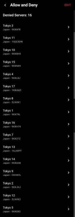

Administrators Netduma Fraser Posted June 23 Administrators Posted June 23 11 hours ago, J29 said: Black Ops 6 Ping is anywhere from 100-150 for both Router and Game, sometimes it shows me connecting to the dublin server which i thought was just an authentication one but ping is the same as the Japan ones and so are the player names. The Ireland one definitely is an authentication server, though it could be mislocated on the map, if you provide the ID I can check it. It's possible the Japan one could be authentication as well which would explain why you're getting longer waits if you're blocking all of them. Having a look at the servers, it's a mix of Google, Microsoft & Vultr, Vultr will definitely be a game server, the others could be game servers or authentication servers, it's hard to say. Delete all your blocked servers other than these: 15DEXDW 1K8U6ZI 1AJ48YF CKHXVL These are the Vultr ones so almost certainly game servers. See if the search takes as long and if you start getting games closer to home. Also what router and firmware version are you on?

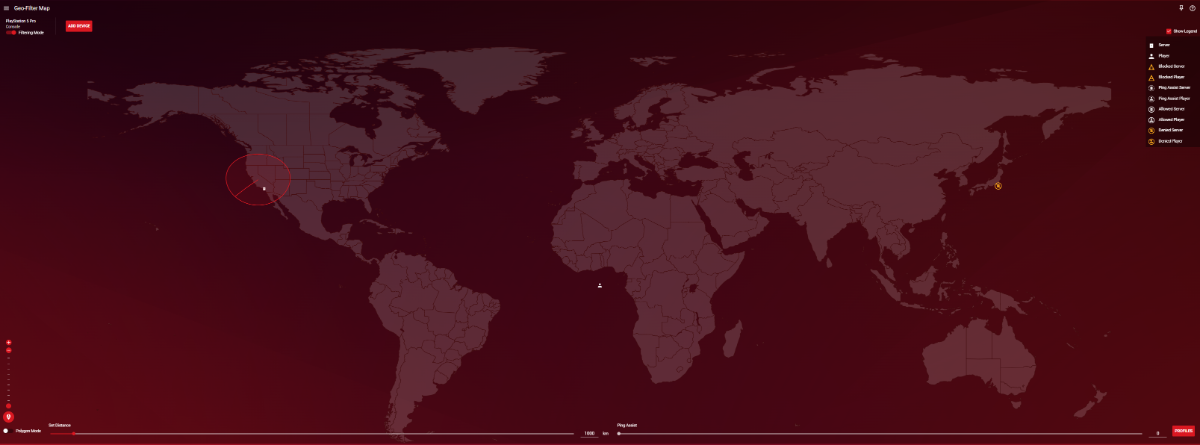

J29 Posted June 24 Author Posted June 24 Quote Deleted all the servers but the four you mentioned and the wait times did improve but I think that's because it connected me to the blocked servers faster. XR500 on V2.3.3.136 Image of my search with the Dublin server and the Japan one I connected to that's no longer blocked.
Administrators Netduma Fraser Posted June 24 Administrators Posted June 24 It appears to be whitelisted by us so I'll need to pass it on to the team to see if they need to be removed
J29 Posted June 25 Author Posted June 25 Thanks and yeah most of the Japan ones are listed as "Allowed Server"
Administrators Netduma Fraser Posted June 26 Administrators Posted June 26 Okay that does sound like we've done it then, someone else is having the same issue so I think it probably is that. I'll pass this ID over to help getting it resolved.
