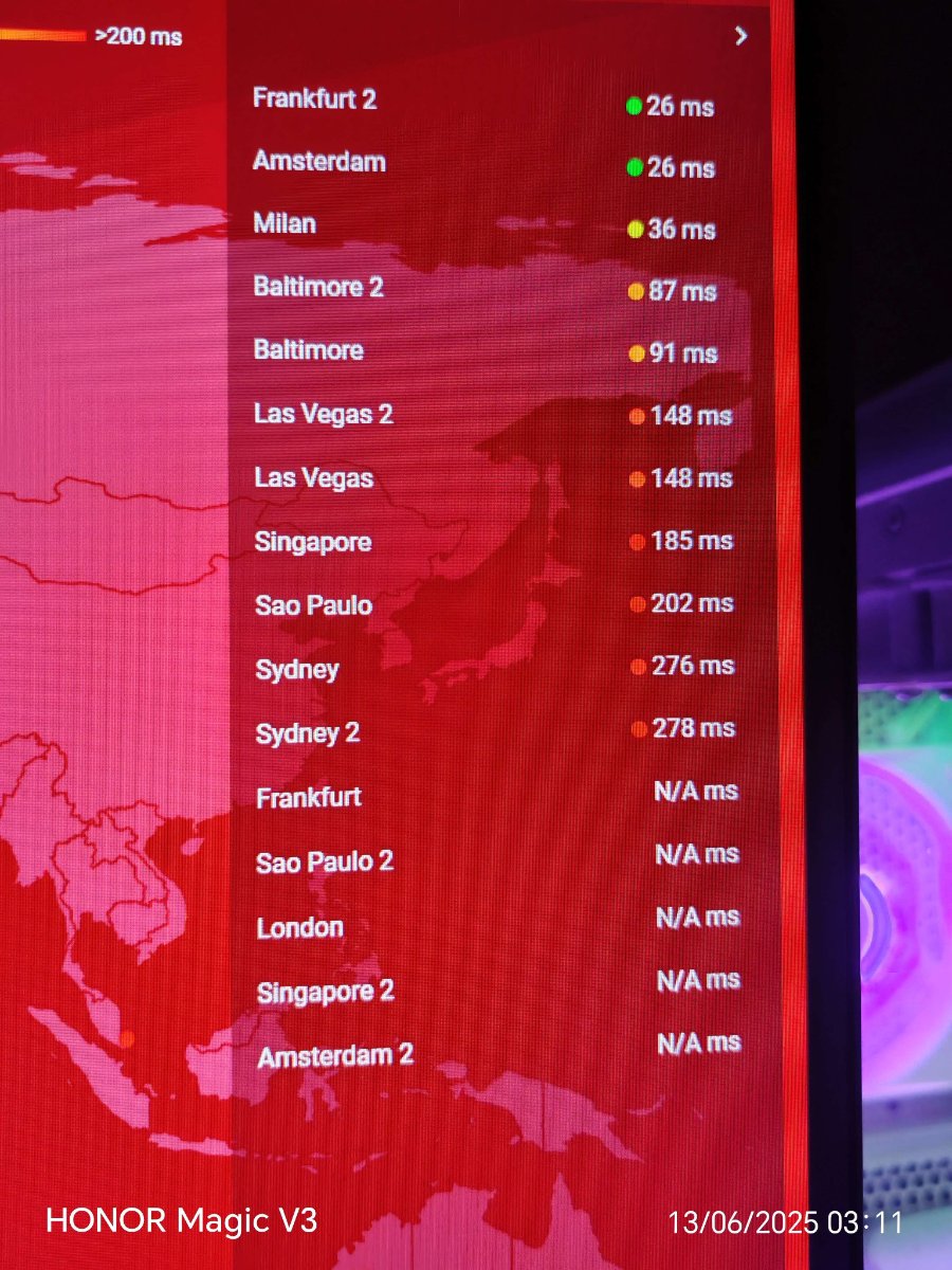

Thorkay Posted June 13, 2025 Author Posted June 13, 2025 @Netduma Fraser I also noticed this to with Geo & splitgate and have added it as i normally should do sometimes its like its not picking the game up .. Searching for matches with a radius with all closest local servers takes longer to find match then without using the duma should be other way round ... I have tested other games like cod they are fine for me seems its only splitgate could this be due to them having lower amount of servers i also notice some show N/A on ping map not all are showing the correct data or ping sometimes servers will be online next time you check they are N/A
sw3ar Posted June 13, 2025 Posted June 13, 2025 44 minutes ago, Netduma Fraser said: Make sure you've set the Geo-Filter for your device before you've launched the game/steam, then start it and check again. If not, check the IP on the device itself then double check it against the IP for the device you think it is on the Device Manager and see if they match Everything is correct. I remember at CoD it was something on your end. You changed something and it started to show up again (server icon, ping, online in SB)
Administrators Netduma Fraser Posted June 13, 2025 Administrators Posted June 13, 2025 1 hour ago, Thorkay said: @Netduma Fraser I also noticed this to with Geo & splitgate and have added it as i normally should do sometimes its like its not picking the game up .. Searching for matches with a radius with all closest local servers takes longer to find match then without using the duma should be other way round ... I have tested other games like cod they are fine for me seems its only splitgate could this be due to them having lower amount of servers i also notice some show N/A on ping map not all are showing the correct data or ping sometimes servers will be online next time you check they are N/A You're restricting the amount of servers available to play on so this would always make the search slower, never faster, you're correct in that a game like CoD where they have a huge amount of servers this increase in search time isn't felt but that's not the norm, for a game with fewer servers the search time would be increased. We'll just need to update the servers on heatmap, it won't be affecting the Geo-Filter aspect Thorkay 1

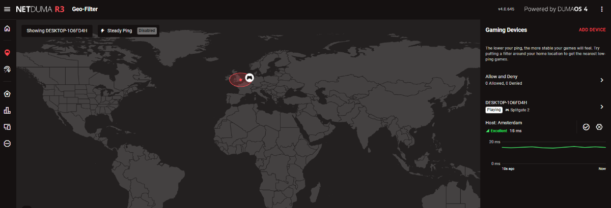

Administrators Netduma Fraser Posted June 16, 2025 Administrators Posted June 16, 2025 Mine seems to be working fine, Steam was already open in the System Tray but then I added my PC to the Geo-Filter and launched the game. Important to note, it doesn't show servers being blocked/allowed like you might be used to with Call of Duty for example, it just shows the game in your radius when you get one, the screenshot above in game is when it first showed for me

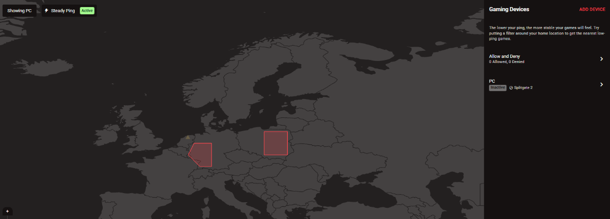

sw3ar Posted June 17, 2025 Posted June 17, 2025 15 hours ago, Netduma Fraser said: Mine seems to be working fine, Steam was already open in the System Tray but then I added my PC to the Geo-Filter and launched the game. Important to note, it doesn't show servers being blocked/allowed like you might be used to with Call of Duty for example, it just shows the game in your radius when you get one, the screenshot above in game is when it first showed for me This is mine. Don't know why it doesn't work. I took that screenshot while in-match.
Administrators Netduma Fraser Posted June 17, 2025 Administrators Posted June 17, 2025 3 hours ago, sw3ar said: This is mine. Don't know why it doesn't work. I took that screenshot while in-match. There is a blocked icon on the map there so it is showing servers, zoom out fully and see if anything appears, if not try with the normal radius mode instead
sw3ar Posted June 17, 2025 Posted June 17, 2025 30 minutes ago, Netduma Fraser said: There is a blocked icon on the map there so it is showing servers, zoom out fully and see if anything appears, if not try with the normal radius mode instead I took that screenshot while I was in the match, there should be server location. With normal radius is the same.
Administrators Netduma Fraser Posted June 17, 2025 Administrators Posted June 17, 2025 Yes there should be, it is detecting servers though, is there nothing other than that blocked triangle that appears on the map when zoomed out? Does that blocked triangle appear during the entire match? Ping it manually, what ping do you get?
sw3ar Posted June 17, 2025 Posted June 17, 2025 There is just that triangle. Yes, entire match. Best ping is 29 for Frankfurt on Heatmap. Maybe I need to do factory reset?
Administrators Netduma Fraser Posted June 17, 2025 Administrators Posted June 17, 2025 Not the Heatmap ping, what does the blocked triangle ping at? Factory reset certainly wouldn't hurt
Administrators Netduma Fraser Posted June 17, 2025 Administrators Posted June 17, 2025 That likely is the server you're playing on then, why it appears blocked and still allowing you through is a bit odd - feels like there must be another server it is relaying you to get that server. Do this: Do this: Quit the application/game/client completely Remove device from the Geo-Filter Give PC PlayStation Device Type in the Device Manager Resync from the Geo-Filter Map menu Re-add the device to the Geo-Filter Set up the Geo-Filter how you like Wait 2 minutes Boot up application/game/client Does it behave more as you would expect after that?
