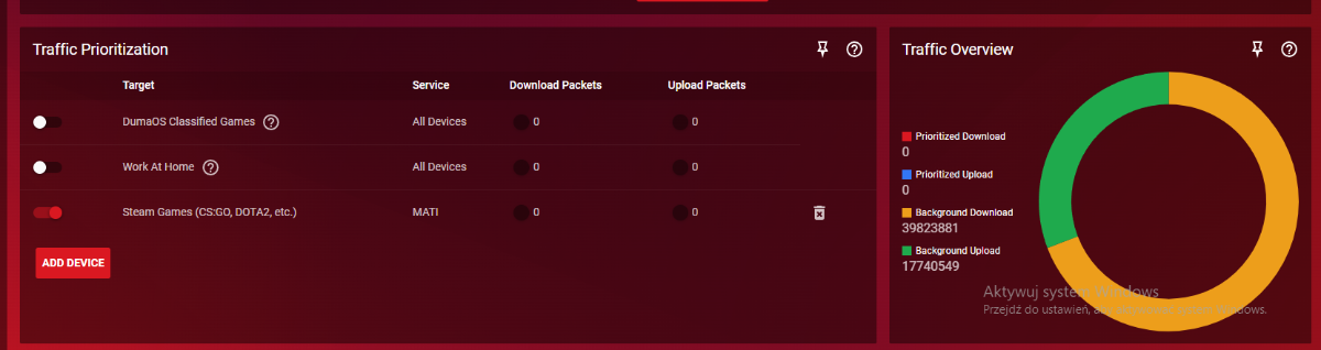

Ex1st Posted May 29, 2025 Posted May 29, 2025 When I set in traffic prioritization target for cs2 it doesn't work and my cs2 doesn't work better. I have consistent 0,4-0,8% packet loss spikes during game. I think I have tried every setup to remove these spikes, but nothing is working. Are there any specific settings for cs2 to work better?
Administrators Netduma Fraser Posted May 29, 2025 Administrators Posted May 29, 2025 Remove the rule and add your device with the Games Console service instead, does it work then?
Ex1st Posted May 29, 2025 Author Posted May 29, 2025 It's working(i have slightly better ping), but i still have 0,4-0,8% loss spikes. Can i do something else to fix that?
