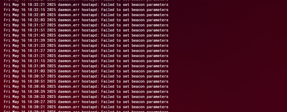

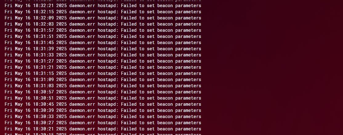

schmizzbeats Posted May 16, 2025 Author Posted May 16, 2025 keep seeing this in the logs, can't go back to the exact time that it happened, but next it does, I will screenshot the log and add to reply
Administrators Netduma Fraser Posted May 17, 2025 Administrators Posted May 17, 2025 That won't be it, if you could download the log from the log panel next time that would be better
