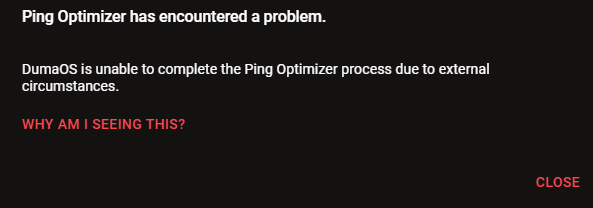

SaTaM_J Posted May 9 Author Posted May 9 Hi again, thanks for following up. Here are the details based on your questions: My R3 is connected via cable to a Huawei HG8245W5 modem. The R3 is placed in the DMZ of the modem to ensure full traffic flow. All my devices, including PCs, phones, iPad, and the TCL Smart TV, are connected through the R3. I subscribe to a 300 Mbps down / 100 Mbps up internet plan and consistently reach those speeds on other devices. The smart TV, however, is stuck at around 32 Mbps and streaming apps (e.g. Netflix) don't function properly. I’ve already tried DMZ, DNS changes, SmartBOOST prioritization, and more — nothing has fixed the issue. Also, the Ping Optimizer tab does not load properly (I’ve attached a screenshot). Appreciate your help in resolving this — let me know if you need further logs or testing.
Administrators Netduma Fraser Posted May 9 Administrators Posted May 9 You don't need to run Ping Optimizer, you just click on it and go to advanced straight away. Split the WiFi bands and have it connect directly to 5GHz, does it get better speeds and work better then?

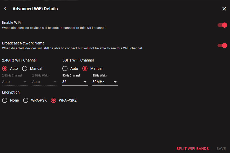

Krush Posted May 10 Posted May 10 Just for your information, TCL TVs are limited to channels 36 to 48 on the 5 GHz band at 80 MHz. ---Without splitting the bands, I simply adjust the 5 GHz band manually.--- Netduma Fraser 1

SaTaM_J Posted May 10 Author Posted May 10 I Tried adjusting the values as listed above manually and still it didn’t worked.

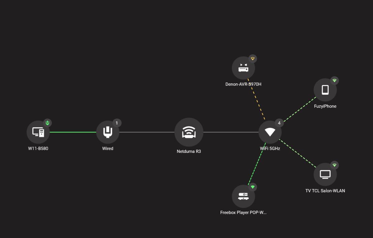

Krush Posted May 10 Posted May 10 By the way, what Android app do you use to test the speed on your TCL TV? Mine, a 65-inch TV, is 5 meters from the R3 in another room, and I get 200/150 Mbps... according to analytics. Smaller models, like the 80cm TV TCL, don't have the 5GHz band, (I took 2 for the family) and another of 107cm which has the 5GHz band. What model do you have? ---All 4 work fine for streaming---
