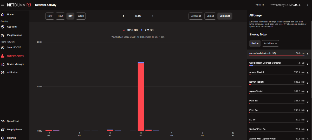

thisisreallife Posted April 29, 2025 Posted April 29, 2025 I can't add it to my Geo-Filter or anything.
Administrators Netduma Fraser Posted April 29, 2025 Administrators Posted April 29, 2025 Could you provide a screenshot of where you're seeing that please? What happens when you try to add it?
thisisreallife Posted April 29, 2025 Author Posted April 29, 2025 9 minutes ago, Netduma Fraser said: Could you provide a screenshot of where you're seeing that please? What happens when you try to add it? When I add it and go back to this page, it's gone back to unresolved device.
Administrators Netduma Fraser Posted April 29, 2025 Administrators Posted April 29, 2025 That's likely BI not able to determine what it is. Does it appear on the Device Manager in the same way? If you re-name it and give it the correct device type can you add it to Geo-Filter and it works?
thisisreallife Posted April 29, 2025 Author Posted April 29, 2025 25 minutes ago, Netduma Fraser said: That's likely BI not able to determine what it is. Does it appear on the Device Manager in the same way? If you re-name it and give it the correct device type can you add it to Geo-Filter and it works? Hello Unfortunately it doesn't appear under Device Manager at all.
Administrators Netduma Fraser Posted April 29, 2025 Administrators Posted April 29, 2025 1 hour ago, thisisreallife said: Hello Unfortunately it doesn't appear under Device Manager at all. If you check the IP on the console then check any unnamed devices on the Device Manager can you find a match?
thisisreallife Posted May 2, 2025 Author Posted May 2, 2025 On 4/29/2025 at 5:38 PM, Netduma Fraser said: If you check the IP on the console then check any unnamed devices on the Device Manager can you find a match? So I went to Network > View connection status and found my PS5 IP Address. I then found it on Netduma and named it. However I still can't do anything with it. I run a 'speed test' and it doesn't appear under network activity (when I click on "now"). I can download a full 100gb game and nothing appears. I can 'block' the device but can still do a speed test, I can still play online. I've added it on Geo-Filter and it nothing happens when I run the game.
