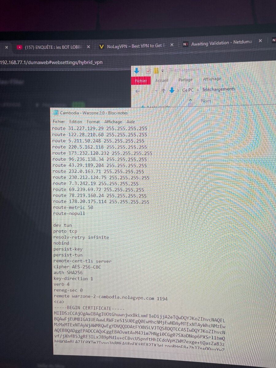

Administrators Netduma Fraser Posted April 29 Administrators Share Posted April 29 7 hours ago, AizZeR said: Bonjour, J’ai coller ceci dans configuration vpn est ce que c’était la chose à faire ? Car je suis connecter sur mon vpn (nolag) en revanche quand j’essaie de trouver une partie je n’y arrive pas donc je me dis que j’ai raté quelque chose There are too many servers listed in that config so the router won't know which one you want to connect to. Remove all but one of the router line entries and try again. Link to comment Share on other sites More sharing options...
AizZeR Posted April 30 Share Posted April 30 Ok je vais essayer merci Link to comment Share on other sites More sharing options...
AizZeR Posted April 30 Share Posted April 30 J’ai fais ce que tu m’as dis je n’ai laissé qu’une seul IP Si tu as des réponses impossible de se connecter Link to comment Share on other sites More sharing options...

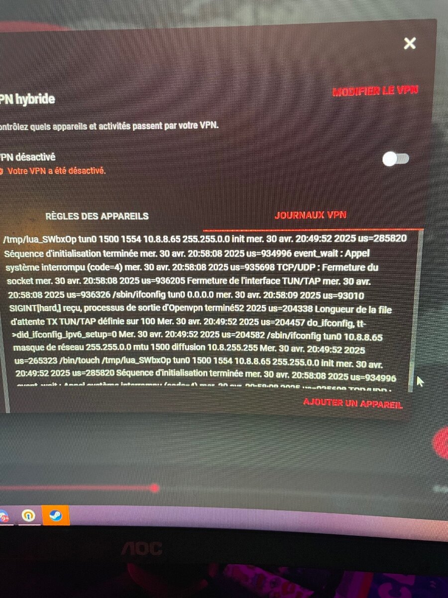

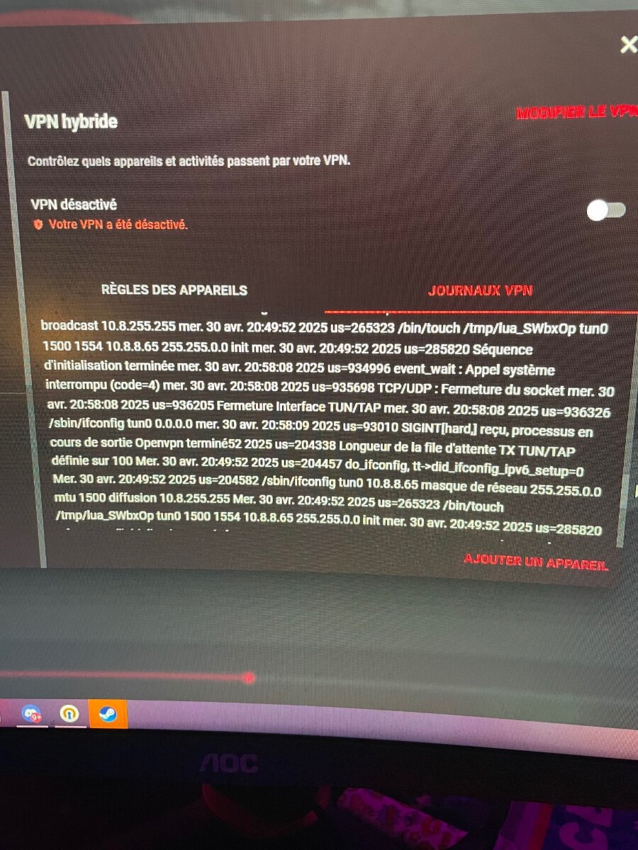

Administrators Netduma Fraser Posted May 1 Administrators Share Posted May 1 Could you provide the entire VPN log please? Link to comment Share on other sites More sharing options...

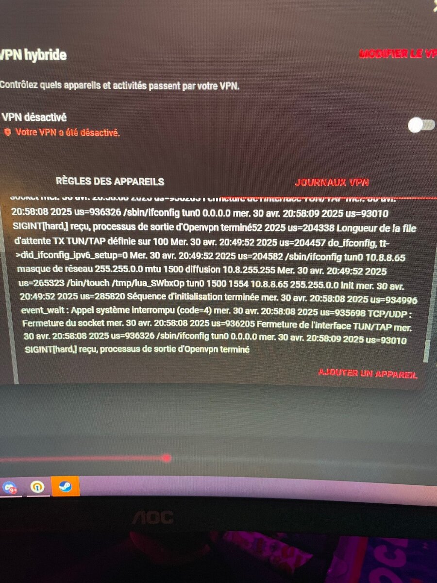

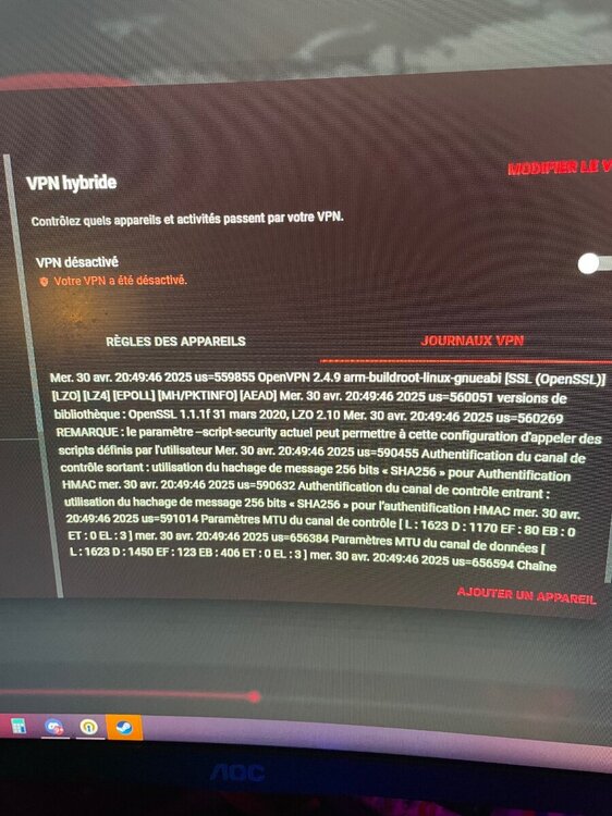

AizZeR Posted May 1 Share Posted May 1 J’espère que ça va aider à trouver quoi faire 😅 Link to comment Share on other sites More sharing options...
Administrators Netduma Fraser Posted May 1 Administrators Share Posted May 1 Not really - copy and paste would be easier next time - it's also in French which I can't read 😂Just to clarify, are you actually connected to the VPN? It's just the game you can't connect to? Link to comment Share on other sites More sharing options...

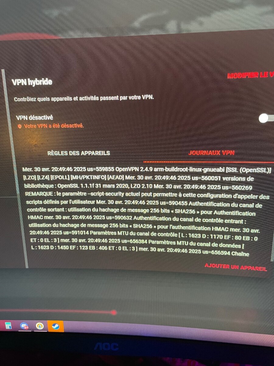

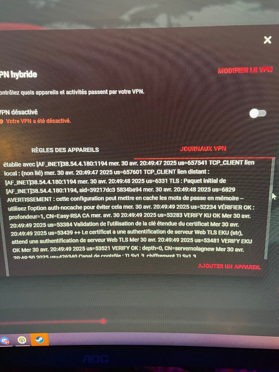

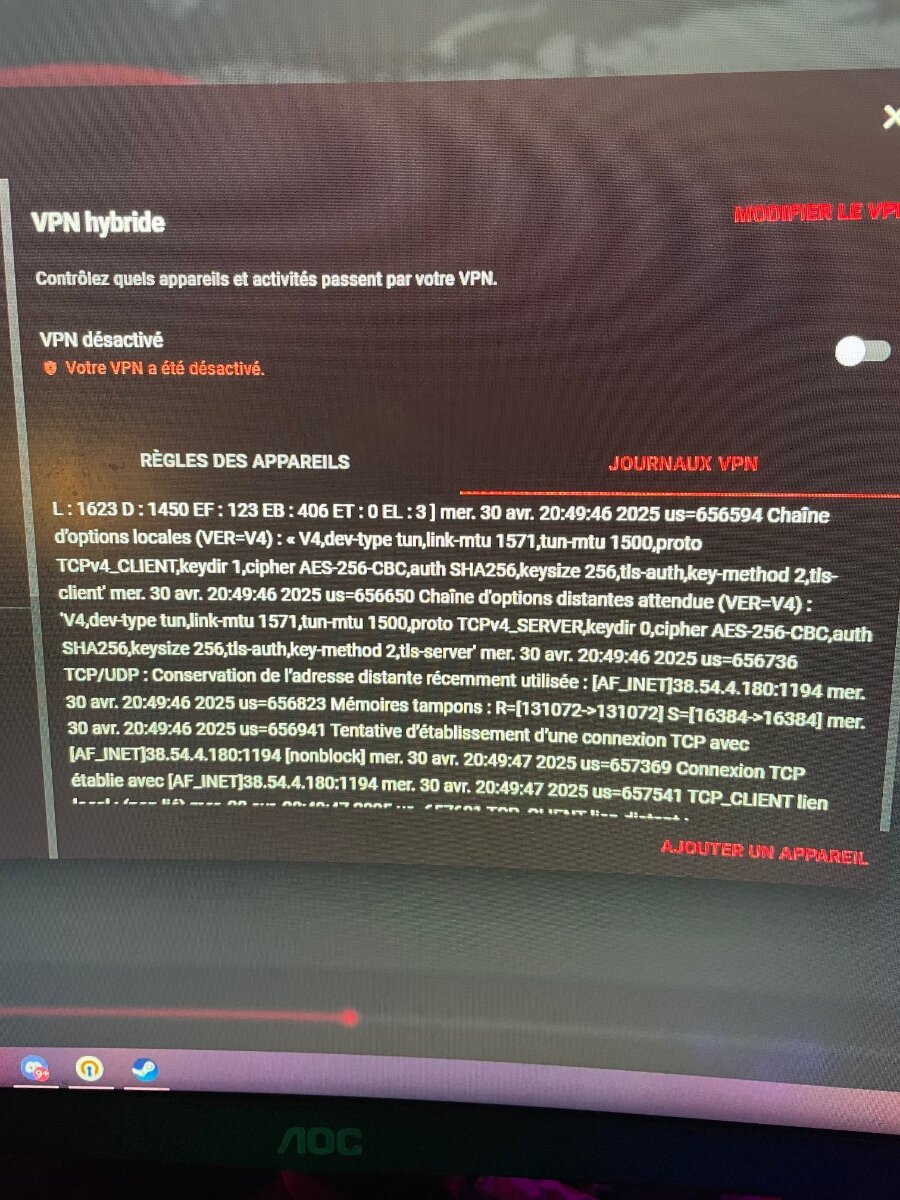

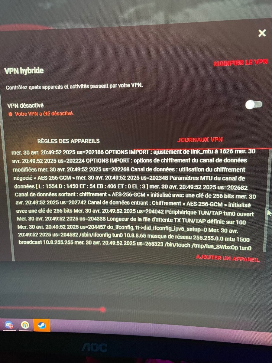

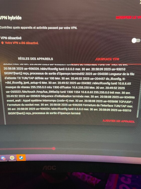

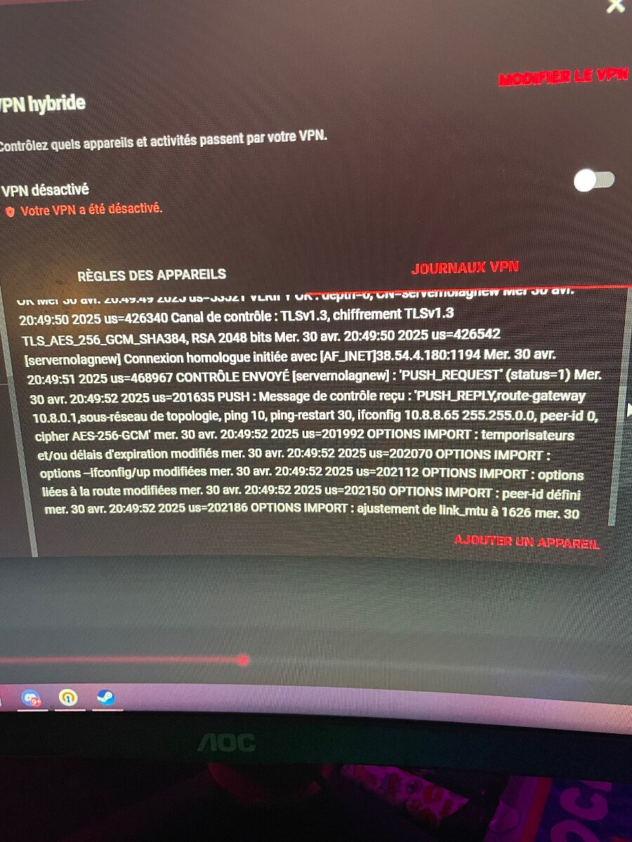

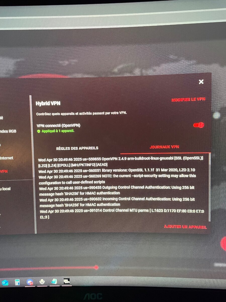

AizZeR Posted May 1 Share Posted May 1 i put in english, and when i activate i got this message. Wed Apr 30 20:49:46 2025 us=559855 OpenVPN 2.4.9 arm-buildroot-linux-gnueabi [SSL (OpenSSL)] [LZO] [LZ4] [EPOLL] [MH/PKTINFO] [AEAD] Wed Apr 30 20:49:46 2025 us=560051 library versions: OpenSSL 1.1.1f 31 Mar 2020, LZO 2.10 Wed Apr 30 20:49:46 2025 us=560269 NOTE: the current --script-security setting may allow this configuration to call user-defined scripts Wed Apr 30 20:49:46 2025 us=590455 Outgoing Control Channel Authentication: Using 256 bit message hash 'SHA256' for HMAC authentication Wed Apr 30 20:49:46 2025 us=590632 Incoming Control Channel Authentication: Using 256 bit message hash 'SHA256' for HMAC authentication Wed Apr 30 20:49:46 2025 us=591014 Control Channel MTU parms [ L:1623 D:1170 EF:80 EB:0 ET:0 EL:3 ] Wed Apr 30 20:49:46 2025 us=656384 Data Channel MTU parms [ L:1623 D:1450 EF:123 EB:406 ET:0 EL:3 ] Wed Apr 30 20:49:46 2025 us=656594 Local Options String (VER=V4): 'V4,dev-type tun,link-mtu 1571,tun-mtu 1500,proto TCPv4_CLIENT,keydir 1,cipher AES-256-CBC,auth SHA256,keysize 256,tls-auth,key-method 2,tls-client' Wed Apr 30 20:49:46 2025 us=656650 Expected Remote Options String (VER=V4): 'V4,dev-type tun,link-mtu 1571,tun-mtu 1500,proto TCPv4_SERVER,keydir 0,cipher AES-256-CBC,auth SHA256,keysize 256,tls-auth,key-method 2,tls-server' Wed Apr 30 20:49:46 2025 us=656736 TCP/UDP: Preserving recently used remote address: [AF_INET]38.54.4.180:1194 Wed Apr 30 20:49:46 2025 us=656823 Socket Buffers: R=[131072->131072] S=[16384->16384] Wed Apr 30 20:49:46 2025 us=656941 Attempting to establish TCP connection with [AF_INET]38.54.4.180:1194 [nonblock] Wed Apr 30 20:49:47 2025 us=657369 TCP connection established with [AF_INET]38.54.4.180:1194 Wed Apr 30 20:49:47 2025 us=657541 TCP_CLIENT link local: (not bound) Wed Apr 30 20:49:47 2025 us=657601 TCP_CLIENT link remote: [AF_INET]38.54.4.180:1194 Wed Apr 30 20:49:48 2025 us=6331 TLS: Initial packet from [AF_INET]38.54.4.180:1194, sid=39217dc3 5834ba94 Wed Apr 30 20:49:48 2025 us=6829 WARNING: this configuration may cache passwords in memory -- use the auth-nocache option to prevent this Wed Apr 30 20:49:49 2025 us=52234 VERIFY OK: depth=1, CN=Easy-RSA CA Wed Apr 30 20:49:49 2025 us=53283 VERIFY KU OK Wed Apr 30 20:49:49 2025 us=53384 Validating certificate extended key usage Wed Apr 30 20:49:49 2025 us=53439 ++ Certificate has EKU (str) TLS Web Server Authentication, expects TLS Web Server Authentication Wed Apr 30 20:49:49 2025 us=53481 VERIFY EKU OK Wed Apr 30 20:49:49 2025 us=53521 VERIFY OK: depth=0, CN=servernolagnew Wed Apr 30 20:49:50 2025 us=426340 Control Channel: TLSv1.3, cipher TLSv1.3 TLS_AES_256_GCM_SHA384, 2048 bit RSA Wed Apr 30 20:49:50 2025 us=426542 [servernolagnew] Peer Connection Initiated with [AF_INET]38.54.4.180:1194 Wed Apr 30 20:49:51 2025 us=468967 SENT CONTROL [servernolagnew]: 'PUSH_REQUEST' (status=1) Wed Apr 30 20:49:52 2025 us=201635 PUSH: Received control message: 'PUSH_REPLY,route-gateway 10.8.0.1,topology subnet,ping 10,ping-restart 30,ifconfig 10.8.8.65 255.255.0.0,peer-id 0,cipher AES-256-GCM' Wed Apr 30 20:49:52 2025 us=201992 OPTIONS IMPORT: timers and/or timeouts modified Wed Apr 30 20:49:52 2025 us=202070 OPTIONS IMPORT: --ifconfig/up options modified Wed Apr 30 20:49:52 2025 us=202112 OPTIONS IMPORT: route-related options modified Wed Apr 30 20:49:52 2025 us=202150 OPTIONS IMPORT: peer-id set Wed Apr 30 20:49:52 2025 us=202186 OPTIONS IMPORT: adjusting link_mtu to 1626 Wed Apr 30 20:49:52 2025 us=202224 OPTIONS IMPORT: data channel crypto options modified Wed Apr 30 20:49:52 2025 us=202268 Data Channel: using negotiated cipher 'AES-256-GCM' Wed Apr 30 20:49:52 2025 us=202348 Data Channel MTU parms [ L:1554 D:1450 EF:54 EB:406 ET:0 EL:3 ] Wed Apr 30 20:49:52 2025 us=202682 Outgoing Data Channel: Cipher 'AES-256-GCM' initialized with 256 bit key Wed Apr 30 20:49:52 2025 us=202742 Incoming Data Channel: Cipher 'AES-256-GCM' initialized with 256 bit key Wed Apr 30 20:49:52 2025 us=204042 TUN/TAP device tun0 opened Wed Apr 30 20:49:52 2025 us=204338 TUN/TAP TX queue length set to 100 Wed Apr 30 20:49:52 2025 us=204457 do_ifconfig, tt->did_ifconfig_ipv6_setup=0 Wed Apr 30 20:49:52 2025 us=204582 /sbin/ifconfig tun0 10.8.8.65 netmask 255.255.0.0 mtu 1500 broadcast 10.8.255.255 Wed Apr 30 20:49:52 2025 us=265323 /bin/touch /tmp/lua_SWbxOp tun0 1500 1554 10.8.8.65 255.255.0.0 init Wed Apr 30 20:49:52 2025 us=285820 Initialization Sequence Completed Wed Apr 30 20:58:08 2025 us=934996 event_wait : Interrupted system call (code=4) Wed Apr 30 20:58:08 2025 us=935698 TCP/UDP: Closing socket Wed Apr 30 20:58:08 2025 us=936205 Closing TUN/TAP interface Wed Apr 30 20:58:08 2025 us=936326 /sbin/ifconfig tun0 0.0.0.0 Wed Apr 30 20:58:09 2025 us=93010 SIGINT[hard,] received, process exiting Openvpn terminated Link to comment Share on other sites More sharing options...
Administrators Netduma Fraser Posted May 1 Administrators Share Posted May 1 Nothing bad there from what I can see - does it actually connect you to the VPN? Does it say connected? Link to comment Share on other sites More sharing options...
AizZeR Posted May 1 Share Posted May 1 yes it is Link to comment Share on other sites More sharing options...
Administrators Netduma Fraser Posted May 1 Administrators Share Posted May 1 Okay good - the server IP address you're using is Cambodia which may be the problem, find the IP of a server you want to connect to from the options they've given you (use a website to lookup the IP location) then use that instead and see if it works better Link to comment Share on other sites More sharing options...

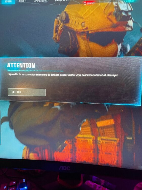

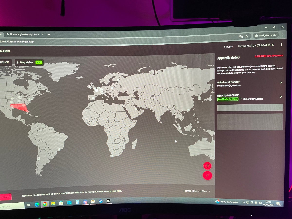

AizZeR Posted May 1 Share Posted May 1 I change for NY for playing in USA And that doing that IMG_2725.mov Link to comment Share on other sites More sharing options...
Administrators Netduma Fraser Posted May 1 Administrators Share Posted May 1 I can't view/download the video, what happens exactly? Link to comment Share on other sites More sharing options...
AizZeR Posted May 1 Share Posted May 1 I change for NY for playing in USA And that doing that Link to comment Share on other sites More sharing options...
AizZeR Posted May 1 Share Posted May 1 Try to find an host then inactiv.. try to find and inactiv and doing that again and again Link to comment Share on other sites More sharing options...

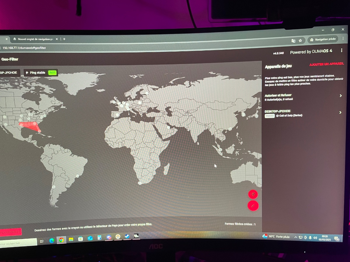

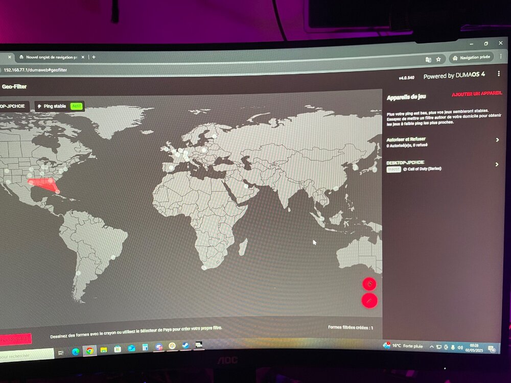

Administrators Netduma Fraser Posted May 2 Administrators Share Posted May 2 Do this: Quit the application/game/client completely Remove device from the Geo-Filter Give PC PlayStation Device Type in the Device Manager Resync from the Geo-Filter Map menu Re-add the device to the Geo-Filter Set up the Geo-Filter how you like Wait 2 minutes Boot up application/game/client Then try again please. Link to comment Share on other sites More sharing options...

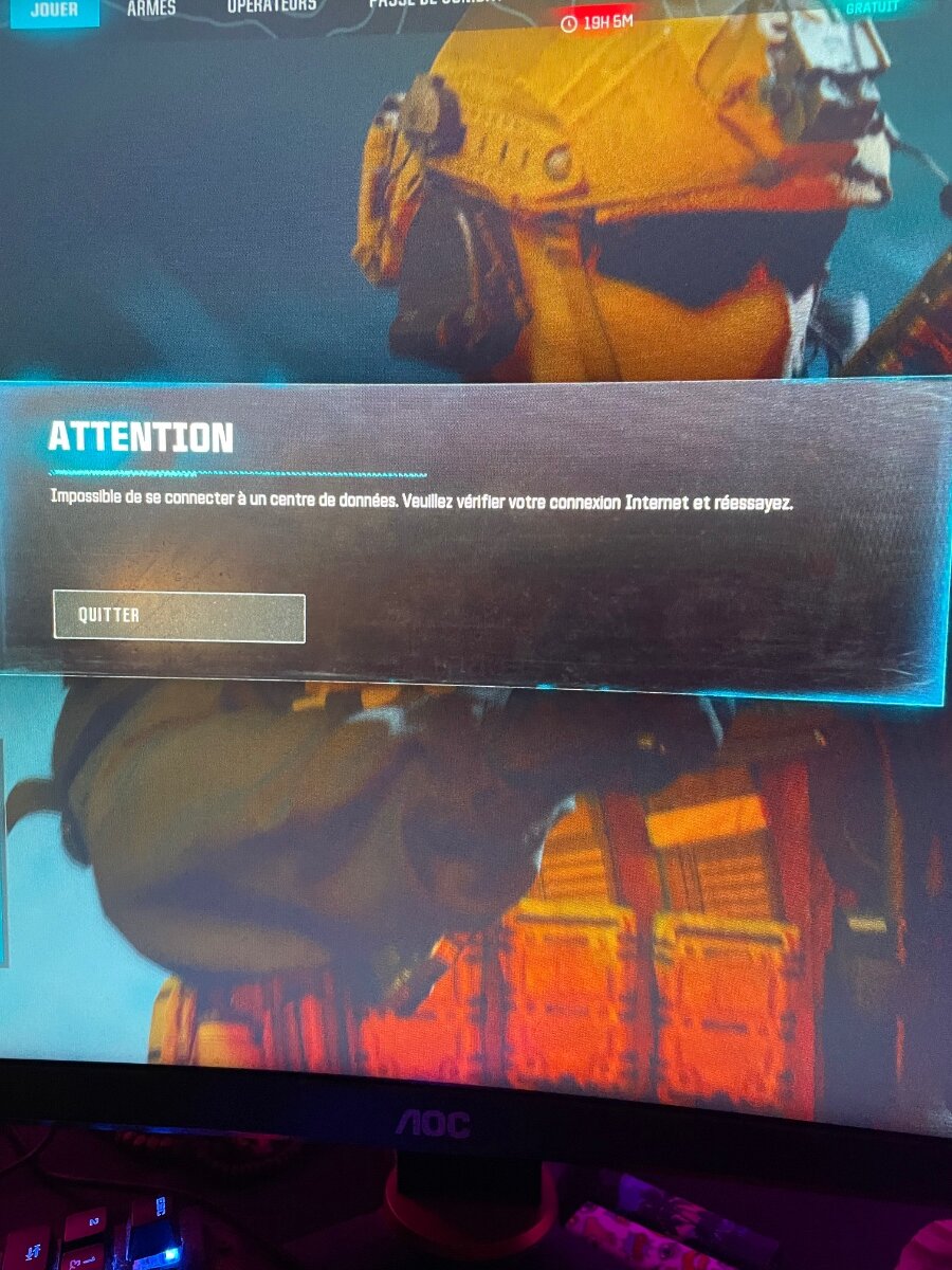

Jan4mba Posted May 2 Author Share Posted May 2 1 hour ago, Netduma Fraser said: Do this: Quit the application/game/client completely Remove device from the Geo-Filter Give PC PlayStation Device Type in the Device Manager Resync from the Geo-Filter Map menu Re-add the device to the Geo-Filter Set up the Geo-Filter how you like Wait 2 minutes Boot up application/game/client Then try again please. It doesn’t work. NolagVpN sent me email look : Thanks for reaching out and I totally understand your frustration. Let’s try to fix this so you can get the most out of your NoLagVPN subscription with your NetDuma R3 setup. We don’t officially support routers, but some users have successfully used NoLagVPN through the Hybrid VPN feature of NetDuma. Just in case you haven’t seen it yet, here's the guide we provide for NetDuma routers: https://nolagvpn.com/faq/install-on-capable-netduma-router Now, regarding the error message “no connection, please fix your internet connection” this usually means there’s an issue with how the VPN is set up on the router or how traffic is being routed through Hybrid VPN. Since you’re getting this after importing our config file, please double-check the following: 1. Make sure you're entering username and password both as 1 (just like in our tutorial). 2. Ensure you’re using UDP as the protocol (not TCP). 3. Only your console or PC should be routed through the Hybrid VPN, not the whole network. Try selecting just that device in the Hybrid VPN settings. 4. Try a different server location from your dashboard. Sometimes a specific config might not play nice with your setup. Ghana, India, Kenya, or Cambodia are all good ones to test. Link to comment Share on other sites More sharing options...

Administrators Netduma Fraser Posted May 2 Administrators Share Posted May 2 17 minutes ago, Jan4mba said: No because I don’t know which ports UDP I have to use for Warzone They mean change the protocol in the VPN config from TCP to UDP Link to comment Share on other sites More sharing options...
AizZeR Posted May 2 Share Posted May 2 can you use teamviewer ? and u maybe can try to fix it from my PC ? we can find an hour for doing that eachother ? Link to comment Share on other sites More sharing options...
Administrators Netduma Fraser Posted May 2 Administrators Share Posted May 2 On 4/29/2025 at 8:17 AM, AizZeR said: We don't provide that kind of support. Where it says proto tcp above just change to proto udp Link to comment Share on other sites More sharing options...

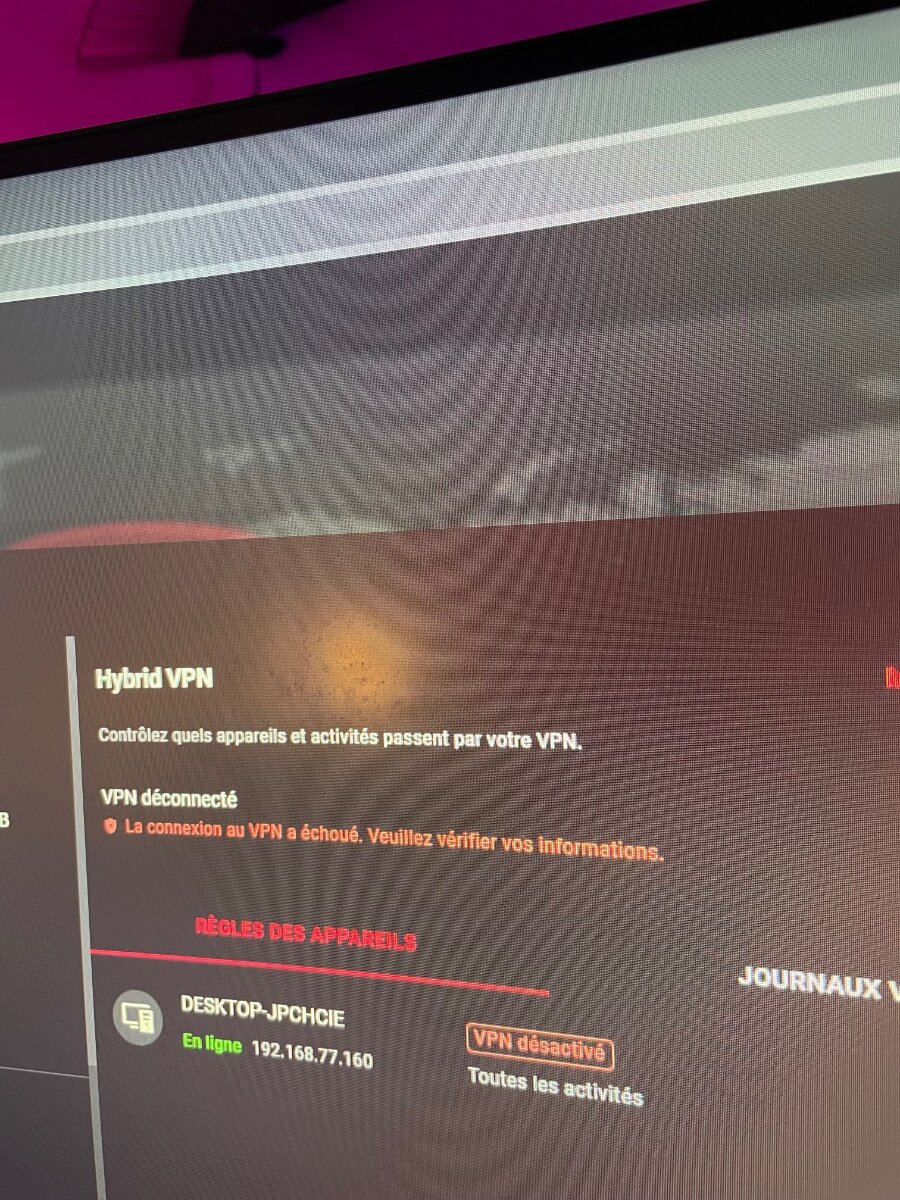

Jan4mba Posted May 2 Author Share Posted May 2 3 hours ago, Netduma Fraser said: They mean change the protocol in the VPN config from TCP to UDP ok but ... where i have to change that? Link to comment Share on other sites More sharing options...
AizZeR Posted May 2 Share Posted May 2 « Connection failed, try to Check your information » when i change to udp i got this message.. Link to comment Share on other sites More sharing options...
Administrators Netduma Fraser Posted May 2 Administrators Share Posted May 2 1 hour ago, Jan4mba said: ok but ... where i have to change that? In your config file you pasted into HybridVPN. 1 hour ago, AizZeR said: « Connection failed, try to Check your information » when i change to udp i got this message.. This is getting quite confusing supporting two people in the same topic, I'd suggest making a new topic so we can focus on you there. You don't need to change to UDP you needed to follow these steps, did you follow them?: 8 hours ago, Netduma Fraser said: Do this: Quit the application/game/client completely Remove device from the Geo-Filter Give PC PlayStation Device Type in the Device Manager Resync from the Geo-Filter Map menu Re-add the device to the Geo-Filter Set up the Geo-Filter how you like Wait 2 minutes Boot up application/game/client Then try again please. Link to comment Share on other sites More sharing options...
