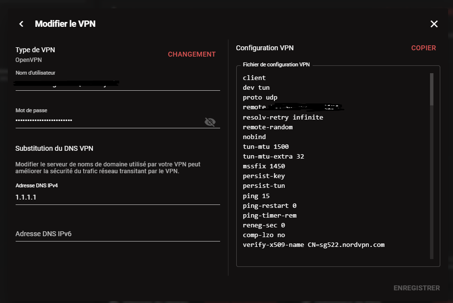

Ultrax92 Posted April 8 Posted April 8 Hello, I'm having an issue using the hybrid VPN with the Netduma R3. I'm using NordVPN, and with my previous router, I used an access token and the connection worked perfectly. However, now I'm constantly getting an error in games saying "the host is not responding." I’ve double-checked that I entered the correct username and password, and I copied and pasted the contents of the .ovpn file directly from the NordVPN website.

Administrators Netduma Fraser Posted April 8 Administrators Posted April 8 I wouldn't suggest using 1.1.1.1 for DNS, remove that and try it again. You don't need to use the VPN & Geo-Filter to force a server, just the Geo-Filter would do. You're trying to filter encrypted traffic essentially so there is no guarantees there, that's why we don't suggest using a VPN when playing, that and the increased ping.
Ultrax92 Posted April 8 Author Posted April 8 I don’t use the VPN for gaming — I need to geolocate myself elsewhere for other purposes, regardless of the ping. I don’t use the Geo-Filter with the VPN; I use them separately. But even then, I still appear to be located where I actually live. Regarding the 1.1.1.1 address, it was set automatically — I didn’t configure anything related to it.
Administrators Netduma Fraser Posted April 8 Administrators Posted April 8 What is the model of the modem/router the R3 is connected to and how have you set that to ensure all traffic flows to the R3? E.g R3 in its DMZ, modem/bridge mode Are ALL devices connected to the R3? So VPN enabled for the console but Geo-Filter disabled? How have you done the VPN rule exactly? Remove the 1.1.1.1 DNS anyway
Ultrax92 Posted April 8 Author Posted April 8 The R3 is directly connected to my internet box via Ethernet cable. I removed the 1.1.1.1 DNS. All devices are connected to the R3 through an RJ45 hub (I also tried using Wi-Fi, but that didn’t work either). I tried two methods: using only the VPN, and using only the Geo-Filter.

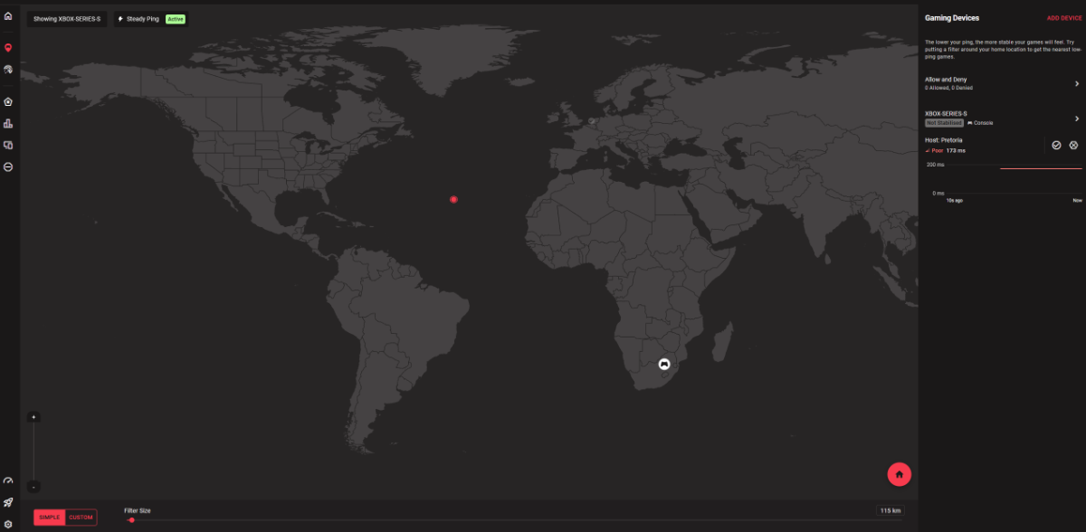

Administrators Netduma Fraser Posted April 8 Administrators Posted April 8 Just to clarify, you're getting the same error with both the VPN on its own and the Geo-Filter on its own? Does that then mean that with the Geo-Filter disabled you're not getting the same error? The internet box do you mean just a simple box on the wall (ONT) or an ISP router provided by your ISP? You're using a switch for wired connections is that right? Just trying to understand the overall setup. Assuming you are getting the issue with the Geo-Filter enabled but not without, please provide a screenshot of the Geo-Filter page when you see the error happen. Do you see anything blocked outside your radius when it happens? What firmware version are you on currently?

Ultrax92 Posted April 24 Author Posted April 24 J'ai essayer plusieur VPN, plusieurs localisation et moi mon PB n'est pas que je ne peut pas lancer ca me met une erreur l'hote ne repond pas et ca relance une recherche de parti jusqu'a des fois en lancer une ~45min-1h et des fois ca ne trouve jamais. J'ai voulu utiliser Geo filter a la place cependant impossible car peut importe ou je me localise il ne me localise pas ou j'ai mis le cercle il reste sur la localisation initial, je redemarre tout ca fonctione 1 game et ensuite ca repart c'est impossible. Cependant j'utilise le client nord vpn avec un router TP-link a la place vu que le R3 ne fonctionne pas et peut importe ou je me localise tout fonctionne.
Krush Posted April 24 Posted April 24 Tu es chez quel FAI ? Offre Le TP Link te sert a quoi a l’origine ? Router un client VPN vers tes consoles ? Comment vérifies tu la localisation avec le TP-Link ? Tu pourrais faire une capture du geofiltre quand ça arrive ?
Ultrax92 Posted April 24 Author Posted April 24 Free Il sert a utiliser mes console avec un vpn avec un client VPN (NORD VPN) mais sur le R3 ca fonctionne pas. Sur le jeux directmement dans info reseaux. Je n'ai pas rebrancher le R3 encore vu que ca ne fontionne pas, exemple pour decrire, Geofilter (afrique du sud) Cela fonctionne une game en ZA, fin de la game recherche de parti et la seul les serveur Francais sallume en blanc vu qu'il essaye de se connecter dessus pourtant hors du cercle et que juste avant il venais de se connecter en ZA. Pour qu'il se reconnecte en ZA je doit tout eteindre et tout realumer, des fois ca repart en ZA des fois non. il y a vraiment un probleme.
Krush Posted April 24 Posted April 24 Le serveur que tu vois, c’est peut-être le serveur d’authentification, c’est pourquoi je te demandais une capture. Tu VPN en Afrique du Sud ? Tu as quoi comme ping ? Si plus de 200ms c’est peut être la raison pour laquelle le geofiltre est perdu et que la recherche n’aboutit pas …
Administrators Netduma Fraser Posted April 24 Administrators Posted April 24 Being able to see a screenshot or video of what you see on the Geo-Filter when it happens will make it much easier for us to see what is happening and help guide you in the right direction Krush 1
