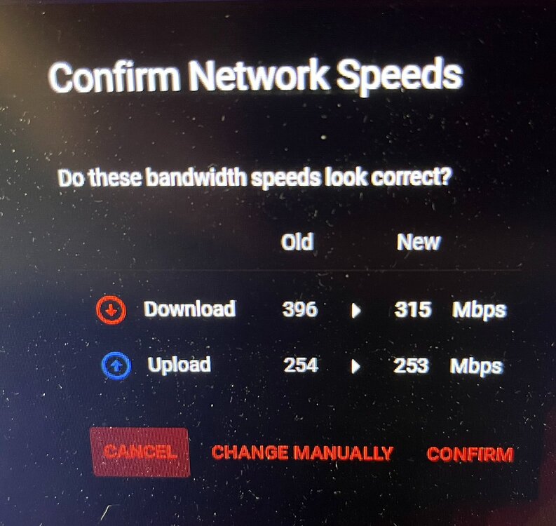

Wantox81 Posted April 8 Share Posted April 8 Hello everyone, I have had a speed test problem for several days now: if I do the speed test from the R2's (3.3.280) internal utility I get: - 335mbps down et 255mbps up. If I do the speed test on Ookla I get the correct speeds from my provider: - 500mbps down and 250mbps up I have also tried doing a factory reset and reconfiguring everything, but the problem remains, how can I solve it? Thank you Link to comment Share on other sites More sharing options...
Administrators Netduma Fraser Posted April 8 Administrators Share Posted April 8 It's just the test server being used, it won't always report as accurately but as you can see the router isn't limiting you so just go off speedtest.net Link to comment Share on other sites More sharing options...
Wantox81 Posted April 8 Author Share Posted April 8 6 minutes ago, Netduma Fraser said: It's just the test server being used, it won't always report as accurately but as you can see the router isn't limiting you so just go off speedtest.net Thank you for you reply so can I manually enter 500mbs down in the R2? Have I any problems with QoS? other thing: in the geofilter, with the app, when I connect to a game server it no longer pings me, it says: could not ping host, why? Link to comment Share on other sites More sharing options...
Administrators Netduma Fraser Posted April 8 Administrators Share Posted April 8 Yes that's correct, it won't cause any issues with QoS. Game servers don't respond to traditional pings so we try to be clever in order to get a successful ping but it doesn't always work. It will then try to fall back to the trace method which won't give you the correct ping in most cases but hopefully somewhere near it, however this can also fail. Wantox81 1 Link to comment Share on other sites More sharing options...
