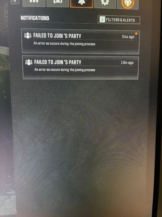

BLT Posted April 7, 2025 Posted April 7, 2025 I'm connecting through an ethernet cable connected to a Deco mesh system, as the main router is upstairs & running a 100ft ethernet cable is no longer a possibility. I've always had the ping map show myself on the map as a peer symbol, but recently on Black Ops 6, I've been getting an error notification that basically says I can't join the party, even though I'm searching for a match. When I check whose party it's trying to join, it's me & my own network. So basically, as it searches for games, it has been seeing my own network as a party to join. I've manually denied it multiple times, hoping that would stop the issue, but it still happens, & both auto-ping & manual show that it's the connection I've denied, because I obviously named it before denying it. I'm using a static IP for my PC & for the xr1000, & I've tried letting the ISP select the DNS server, used the 1.1.1.1 Cloudfare DNS, the 8.8.8.8 Google DNS servers, but the error persists. I have gone through the process of factory resetting the xr1000 & going through the entire setup process at least 5 times, but it continues to happen. I am able to get into lobbies, but about 50% of the time that I'm searching for matches, I get the error instead, & it starts the searching process all over, so I'm only actually playing the game about half the time that I should be, due to the "can't connect to party" error. Is there anything that I can do to prevent this from happening? I've tried getting the IP addresses dynamically through the ISP option with no success, as well as creating static IPs for the network & PC, turning on IPV6 & having that setup properly, but nothing seems to work. I just want to be able to play matches normally, & not wasting half of the searches for a match, because it results in this error. It doesn't happen when I connect the PC directly to the Mesh device, but then I lose the Geo-Filter & all DumaOS capabilities, which is why I got the router to begin with. I even submitted a report a few days ago, by hitting report instead of allow or deny, but haven't heard back & don't want it to block my outgoing searches for matches. As you can see in the images, I've denied my network & named it ME (at the bottom of the allow/deny list), but I keep on showing up as the peer symbol instead of a blocked peer, which leads to the issue continuing. Krush 1

BLT Posted April 22, 2025 Author Posted April 22, 2025 I tried all the suggested options, & even have my xr1000 in the DMZ of the primary router, but it still happens. In fact, it literally just happened about 2 minutes ago, here are picture of what's happening. After adding more approved servers to my list, it doesn't happen half the time like it did before, but maybe 20% of the time, & almost always after a match finishes & it's searching for a new one.
BLT Posted April 22, 2025 Author Posted April 22, 2025 Maybe I spoke too soon, it happened the very next search. I'm having to back all the out & select multiplayer each time, now.

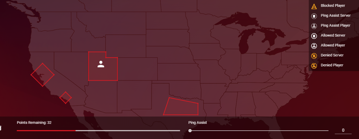

Administrators Netduma Fraser Posted April 22, 2025 Administrators Posted April 22, 2025 Can you provide a full uncropped screenshot of your Geo-Filter page showing what you see when this happens please - if possible
BLT Posted April 22, 2025 Author Posted April 22, 2025 The part taken out of Utah is where I'm located, so it doesn't show up, but I still get SLC servers.
Administrators Netduma Fraser Posted April 22, 2025 Administrators Posted April 22, 2025 If you use the radius mode and cover a few more servers, just say the entire West coast do you get the same issues?
BLT Posted April 22, 2025 Author Posted April 22, 2025 Yeah, that's why I switched to polygon mode. LA servers are fast, but lots of jackets, so I got rid of that box. I did start with the circle covering the west l entire West coast to start with, though, & it did the same thing.
