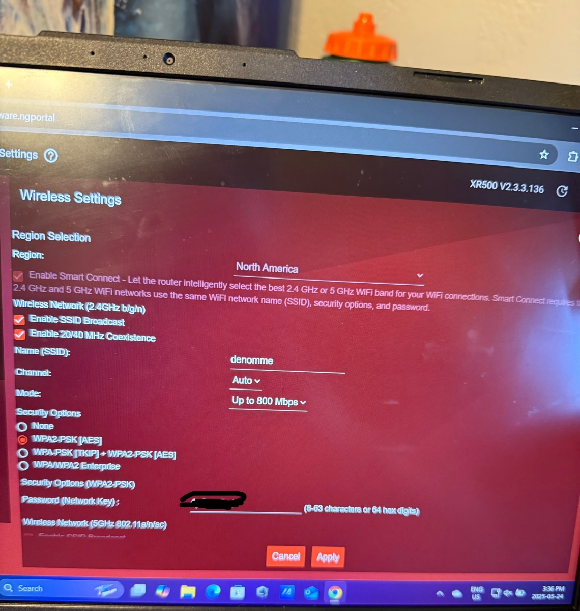

rjaaayyy Posted May 19, 2025 Author Posted May 19, 2025 it is enabled, but its grayed out and i cant toggle it off. Its saying in the game, while playing it will kick me out and show, must have active network connection to play online matches. Even though the router never loses internet.
Administrators Netduma Fraser Posted May 19, 2025 Administrators Posted May 19, 2025 That's very bizarre, could you provide a screenshot of the WiFi page please? If you disable the Geo-Filter do you still get kicked?
Administrators Netduma Fraser Posted May 25, 2025 Administrators Posted May 25, 2025 Thanks, that looks fine, could you downgrade back to https://forum.netduma.com/topic/51611-new-xr500-beta-firmware-33535/ and see if it works better then please? If so make sure to disable auto update in Settings > Administration > Firmware Update
