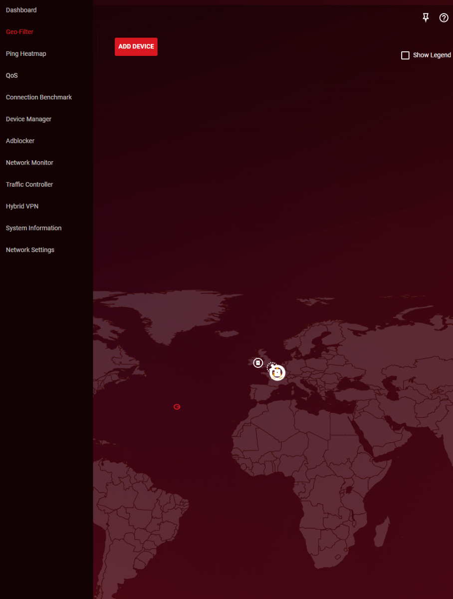

FabXi Posted August 31 Posted August 31 Good morning, I can confirm what Infoseye says. I downgraded to version 2.1.3.29, and Netduma r1 works fine without any issues. I'm attaching a screenshot of the geofilter. I'm Italian, and the best server I can connect to is the Milan server. With this version, I can connect without any issues, and I can selectively connect only to it. Thanks, Infoseye, for your help. Infoseye 1
Administrators Netduma Fraser Posted August 31 Administrators Posted August 31 8 hours ago, FabXi said: Good morning, I can confirm what Infoseye says. I downgraded to version 2.1.3.29, and Netduma r1 works fine without any issues. I'm attaching a screenshot of the geofilter. I'm Italian, and the best server I can connect to is the Milan server. With this version, I can connect without any issues, and I can selectively connect only to it. Thanks, Infoseye, for your help. Thanks for confirming, I will let the team know!
