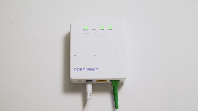

Glynn_A Posted September 22, 2022 Author Posted September 22, 2022 5 hours ago, Netduma Fraser said: Did you disable QoS fully from the Congestion Control menu ? Did that make any difference? What is the model of the modem/router the XR is connected to? Yes, it was disabled fully and it's not connected to a modem, it's connected to fttp so it's a socket on the wall, the bt one
