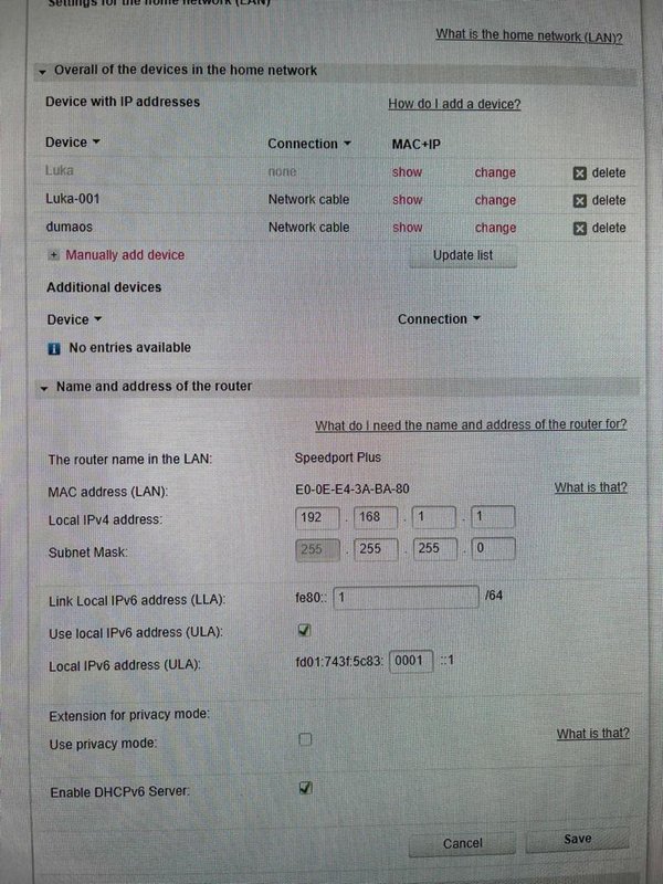

Luka007 Posted April 2, 2021 Author Share Posted April 2, 2021 Im now in device manager... and shows only my pc connected with wlan...there is oprion to manually add device Link to comment Share on other sites More sharing options...
Luka007 Posted April 2, 2021 Author Share Posted April 2, 2021 And yes here it is show when refreshed list Link to comment Share on other sites More sharing options...
Luka007 Posted April 2, 2021 Author Share Posted April 2, 2021 when it is connected near router then all ligths are working edit: when its connected near modem i cant acces in duma os or via 192.xxxxxx Link to comment Share on other sites More sharing options...
Administrators Netduma Fraser Posted April 2, 2021 Administrators Share Posted April 2, 2021 Okay great so add that IP address as a reserved/static IP on that interface, then reboot the R2 and it should get a connection Link to comment Share on other sites More sharing options...
