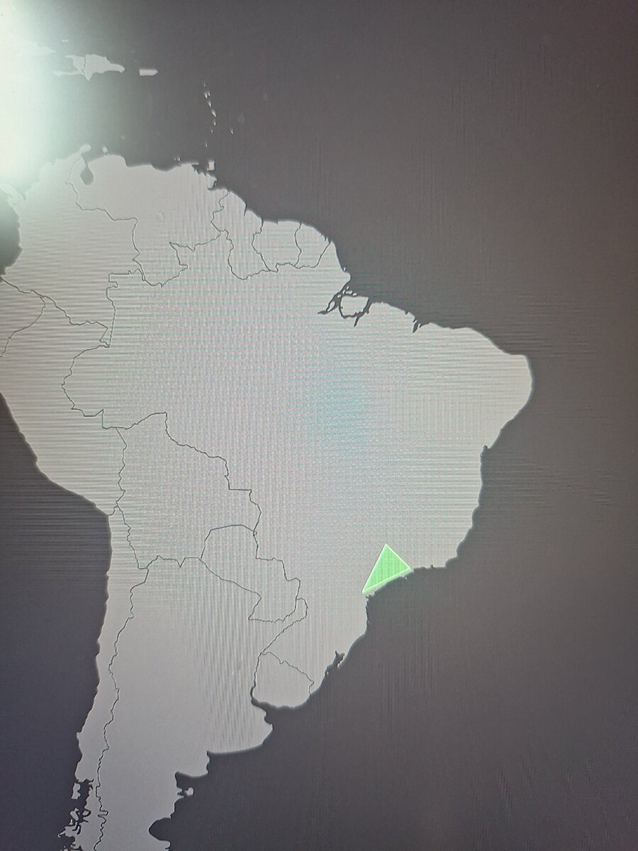

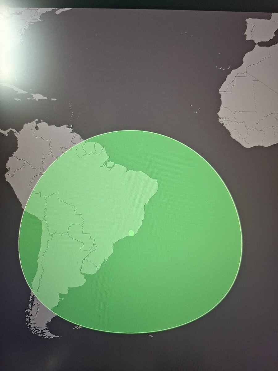

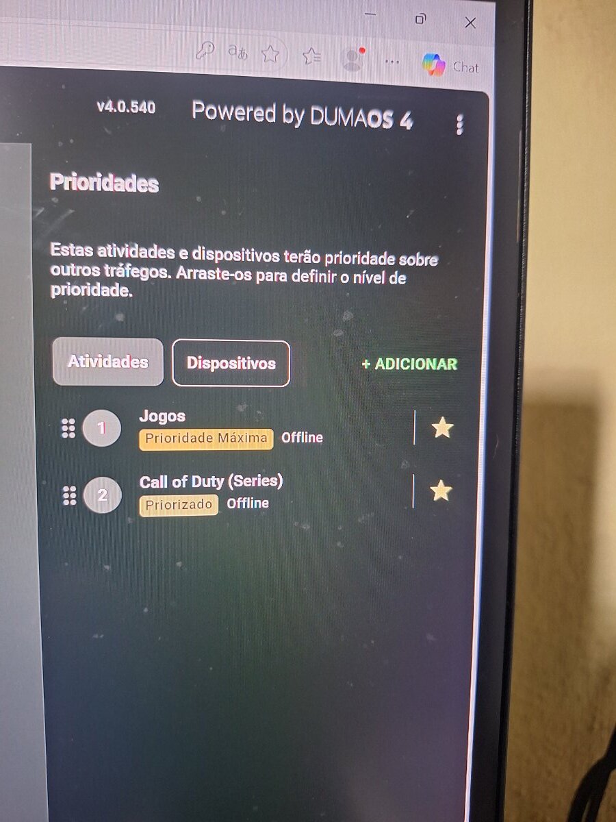

Rodolfo Lima Posted 7 hours ago Posted 7 hours ago In the screenshot I sent below, what is the difference between the two? And regarding SmartBoost for Call of Duty, do I need to enable both of these?
Administrators Netduma Fraser Posted 6 hours ago Administrators Posted 6 hours ago One is a generic circle radius system based on distance from the centre/home point you select, the other you can draw your selected zone that you want servers to be allowed within. That's the only difference between them, otherwise they work exactly the same. You only need to prioritize one or the other, gaming would be my suggestion and prioritize your device as a backup prioritization method.
