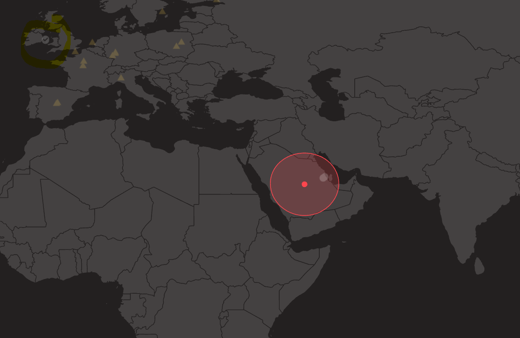

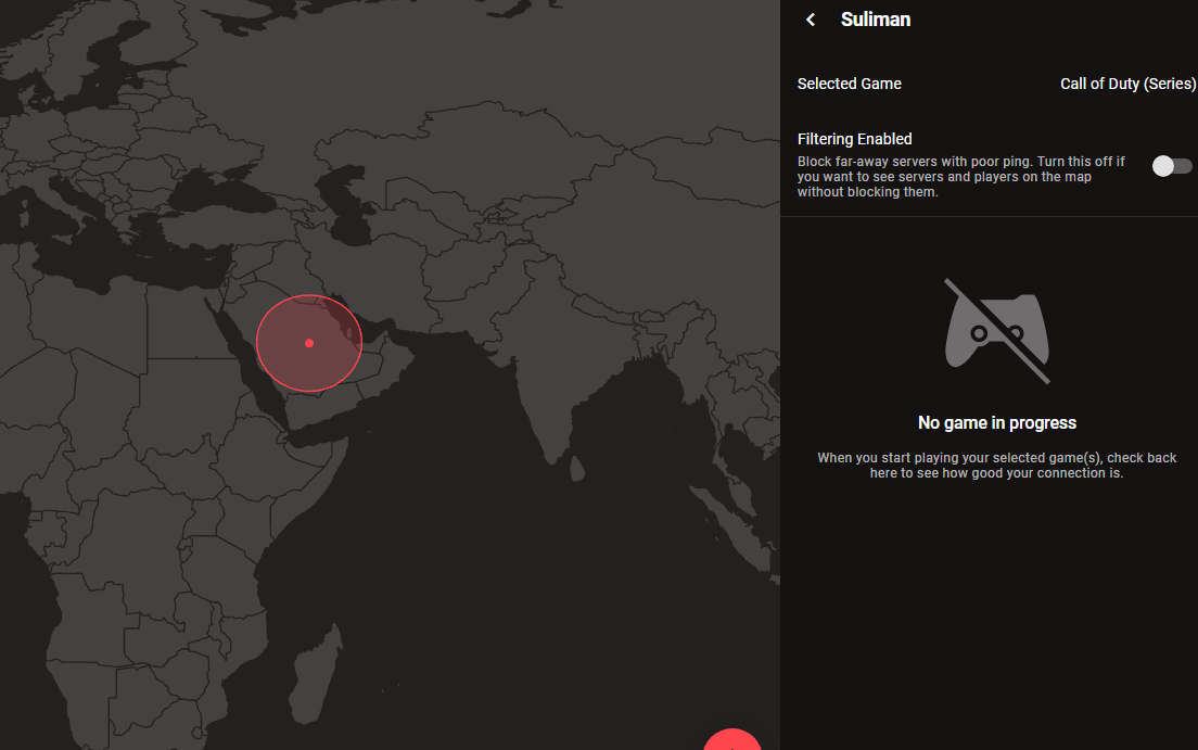

Suliman Posted February 14 Posted February 14 When I select Filtering enabled in setting, it does not let me log in in BO7, I must turn this off to be able to log to the game, help
Administrators Netduma Fraser Posted February 14 Administrators Posted February 14 Do this: Quit the application/game/client completely - including the game client from the System Tray - important! Remove device from the Geo-Filter Give your PC the PlayStation Device Type in the Device Manager Resync from the Geo-Filter Map menu Re-add the device to the Geo-Filter Set up the Geo-Filter how you like Wait 2 minutes Boot up application/game/client Then try again please
Suliman Posted February 15 Author Posted February 15 Thanks Fraser, this worked, however, I think I still need to connect to dublin, while I am in riyadh. I will test it but I dont want to connect to outside my range Riydh,
Administrators Netduma Fraser Posted February 15 Administrators Posted February 15 20 minutes ago, Suliman said: Thanks Fraser, this worked, however, I think I still need to connect to dublin, while I am in riyadh. I will test it but I dont want to connect to outside my range Riydh, Good to hear! Yes that's correct, the server(s) in Ireland are authentication servers, you can't play without them
