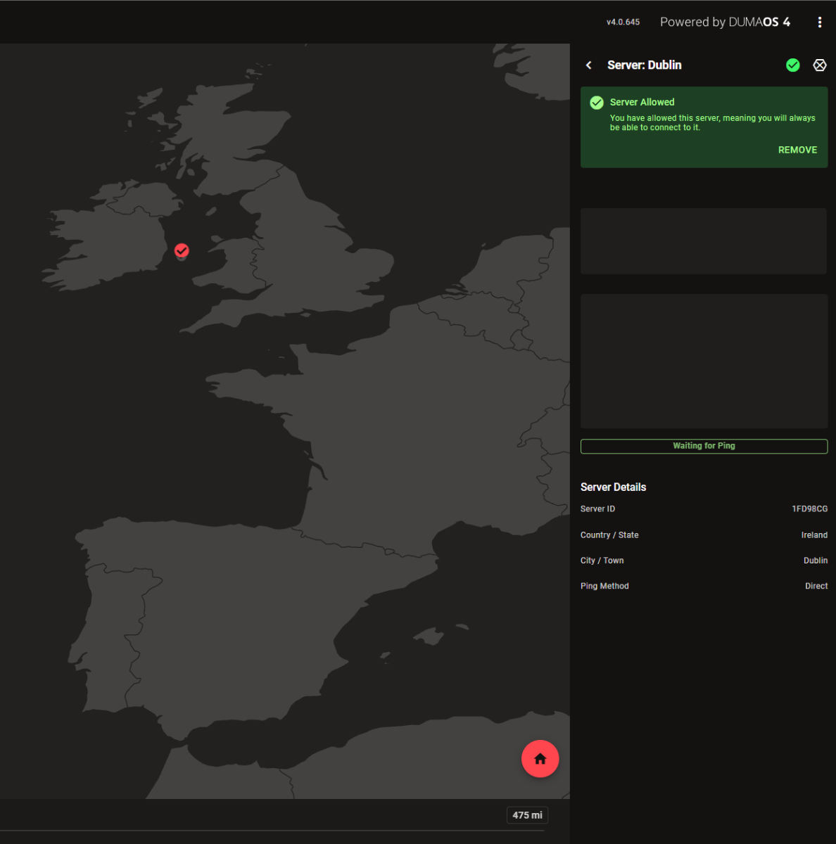

qwerty0776 Posted February 15 Posted February 15 Appreciate all the support. To clarify i did add them over a week ago. Just need to emphasize that up until it stopped working weeks ago, i have never had to do that. I just set the filter area and that was it. It just worked. Now i did add them manually reset the router, re add the pc etc. it starts with searching game like 80ms ping, goes to over 170 then finds a local game. Also, looking at the interface, the servers dont always light up. Its something that might need to be seen as is hard to explain. Thanks!
Administrators Netduma Fraser Posted February 15 Administrators Posted February 15 1 hour ago, qwerty0776 said: Appreciate all the support. To clarify i did add them over a week ago. Just need to emphasize that up until it stopped working weeks ago, i have never had to do that. I just set the filter area and that was it. It just worked. Now i did add them manually reset the router, re add the pc etc. it starts with searching game like 80ms ping, goes to over 170 then finds a local game. Also, looking at the interface, the servers dont always light up. Its something that might need to be seen as is hard to explain. Thanks! They change servers every so often so what you experienced can happen, we then whitelist and it'll happen again at a future date, always a bit of cat and mouse really! Though you have prompted an idea that might help with this so I've relayed that to the team. You'll only see servers in a few different circumstances, with some games such as CoD you may see all servers, apart from those within your radius when you first launch the game. Then when you search you may see servers outside your radius being blocked. Then when you're in the game you should only see the game server you're playing on and potentially the auth server. qwerty0776 1

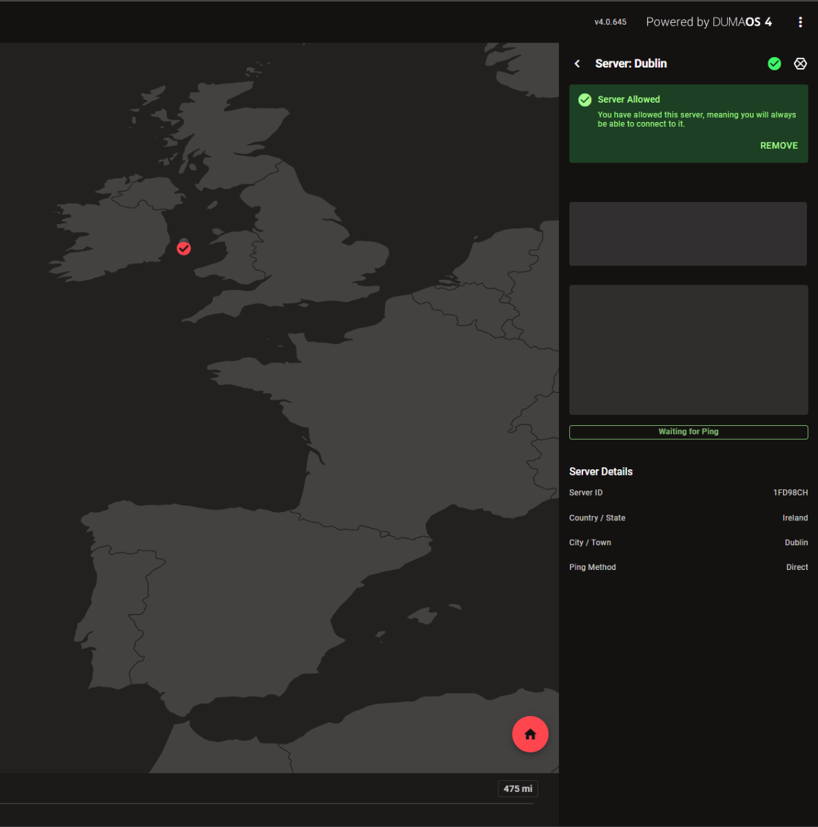

Administrators Netduma Fraser Posted February 28 Administrators Posted February 28 The first ID is a US server so we can correct that - it's also likely why you've been able to connect to it even though its mislocated. You've definitely disabled Geo-Latency in Geo-Filter settings? The second should be in Ireland so that is likely an auth server you need to allow.Ā
qwerty0776 Posted February 28 Posted February 28 5 minutes ago, Netduma Fraser said: The first ID is a US server so we can correct that - it's also likely why you've been able to connect to it even though its mislocated. You've definitely disabled Geo-Latency in Geo-Filter settings? The second should be in Ireland so that is likely an auth server you need to allow.Ā But if i was connected to it my ping cant be like 20ms. When it worked i was around 82-90 ms. And obviously no french people in the lobby. Yes is disabledĀ

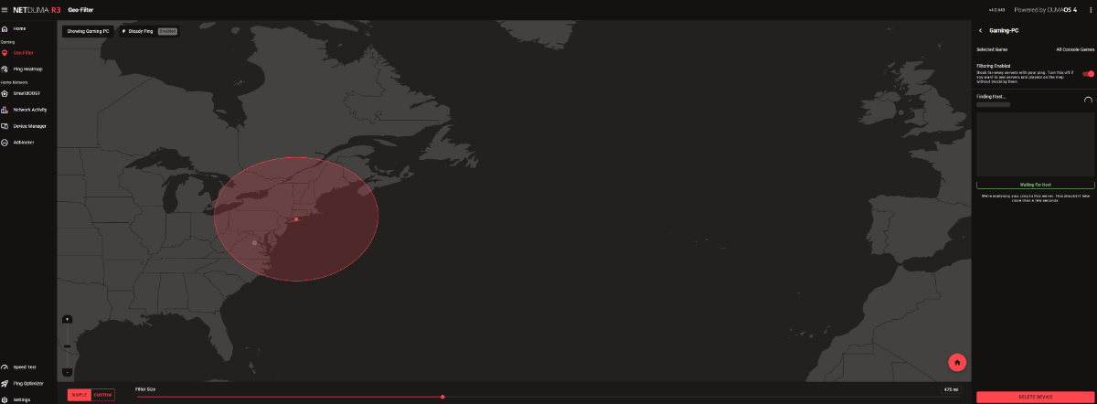

Administrators Netduma Fraser Posted February 28 Administrators Posted February 28 You've switched it back to a PC there with the CoD service, that's why everything is seemingly allowed, switch it back to the way it was before. What settings have you changed from their defaults?
qwerty0776 Posted February 28 Posted February 28 So it was always pc. I only changed it to PS from the post above. Everything else is default. I fully reset the router this am. Will try and reconfigure it when home. Is there anything specific that needs to be done as i have never messed with the settings it was just set the geofilter and done. Ot worked

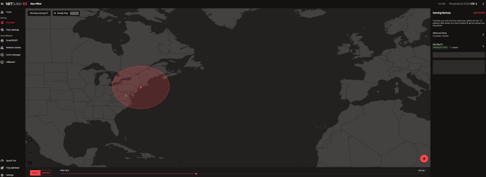

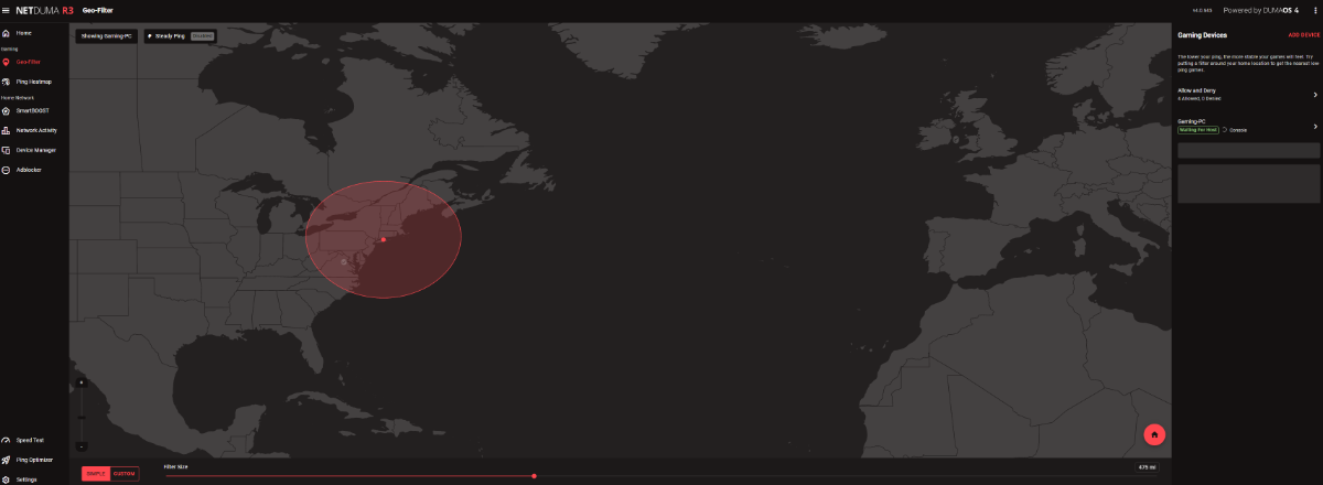

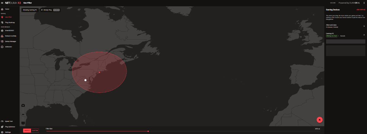

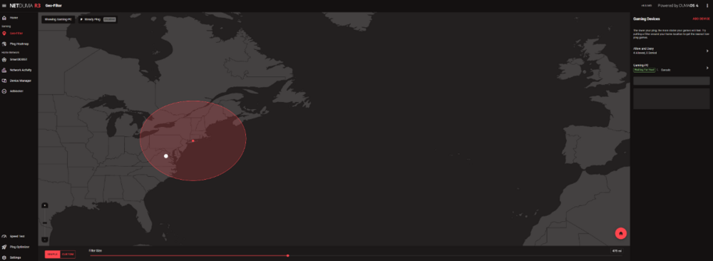

qwerty0776 Posted February 28 Posted February 28 fresh setup- is attempting to connect for about 10 mins now. Geo latency off, filtering enabled 2nd pic
Administrators Netduma Fraser Posted February 28 Administrators Posted February 28 No nothing else specifically. Okay that's good, it's preventing you getting into a game outside properly. Now you're running into what can happen which is increased search times when forcing servers further away. Depending on when you play the game may also be less lenient about allowing you in.
