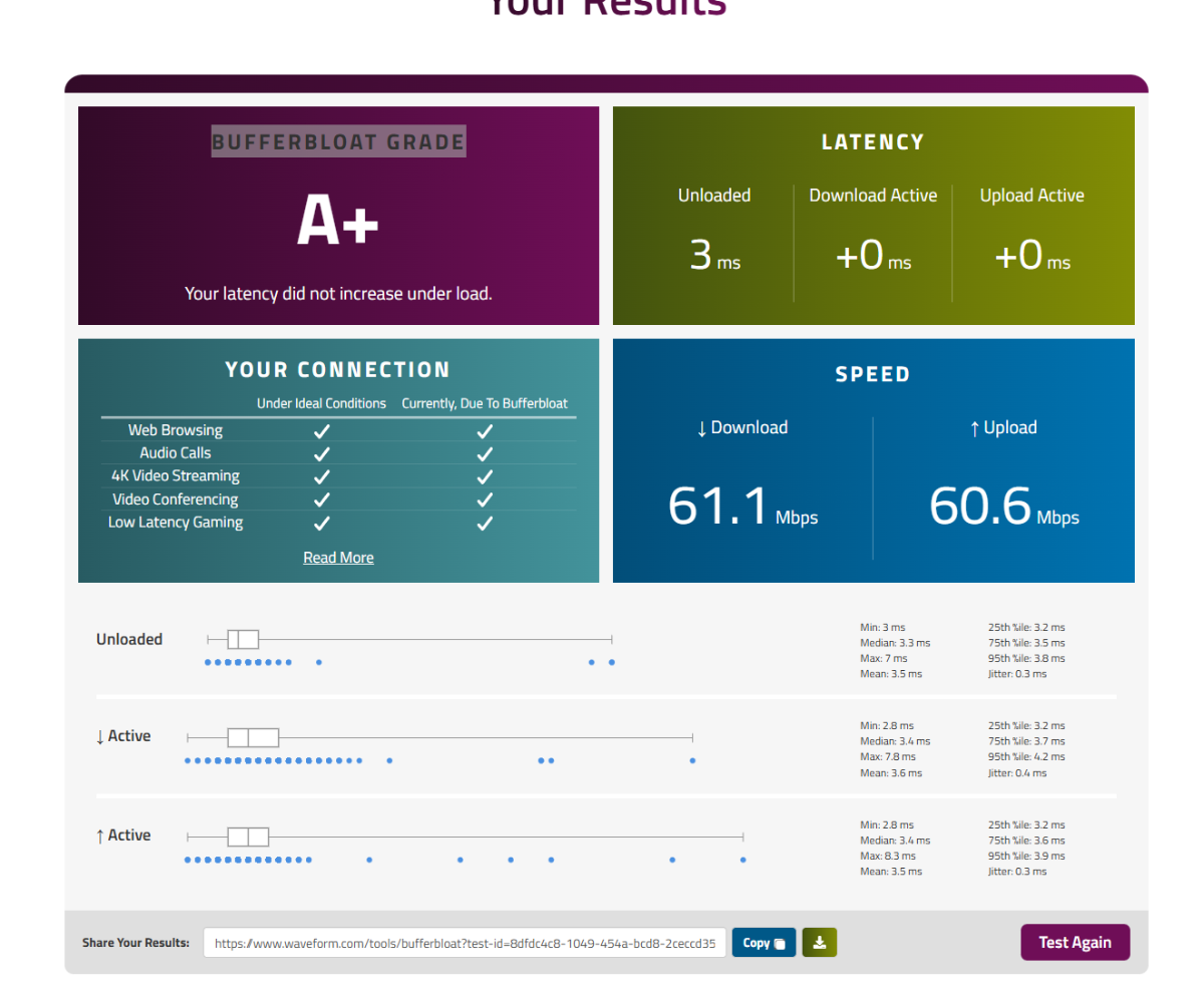

x3- Posted January 12 Posted January 12 when running the buffer bloat, should the speed test by pass be off? With the setting off I get extremely high latency spikes in the test . I'm playing mostly cod bo7 in-game the is latency 3ms and still get ghost bullets is there anyways of optimizing that? I only games so just need the most stable latency possible. down/up speed: 100mbps firmware: v4.0.236 when using the newest version even the beta, my connection to pc keeps disconnecting every couple of minutes making it imposable to play.
Administrators Netduma Fraser Posted January 12 Administrators Posted January 12 Bypass should be off yes - based on your screenshots, are you certain the issue is when bypass is off? As your speeds should show reduced when the option is off as it will be reflecting your Congestion Control percentages and that's the test you have the better results on which would make sense. The other way around wouldn't make much sense. What is the Geo-Filter showing as your ping to the game as it's very unlikely you'd be getting 3ms to the game server - there is really no improving that low a ping if it is the case and you'd need to focus more on ensuring that ping is actually a stable 3ms and potentially finding servers that play better even if they have a slightly higher ping
