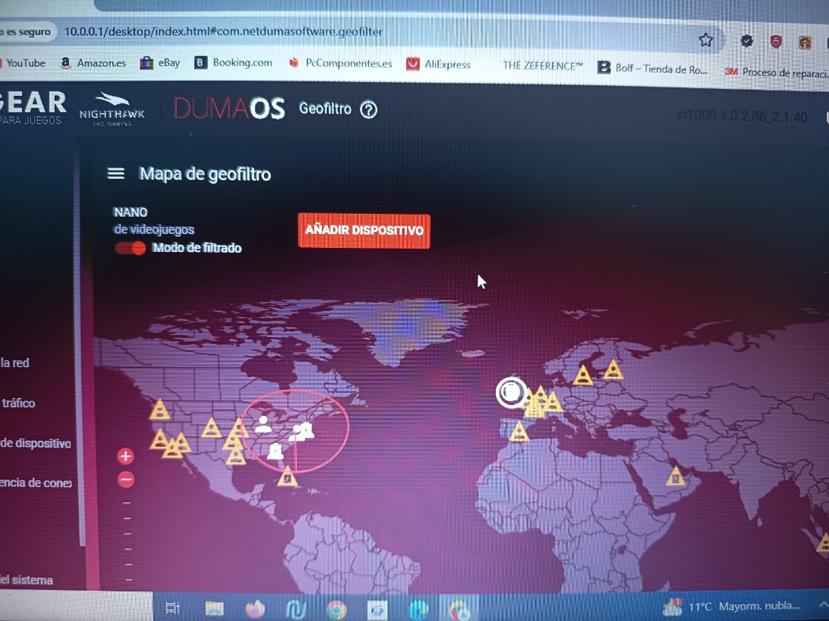

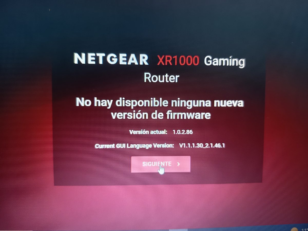

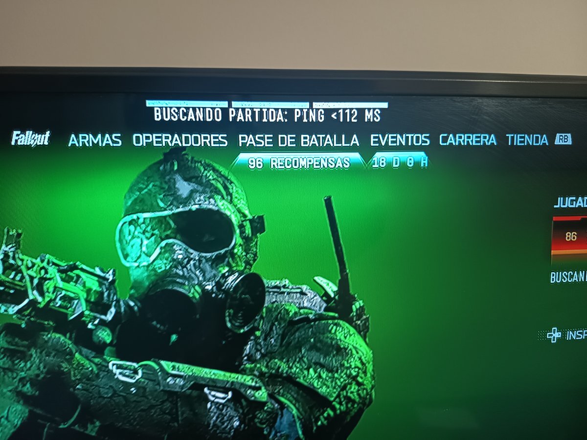

Nanu Posted January 10 Posted January 10 Hola a todos. Desde que instalé la ultima versión del xr1000 no me deja jugar en EEUU. Vivo en España y lo que más me atrajo de este router nigthawk xr1000 es que podías seleccionar cualquier zona geografíca y jugar allí. Alguna recomendación de porque ahora no se puede elegir ubicaciones de juego.

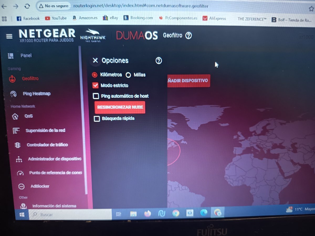

Administrators Netduma Fraser Posted January 10 Administrators Posted January 10 What game are you playing? What platform are you playing on and how is it connected, via ethernet or WiFi? How have you setup the Geo-Filter? Can you provide a screenshot?

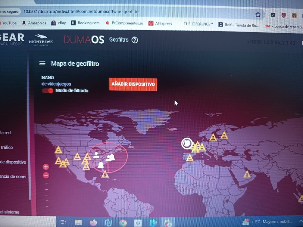

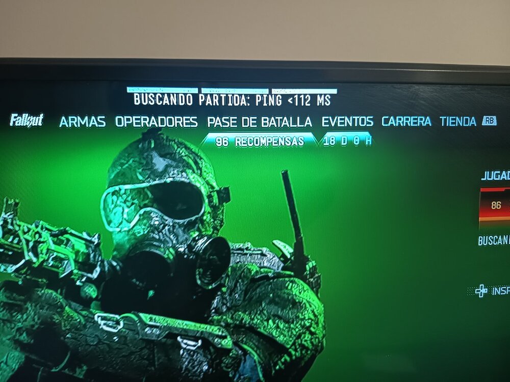

Nanu Posted January 11 Author Posted January 11 Hola Fraser. Plataforma de juego Xbox Series. Call of Duty BOP 7. No encuentra sala en esa localización, se mete automáticamente en servidores cercanos a España. He intentado añadir servidores de EE.UU y tampoco se une a ellos. Gracias por revisar este caso, un saludo.
Administrators Netduma Fraser Posted January 11 Administrators Posted January 11 You've set the Geo-Filter up correctly and it does appear to be blocking servers outside your radius. If it's really not wanting to put you in the game then we can't force it. It could be due to a ping limit, they did implement this in the Ricochet Anti-Cheat which presumably they're using an updated version of now with the same feature: https://www.callofduty.com/patchnotes/2024/11/call-of-duty-bo6-warzone-season-01-patch-notes so that could be why. Do you have any issues getting games closer to home with the Geo-Filter?
